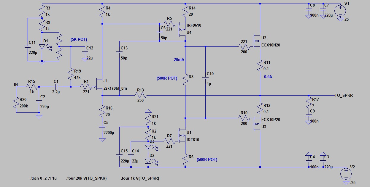

JFET input, MOSFET VAS, LATERAL output = Perfect!!
I like the idea of running a .wav file through the simulator, but I doubt it will be accurate since there is not real-time thermal simulation, unless manually implemented. And even then it can only be crude unless you create a discrete version of the component model with added support.
- keantoken
With +/-50 Volt supply.
Two pair HEXFET IRFP240/9240 and cascoded JFETs.
IRF610/9610 for VAS.
100 Watt into 8 Ohm with low distortion.
Hello LineUp!
I want to follow this scheme because I now have all the parts fit this scheme. JFETs 2SK170BL except that I do not have, but I have 2SK30A JFETs can I change K30A K170 with it?
I like this circuit! because it matches the speakers have low sensitivity and 4 ohm impedance only for me.
if I need to change any component or value in this circuit?
and then the circuit has good activity and stability after change it JFETs ?
Thank you much!

Taking it to the next level...200kHz
Hi all,
Well the long weekend is here and I've been playing around again.
I have taken fetzilla to new levels, though not with any particularly innovative modifications, just a little tweaking.
Please see attached schematic and oscillogram.
I have added:
1) An LED + FET based VAS CCS - simpler, faster and more latch up resistant thn the BJT verson.
2) A little miller compensation.
3) Reduced VAS degeneration. to increase OLG.
4) Increased global feedback.
5) Increased feedback capacitor.
6) Added extra filtering for LED voltage sources, after careful modelling.

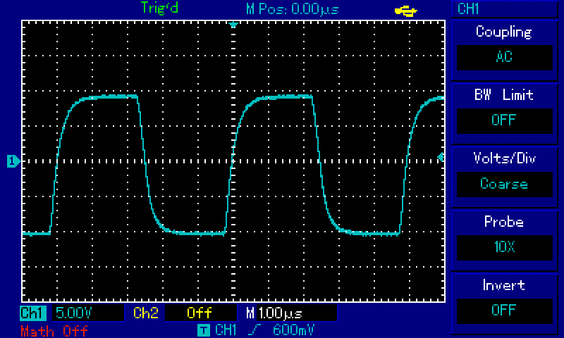

The result? The most stable, cleanest and fastest fetzilla yet.
Can it do a 20kHz square wave? Stuff that, let's try 200kHz shall we?
DC offset is the most stable of all the designs I've built so far too, though I'm yet to investigate turn on thump....
Did I mention it sounds pretty good too?

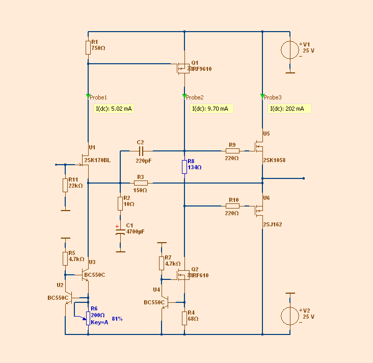

Here is a typical Fetzilla circuit for minimal harmonics distortion:

Your square wave is exceptional for 200KHz, and shows the exact profile of a single ended voltage amplification stage.
I feel your miller compensation could be reduce just a smidgin, perhaps to 36pF. This is important to sound quality, BTW.

There are countless, numerous ways to complicate an amplifier.
Until you have 20, 50 or 100 transistors.
Fetzilla uses 4 Transistors.
And 2 current sources with a couple of more. And supply trafo 2x18VAC

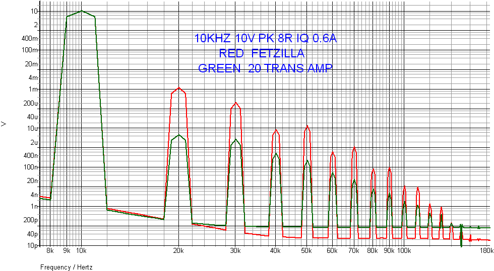

That s 8 transistors...
A grand total of 20 is way enough to improve the perfs by quite a big margin
while cost would not be much higher.
