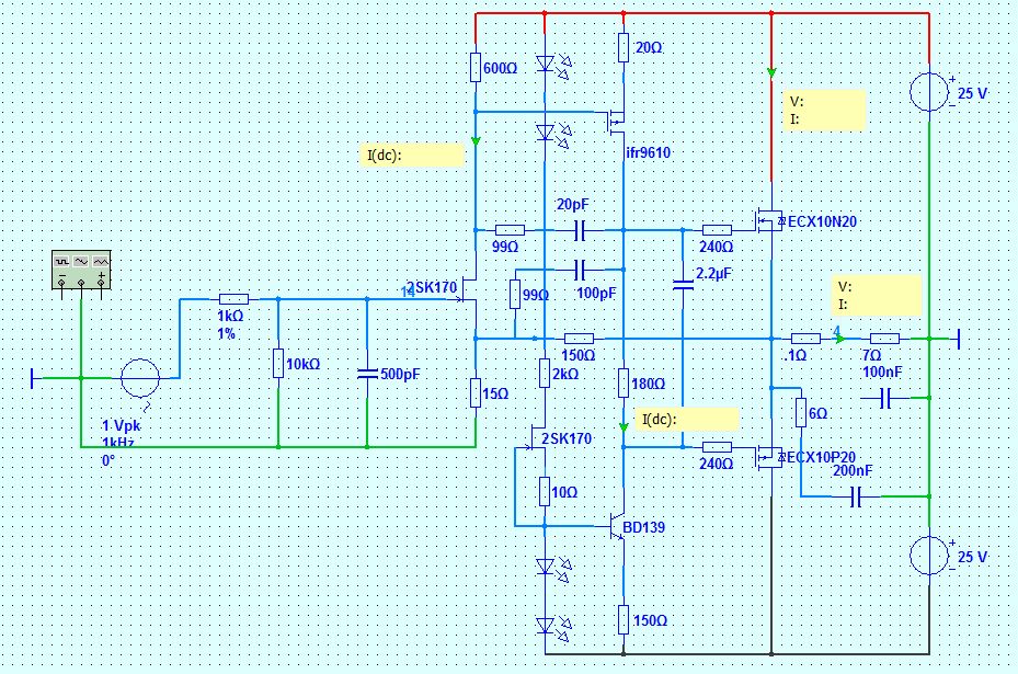

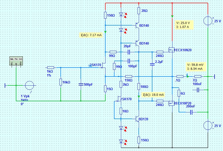

progress report
I am building boards using blank vero board, pins & copper wire, one finished the other 1/2 done, these will be great for experimentation but are a labour of love to build. Have to test & match some components now. As you can see I'm not rushing but should have one working cct in a few days.
The number of versions bouncing around here is enough to make a potential builder giddy but initially I'm interested to two versions only and I thought I would see what the experts think about how they compare theoretically. They differ only in VAS. 1) irf9610 2) casoded bd140s
Earlier in the thread a BJT VAS was discarded due to lack of OLG ( about 75dB ) but if a cascode is added the gain increases to almost 100dB which is flat to about 1Khz which with my CLG target of 20 - 24 dB should be plenty of FB.
Many here have stated that they prefer a BJT for VAS and I think the cascode makes it a viable contender.
In simulation I saw advantages in keeping the VAS current high so I'm begining with 20mA. I would be interested in alernative device suggestions.
My new PC scope arrived today which is great but I can tell you that building when all your usual parts, tools & testing gear are on a boat on the Atlantic is quite a challenge !
Version 1
I left the LEDs in for convenience

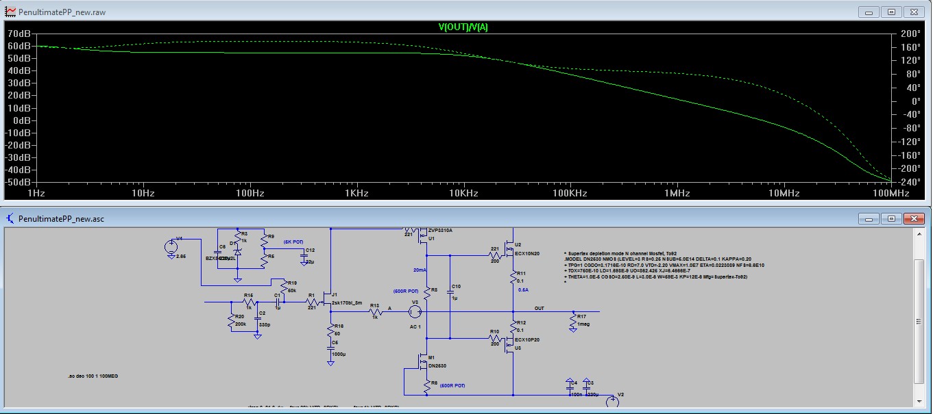

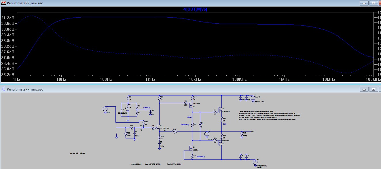

Can someone please explain to me how to test stability with spice? I have run an ac analysis on my circuit and get a nice decrease at HF on the ouput node. The only place I see an increase is at the gate to the VAS, which I assume is bad?
I have also tried a square wave with 10us on, 20uS period and rise and fall times of 10nS. I can not get the thing to oscillate in simulation - Sonnya, what am I doing wrong?
SWF,
Set input siggen to 0V input.
Insert AC voltage source between output and the series fb resistor. Set AC voltage to 1 on the LTSpice right side of the dialogue box. (Left side should be left at zero).
Right of the AC voltage source is Vout; label left of the voltage source Vb by right clicking on the line input to the voltage source.
Select Functions NONE and AC Amplitude 1 (to the upper right) after right clicking on the AC voltage source.
Choose Edit Simulation Command, and then select AC Analysis.
Specify a frequency range from 10Hz to 20MHz. This covers the areas of interest of all audio amplifiers.
Now, run the simulation.
Right click the empty plot to add a trace. Insert the following function: -Vout/Vb
You will then see a plot of loop gain (OLG/CLG) for the frequencies selected. This is Middlebrook Analysis. On a typical amp you will see loop gain start to drop from the dominant pole, around 2Khz or so. At the point where the loop gain has dropped exactly 3dB, this is a 45 degree phase shift, and gives the dominant pole (lower). This value is significant as it tells you exactly where the loop gain starts to reduce with increasing frequency. It would be nice to have this frequency above the audio band, but it almost never is.
Now, look at the broken line, which represents phase shift of the -Vout/Vb function. At the point where phase shift is exactly 180 degrees displaced, we have negative feedback changing abruptly into positive feedback. Normally this phenomenon leads to destructive oscillation. At this exact point, trace the gain from the curve. It should be well below 0dB loop gain. If this is so, the amp is stable.
A useful refinement is to examine the phase margin at the point where loop gain is 0dB. Phase margin is the safety factor; it is 180 minus the precise phase shift at that point. If the phase shift is, for example, 100 degrees at loop gain of 0dB, then phase margin is 80 degrees, which is pretty good. However, to reduce your phase margin, push the limits by placing a parallel cap across the 8R resistive load on the amplifier. The worst cap I've found for testing phase margin is 100nF.
On my amp, the NAKSA, 0dB loop gain occurs at 545KHz, with 85 degrees of phase margin. Dominant pole is at 23.5KHz.
Hope this explains it,
Hugh
Hugh,
Thanks again, how's this one? Found an example in the examples folder of lt spice!
Not entirely sure what this is actually doing. Might be a good topic next time we speak on the phone!
P.S. don't pay too much attention to the actual schematic. I'm just trying to get the stability testing sorted. The vas is actually at 10mA.
