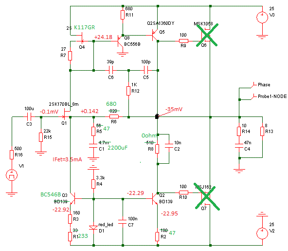

Circuit comments
Oh - that look's very tasty SWF!
I would look at the gate stopper VAS resistor of 221 ohms though...
It will limit the open loop bandwidth of the VAS.
Better to apply cap(s) on R4 (2n2?) for a pole or R14 for extension. R14 of 50 Ohms might be a bit high as well? Should be able to go down to about 20 Ohms?
A little Source degeneration of the input Fet perhaps? just 10 Ohms or so?
Should help at bit with the DC and 1st stage linearity issues...
ohh and Output filter? 47n with 10ohms/2w (min) should do the trick...😎

Hugh,
Thanks again, how's this one? Found an example in the examples folder of lt spice!
Not entirely sure what this is actually doing. Might be a good topic next time we speak on the phone!
P.S. don't pay too much attention to the actual schematic. I'm just trying to get the stability testing sorted. The vas is actually at 10mA.

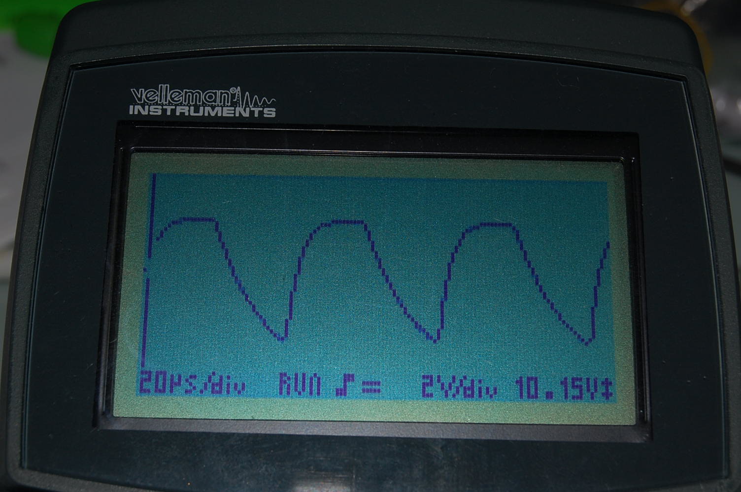

Result with lineup rec version
I have done some more experiment with lineup's recommended version with BJT VAS:
Pic 1 - the Green is the value that I used, Red is the actual reading,
Pic 2 - bOth rise time & fall time were poor.
Test result with lineup's ultimate version + Wahab's TMC
I have done some more experiment with lineup's ultimate version + Wahab's TMC mod:
Pic 2 - rise time improved a lot & fall time was still poor.
The input square wave was 12kHz, the addition of Q4 (2SK117GR) improved the rise time a lot. I did not notice any difference with the TMC & darlington VAS.
I will build SWF's BJT version.

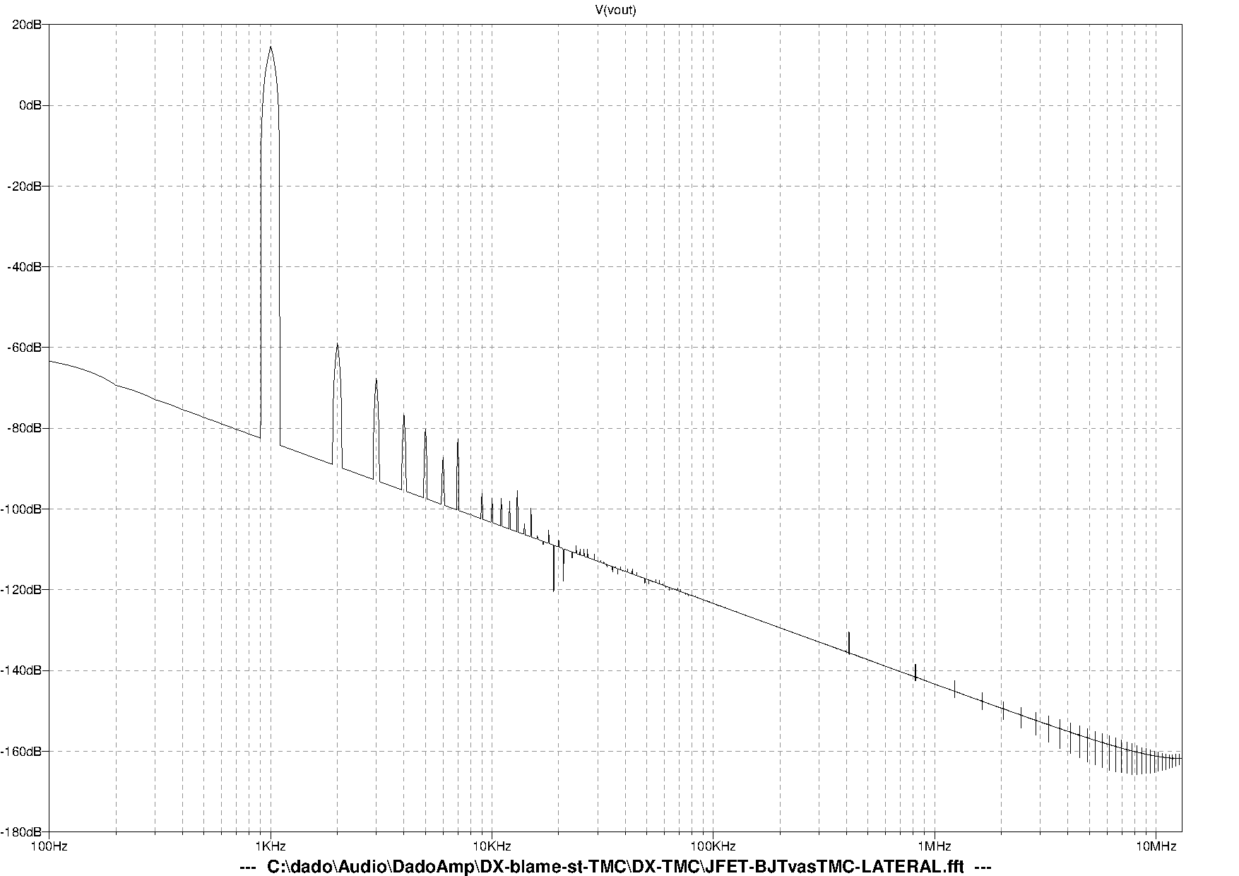

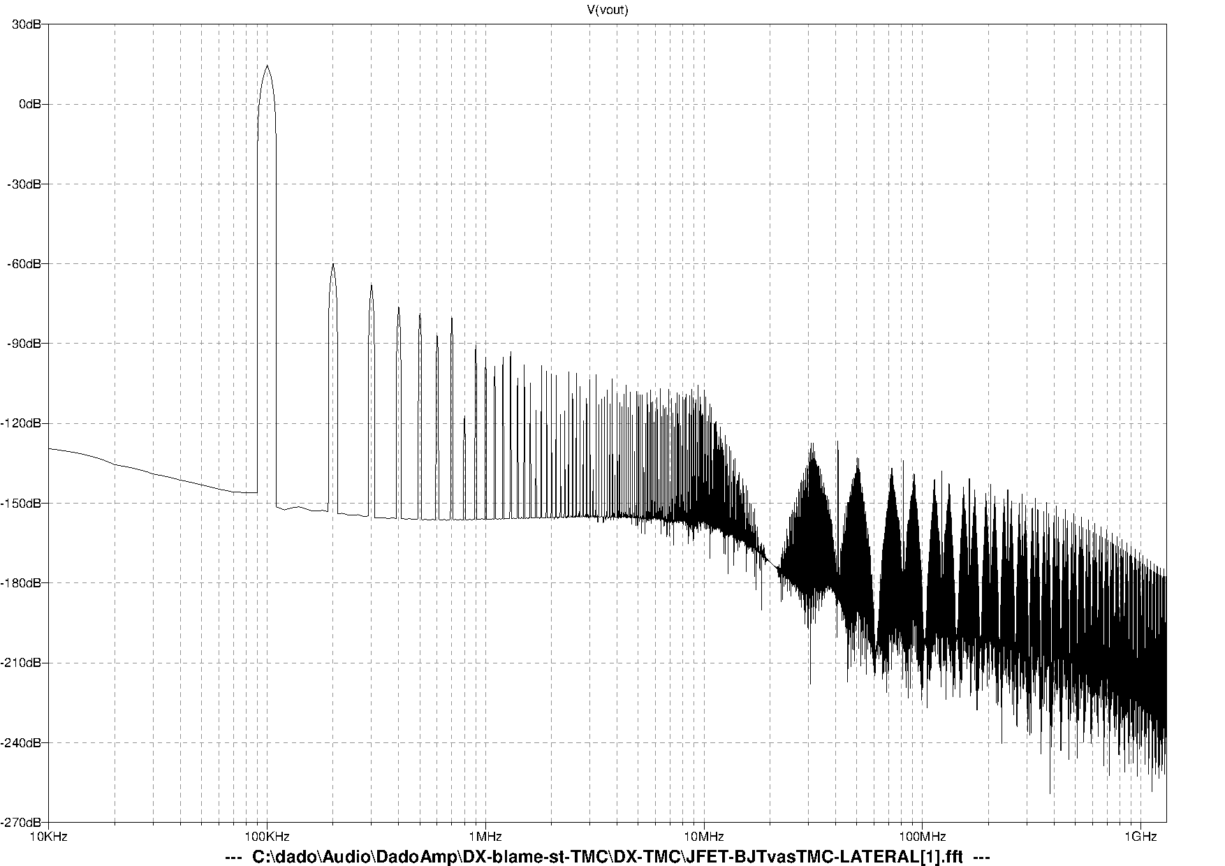

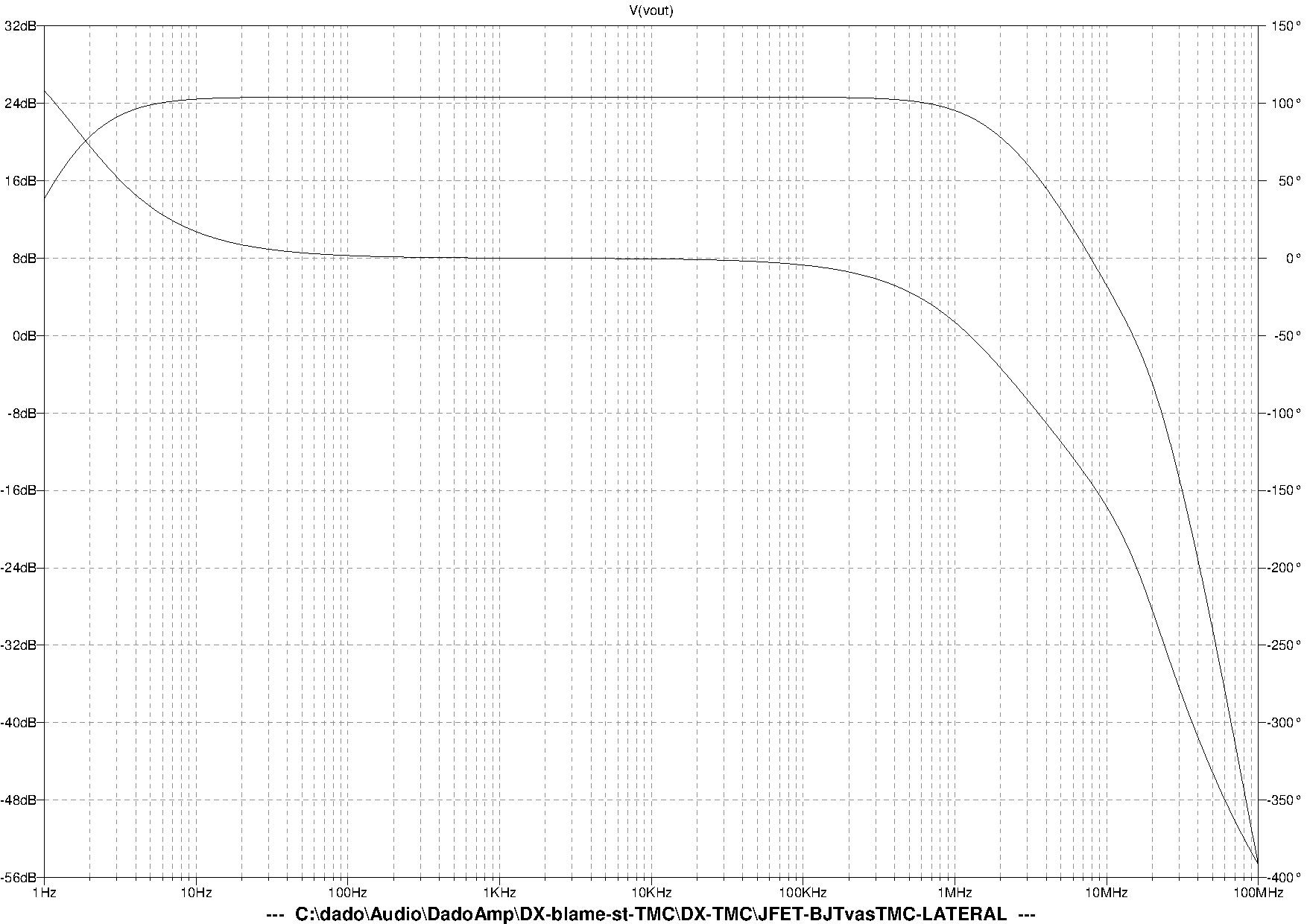

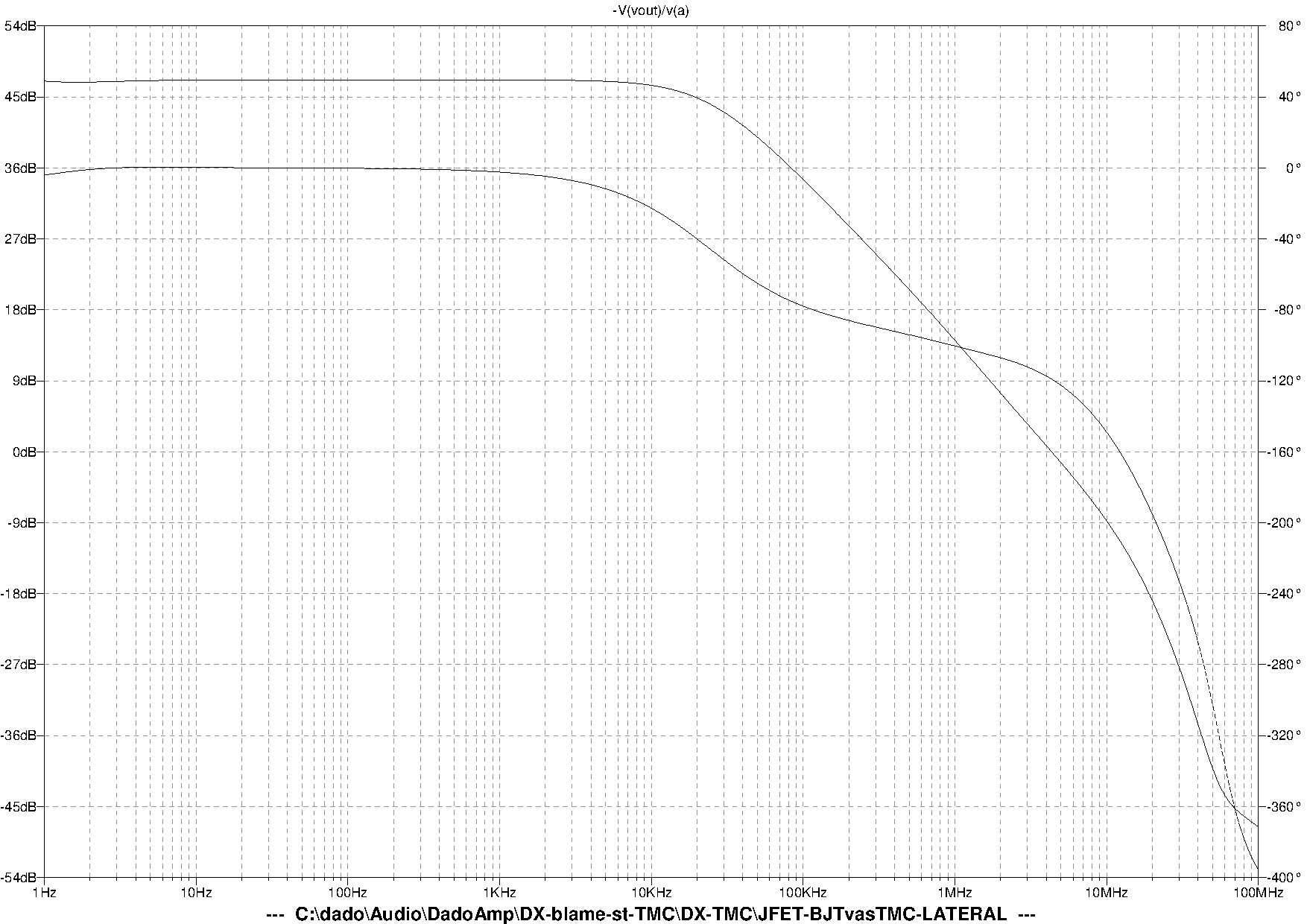

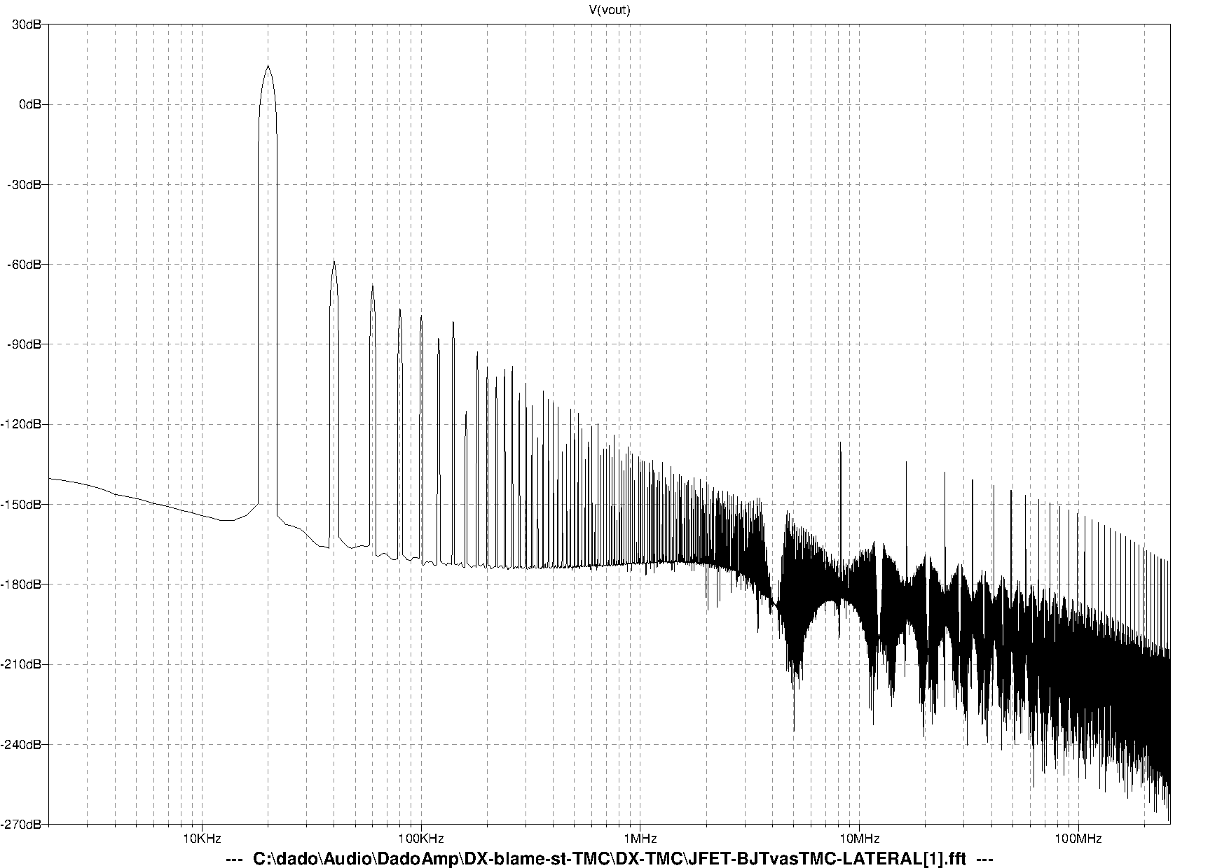

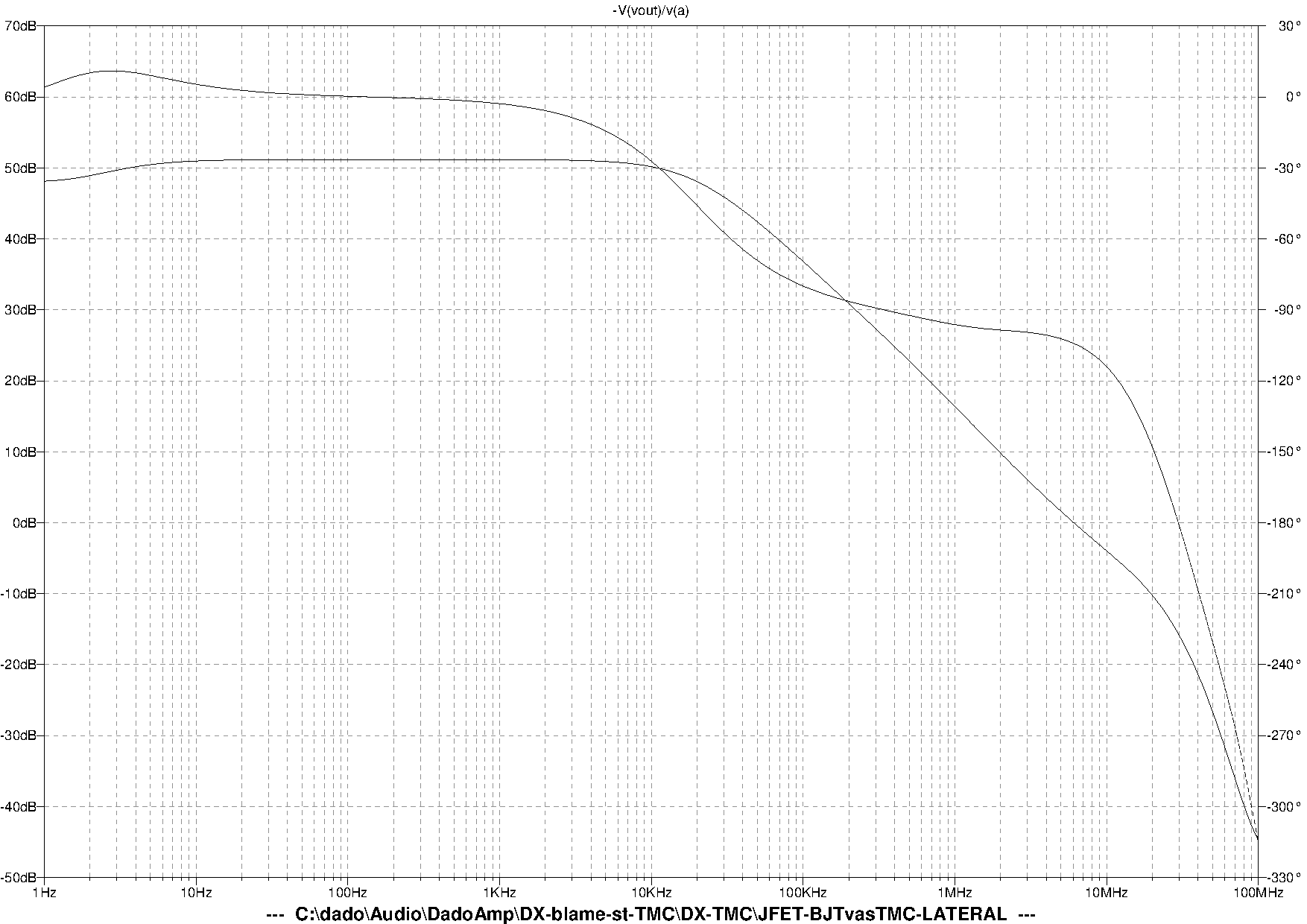

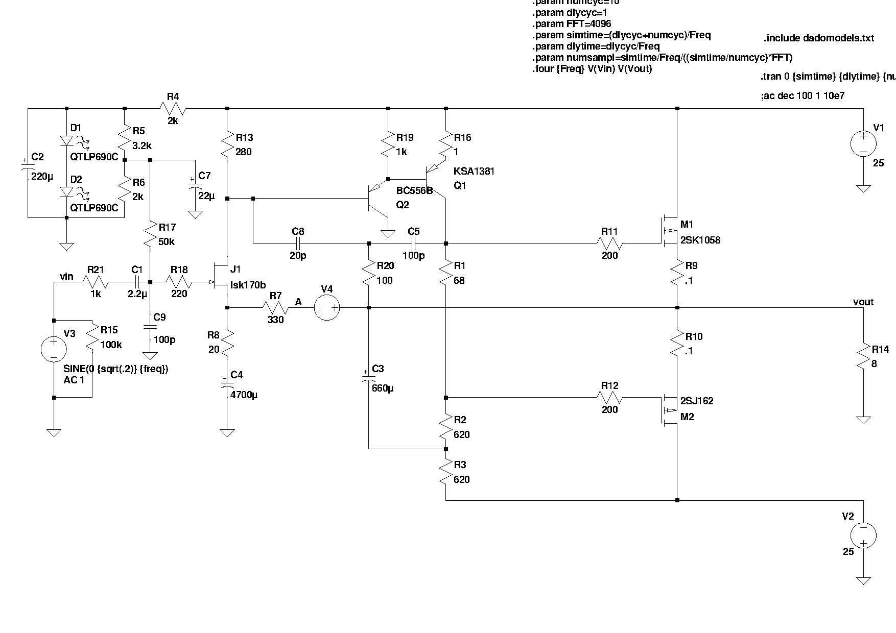

Here is BJT VAS with TMC.
Distortion from 0.022 at 1kHz down to 0.02 at 100kHz.
Attached:
OLG, CLG, FFT, schematic and LTspice zip file
dado
Attached:
dado

sng001
I do not think the open loop gain is large enough to use TMC.
If open loop gain is low than it makes no difference
Do not say "I do not think the open loop gain is large enough to use TMC", simulate it.
Here is OLG for the same schematic I used before with 20pF of Miller cap only, no TMC.
dado.

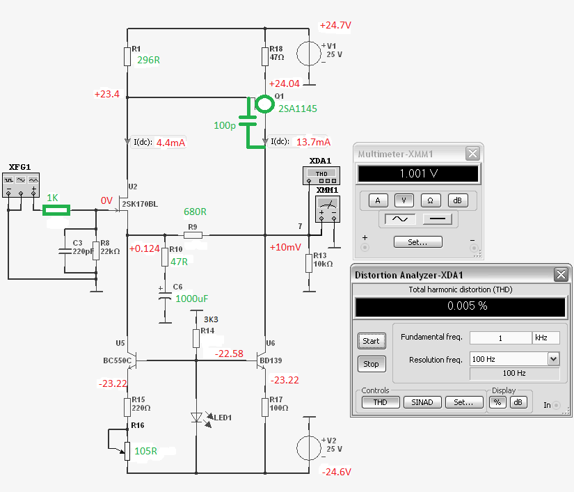

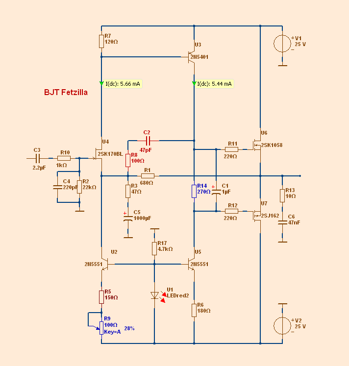

BJT Fetzilla with 2N5401, 2N551
Here is a take on BJT Fetzilla.
As the current demand is only like 5 mA, we can use small signal TO-92 bipolar.
Here I use 2N5401/5551.
But can also be BC550C/560C or 2SA970/SC2240 or 2N3904/3906.
Circuit below simulates well. THD is acceptably low.
- JFET input, MOSFET VAS, LATERAL output = Perfect!!
