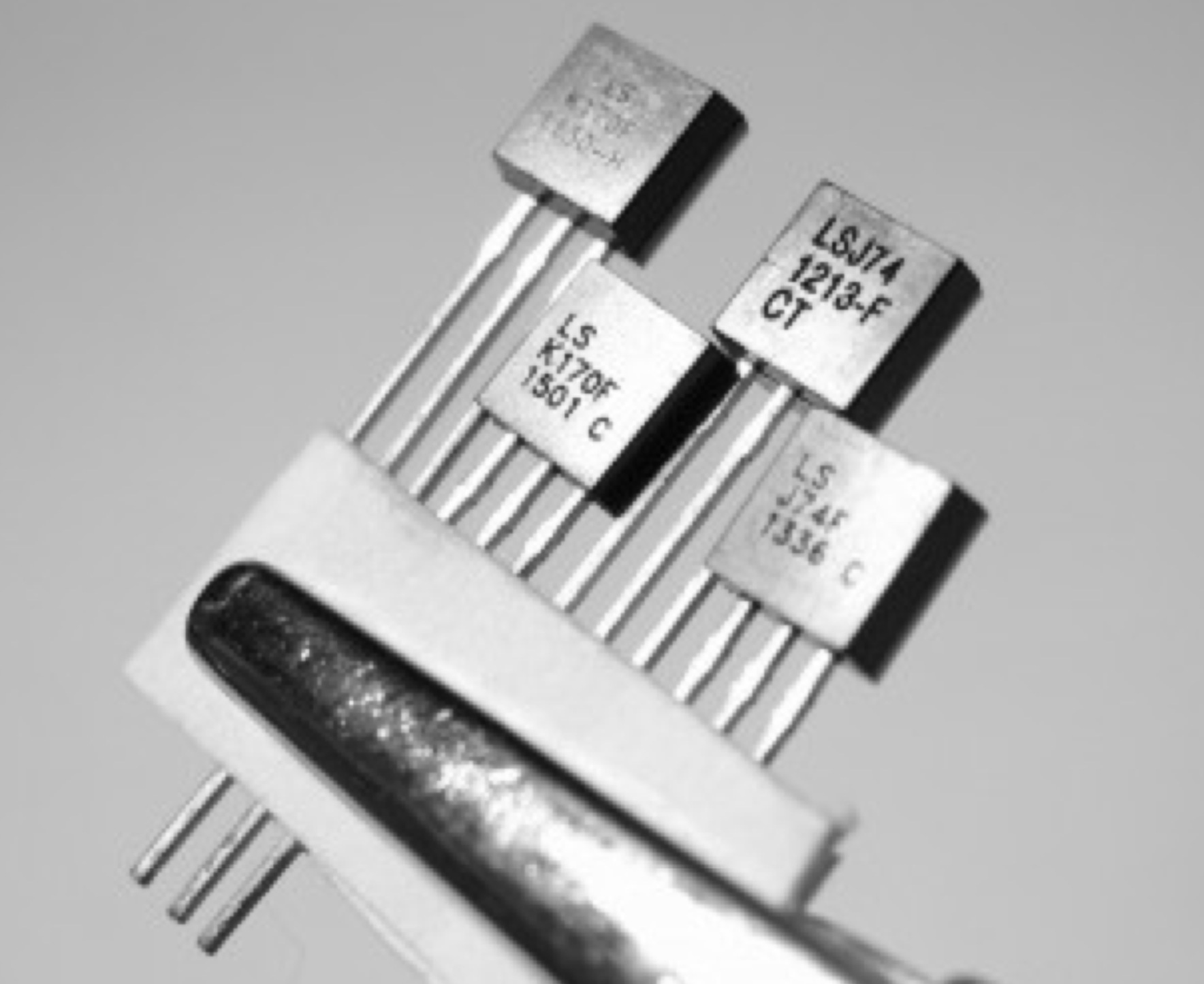

There is an overlap on grades where a B grade could be as much as 12 idss and a C grade is 10 idss. I hope that is the case. Three of my fets are C grade and one 170 does not have a grade. I am going to check the idss later today and I will report my findings.
David

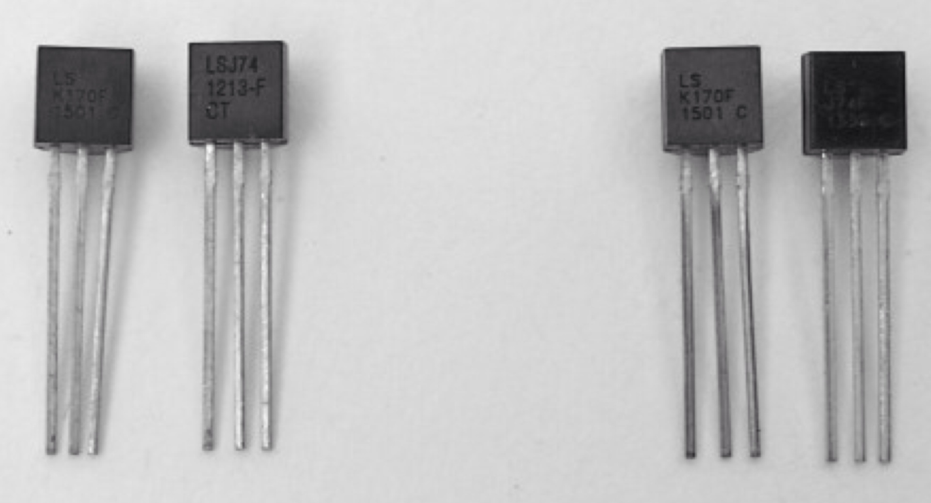

I am happy to report my findings testing the idss for the matched jfets.
The first pair
k170 10.6 idss
j74 10.59 idss
2nd pair
k170 10.6 idss
j74 10.57 idss
I was using a 9 volt battery that tested 9.6 volts. I am very satisfied with the results and how well both pairs matched to each other. Hats off to the Diyaudio store.
David

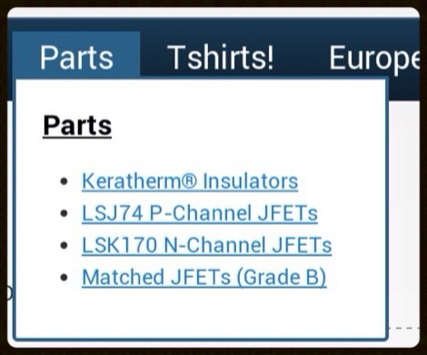

Grade letter on matched LSK pairs is C not B :scratch: ?
Best regards
David
Some of the JFETs have the letter C on them, and some are unmarked. The marking of C on the transistor is not a grade marking. The grade is unmarked. Really. We have double triple confirmed with LS, who supply us the different grades in separate packaging and we are very careful to ensure we don't mix them up. The C on them has nothing to do with the grade, the grade is not marked. You just have to trust us 🙂
