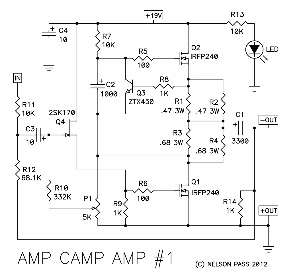

Hello. Can someone tell me which device grade A, B, C etc. is best for an Amp Camp Amplifier? It's about LSK170 which in this schematic is operated in Common-Drain mode (a buffer) that keeps the input impedance high.
Thank you in advance for your answers.
B

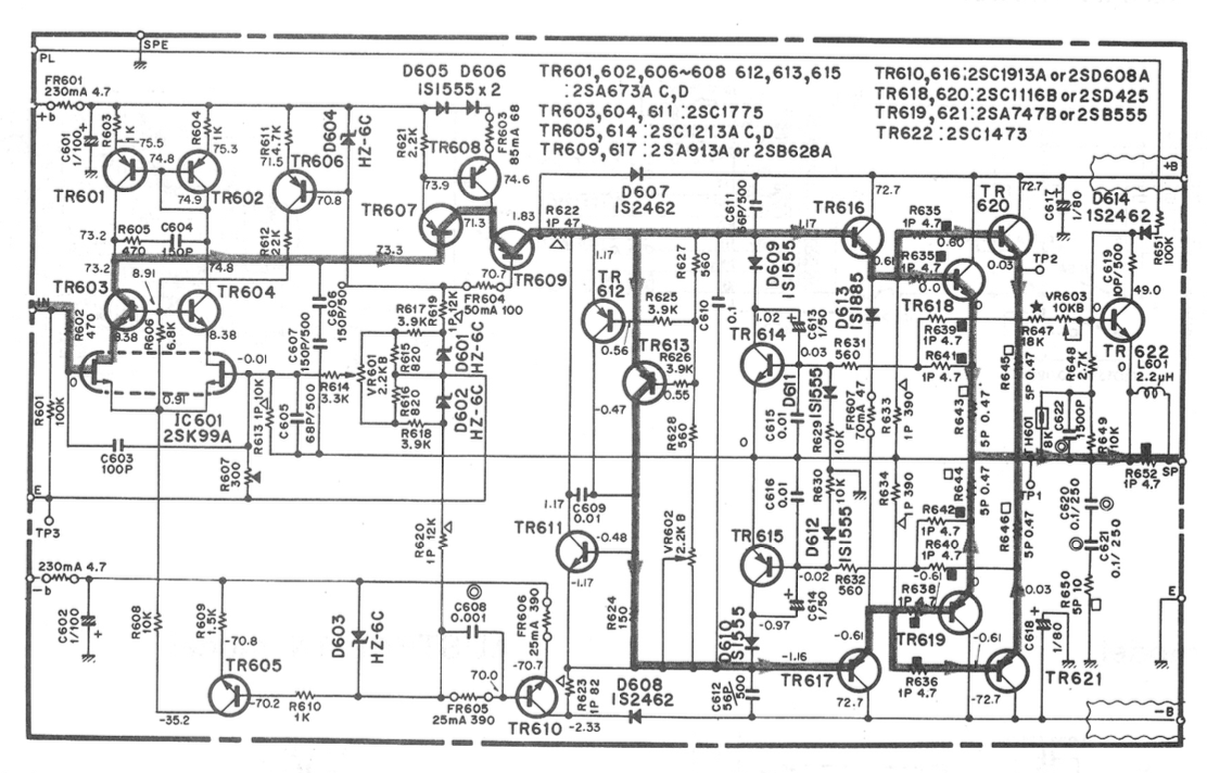

LSK170's replace 2SK99A?
I am a newB, so please bear with me. I am restoring a Yamaha CR-3020 receiver. The main amp has a faulty dual FET (IC601-2SK99A). I have been told that a pair of LSK170's may be used to replace the 2SK99A. If that is correct, which grade would I need? A,B,C or D? I have attached a schematic of the amplifier. Any help on this matter would be greatly appreciated.
Looks like the FETs are operating @ ~ 1.7mA each.I am a newB, so please bear with me. I am restoring a Yamaha CR-3020 receiver. The main amp has a faulty dual FET (IC601-2SK99A). I have been told that a pair of LSK170's may be used to replace the 2SK99A. If that is correct, which grade would I need? A,B,C or D? I have attached a schematic of the amplifier. Any help on this matter would be greatly appreciated.
An Idss > 3mA maybe 4mA to 5mA would do.
Check the sk99 datasheet and see what the gm is at that 1.7mA Id
Then look for a device that has similar gm at the same current.
