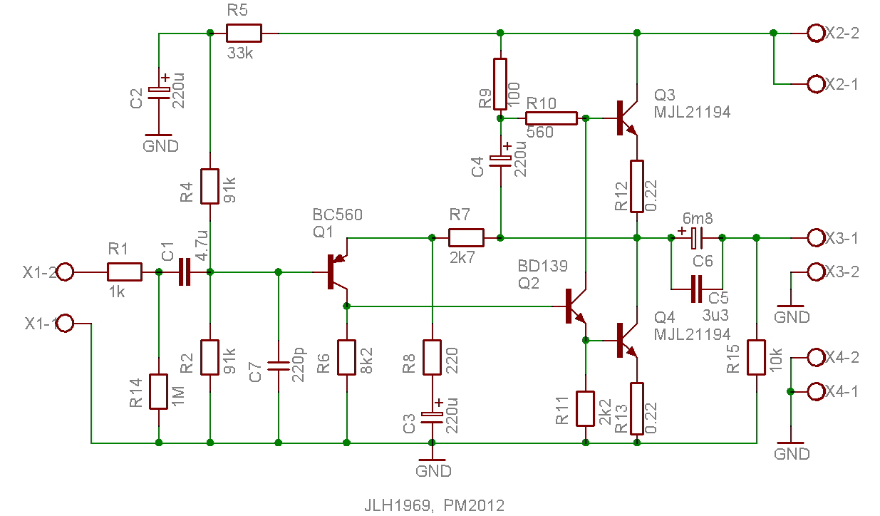

Andrew, I want to keep the original capacitively coupled version. One of the reasons is the possible output DC offset instability, and frankly speaking I do not like the 'improved' circuit designs that appeared after the original version. I bypassed the output capacitor with the 3u3 high quality foil type, and added 2 resistors - 1st to discharge input capacitor to ground (1M) and 2nd to discharge output capacitor when load is disconnected (10k). I also had to add 220pF capacitor + 1k resistor as an input RC, for the reason of faster modern devices used, it was necessary. Output devices are MJL21194 and they do a great job.

Just for the record, this is the schematics as I have built it. I will keep the amplifier, at least for some time of listening tests.
Are you running it on +40Vdc as per your earlier shcematic, #2351? Can you share some details on your power supply?
EDIT: Also, why 1M for R14? Wouldn't there be noise benefits for dropping this to 100K or 47K?
Or, is the input impedance dominated by R2//R4?

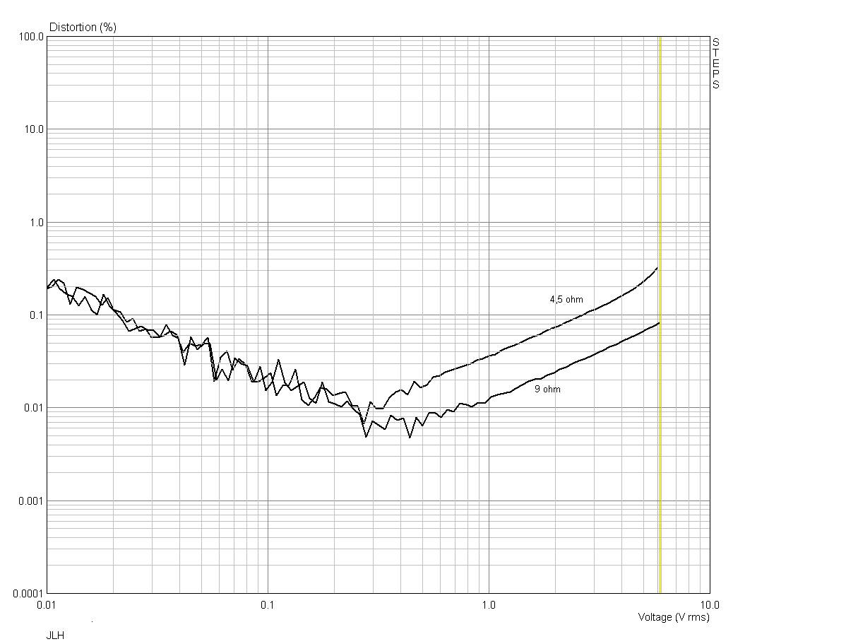

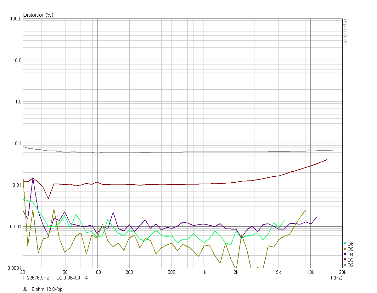

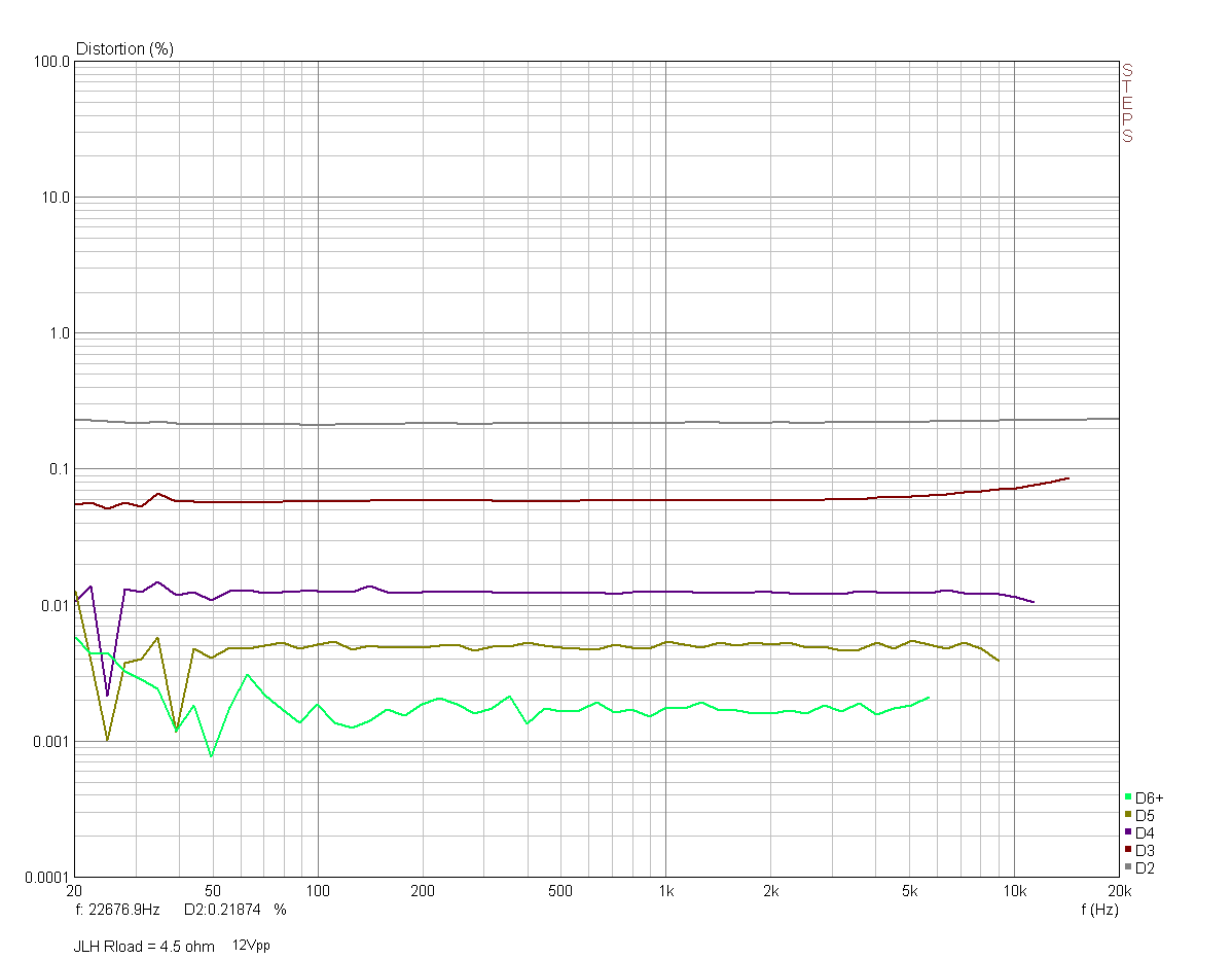

I tried 27V and 42V PSU. Total filter capacitance is 27200 uF.
R14 is effectively shunted by output impedance of the preceding preamplifier (and by R2//R4). It has no noise contribution. You cold make it 100 Mohm as well without any noise difference, or in case you omitt it than R14 = infinity - again you would not consider it in noise calculations. Only R1 (1 kohm) counts for noise. The only reason to use the R14 is to keep C1 grounded when input is disconnected. This is very important to avoid thump impacts.
Several measurements for a version with power supply voltage +27V, one toroidal center tapped transformer 300VA, two separated bridge rectifiers and filters, one per each channel. Capacitor bank 20400 uF per channel (3 x 6800uF). Common ground for two channels. Idle current 1A per channel.
As one can see, THD depends on voltage (amplitude), but is almost independent on frequency. This is IMO very important. The circuit has OLG about 54 dB with frequency corner above 100kHz. This explains why THD does not depend on frequency in audio range.
After years, it is still very competitive design, in case its limited power is sufficient for the user. As long as JLH plays within its power limits, it sounds very good and will surpass most of contemporary class AB amplifiers.

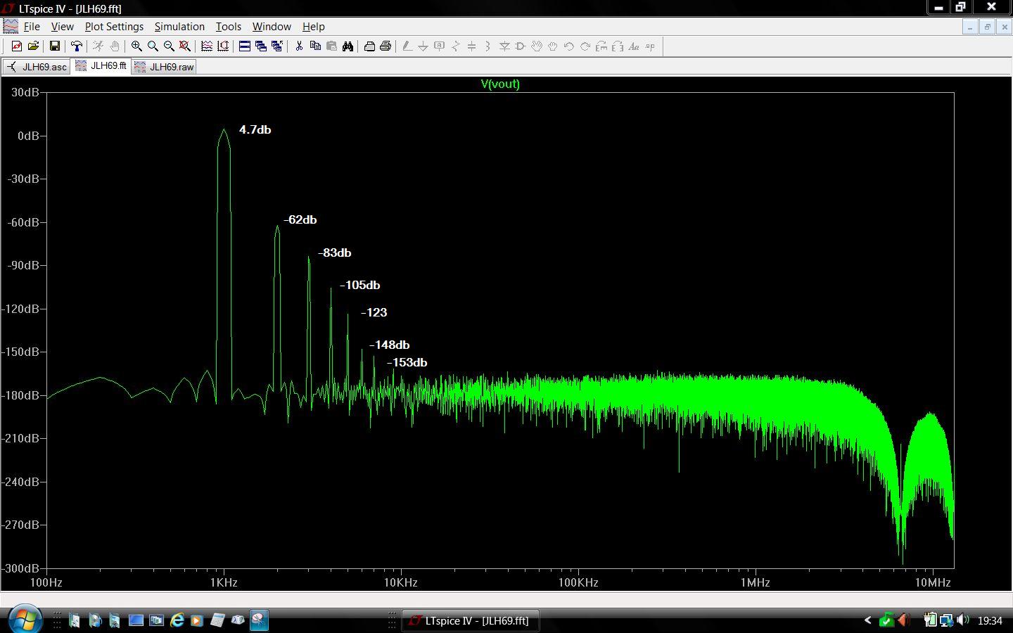

I built the JLH amplifier in the middle of 1970's and I remember that it was was a real breakthrough, compared to usual class B and AB designs of those days. It sounded very clean, full and natural.
It is a wonderful design even today. I attempted a simulation on the original design running on only 17 volts into 5 ohms and the distortion plot to me highlights why it's so good sonically. The plot says it all really with the distortion just fading into the noise floor. And it's not a low distortion design by any means.
If I could achieve this at 100ma quiescent I would be very happy :)
