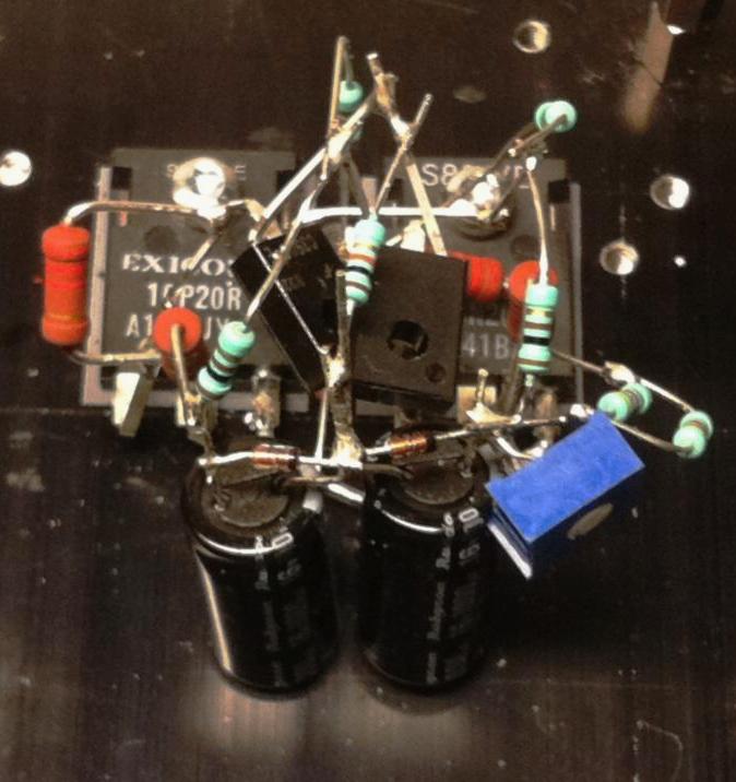

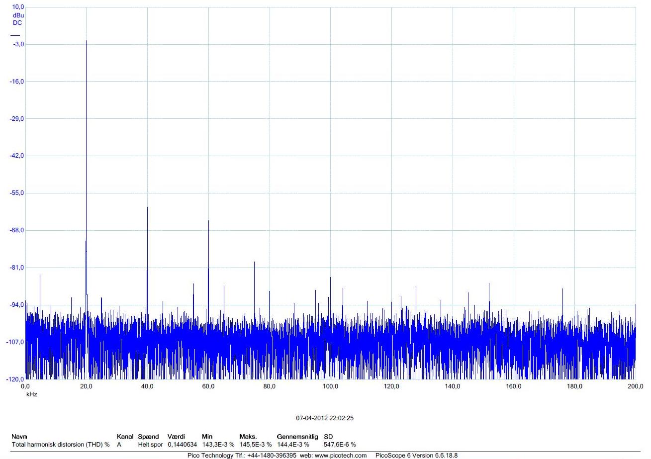

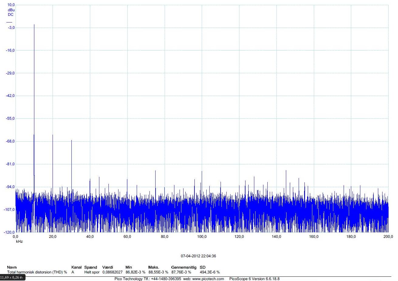

TSSA schematic from the post#1, built by sonnya, all together four transistors only and as you can see from the pics very promising results.![]()
Regarding simplicity measures, the TSSA basic is even simpler design and according to Sonnya measurements, and I believe they are correct, its results are even better than JLH 10 class A amplifier.
But now I feel duty bound to report that JLH thought that single ended amps ( or whatever we choose to call this topology ) - for reasons he did not understand - sounded more pleasant than fully symmetrical designs.
Yes, but lateral mosfets used in TSSA basic weren't available back than hehe
Mike I dont know about that, I have never seen him mention anything on this. l can tell you though if you build it as simple as in the Tssa thread it has even lower odd order harmonics, see the measurements.
He mentions that this symmetrical design has virtually no harmonics beyond 4th though when he showed it first.

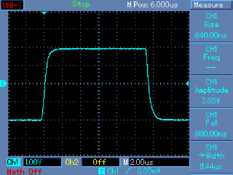

Nice wave form . . . . for the eyes
But the kind of spurious noise that can spoil the sound of a high end amp as you say are very difficult to measure - can be 1000 - 3000 times smaller than loudness of the signal at any moment - so would not be apparent on the scope even if it's there . . . .
But the ears can hear.
