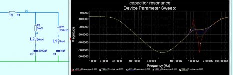

I recently added 1.0uF as bypass cap for an o/p stage, everything becomes much clearer but with strange character to the sound . When I add 0.1R in series with the 1.0uF then the sound is clean again.
In spice the effect ( and the cure ) can be clearly seen. Not sure how much this applies to an o/p cap but the laws of physics cannot be escaped - if you add C & L with low R you have high Q at resonant frequency.

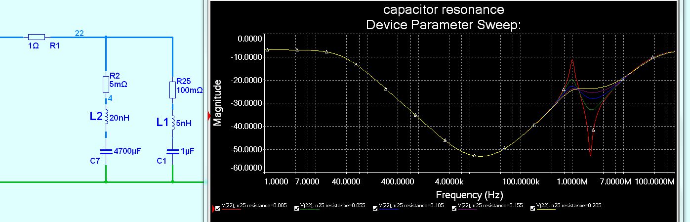

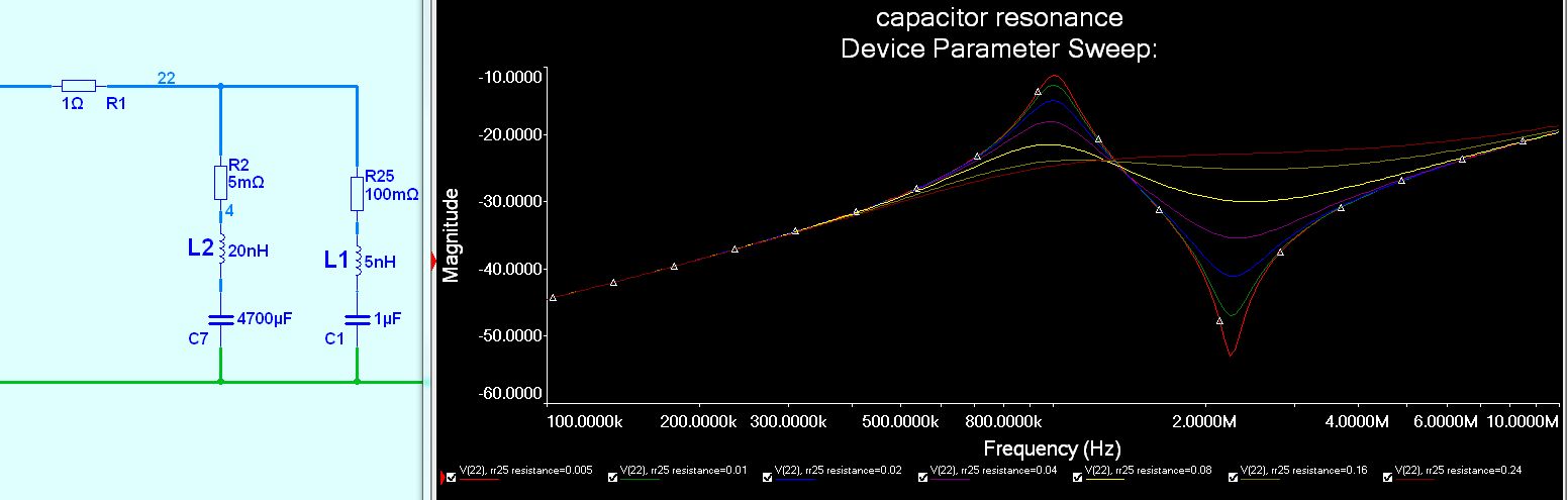

I show below the general spice research I did to explain to myself ( again ) the cause of the roughness I heard with 1uF bypassing 470uF ( with other caps upstream ) The findings shown match what my ears clearly hear
This graph shows AC sweeps. The 1uF bypass cap with R sweeping between .005R & .205R.
I have the feeling this is not news to you - but may be to others
Whoops - I post 4700uF but actually it makes little difference - the principal is clearly shown

Mike,
a resonance of a capacitor with inductance of lead conductors is normal, standard phenomenon.
But, your simulation may be pretty misleading for unexperienced diyers, for the reason that there is a speaker impedance in series with output capacitors.
Your simulation fits in case that you put a capacitor across amplifier output terminals (directly to ground). Then, as every amp designer knows, we see damped resonance (ringing) caused by wire inductance and capacitor capacitance.
I am sure that ESR and ESL of the output capacitors do not cause any ringing, when driven from real amplifier output and loaded by real electrodynamic speaker. Please note that I do not speak about AMPLIFIER instability and oscillations, but just about RLC.

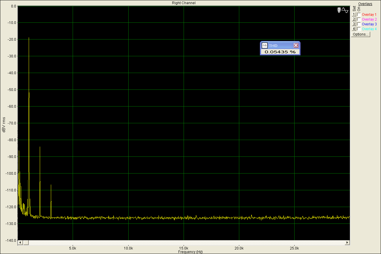

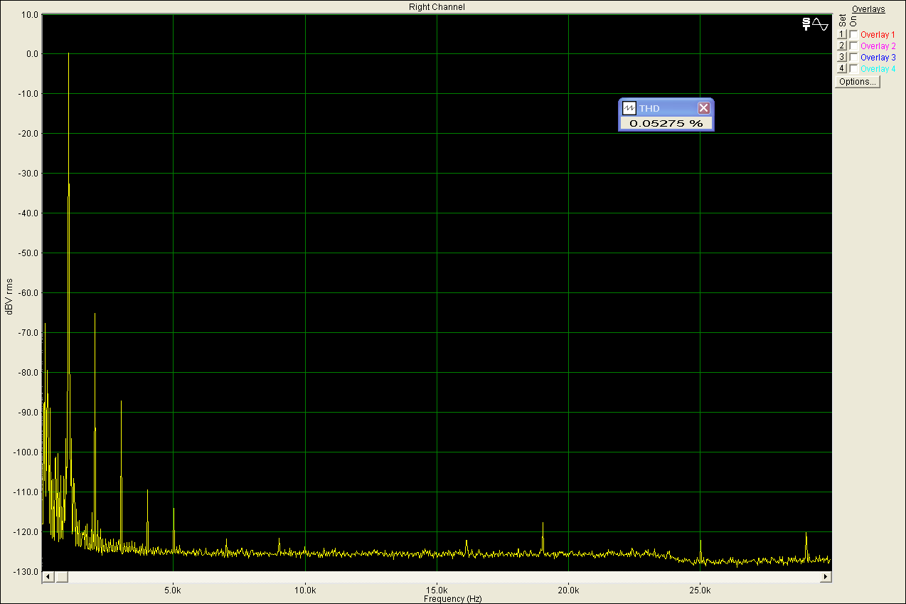

I would like to add that JLH distortion results strongly depend on supply voltage and idle current, for the same load. Please note that most of my measurements are for single supply voltage of only +27V and idle current of "only" 1A. The dynamic range is also affected by a measurement method. One can clearly see effect of FFT resolution in the two attached images. One with resistor divider in front of the soundcard and the 2nd without the divider. Please note that lines around 15kHz and 19kHz are TV line freq. and FM radio pilot freq. induced to the high-sensitive setup. Frequencies at 25kHz and higher result from digital soundcard circuitry. Load and Vpp can be read from image file names.

Just looked again at what I understand are real world fourier results for Pavel's JLH & Sonnys's TSSA and unless I am missing something I would say the JLH figures are more impressive - lower noise floor & total absence of higher order harmonics.
I'm curious to know why you thought the opposite - did I miss something ?
mike
From pics it is obvious that measuring "environment" of Sonnya's equipment has inherent noise floor at -100 dB, or it can be the noise floor of uncompensated, no low pass filter treated amp. That's really not so important, cause it's to low to affect real life performance. Also it can be mostly sorted out with good power supply etc.
What I was mainly concentrated were spectral components, ratio of higher order presence and their suppression. Measurement conditions were different so not so reliable comparison after all.
TSSA was without any reference point in the circuit (sch from the post#1 in TSSA thread), two simple CCSs added would rocketed performance surely.
I always do fourier analysis in spice up to 20khz and I always have a high reading at 19khz.
Strange to see it there exactly the same in your real world analysis - so it may be something to do with using computers for analysis ? ? ?
I do not believe it is real
mike

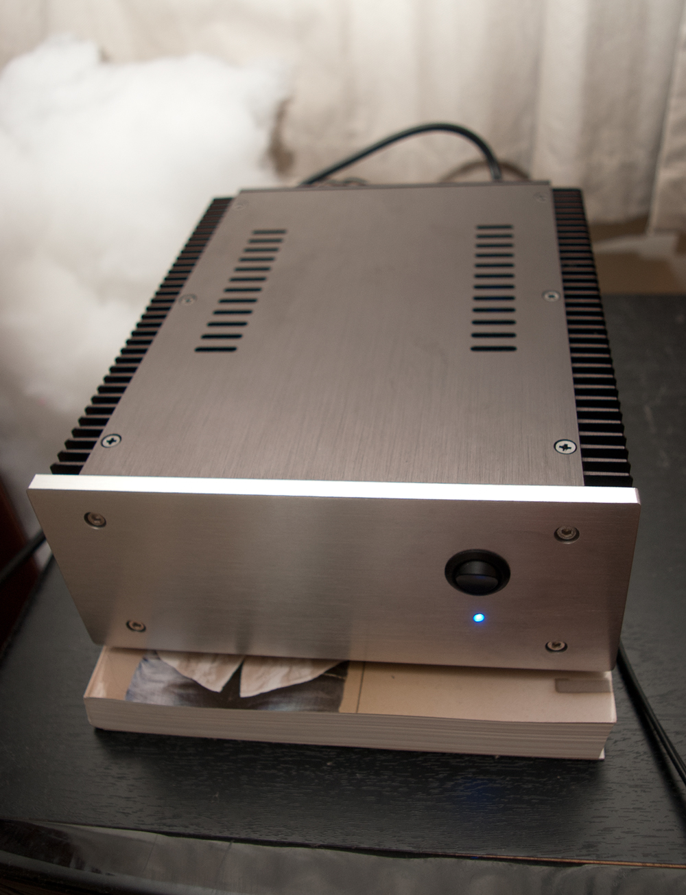

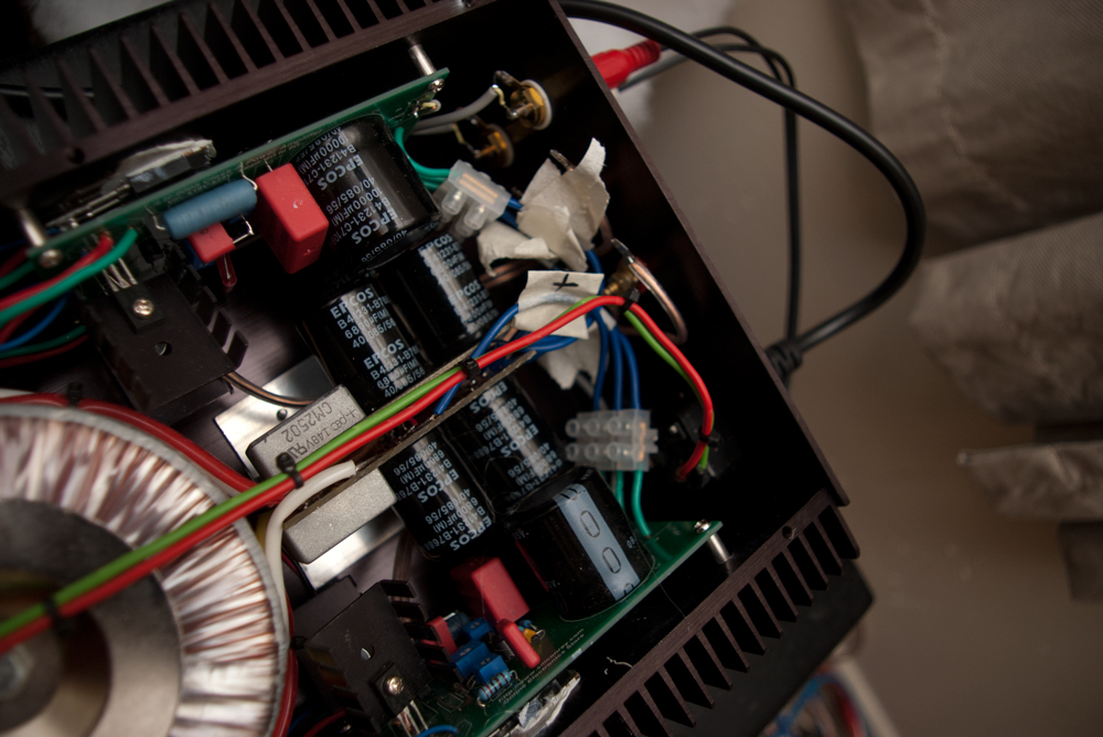

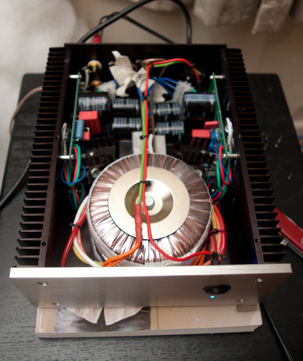

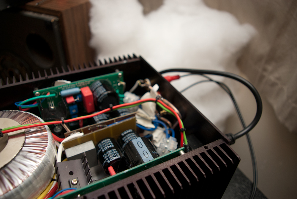

My JLH is all cased up and running well
Looks pretty good
Where did you get the casing and what psu are you running?
Kenneth
