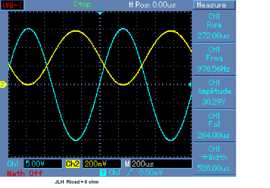

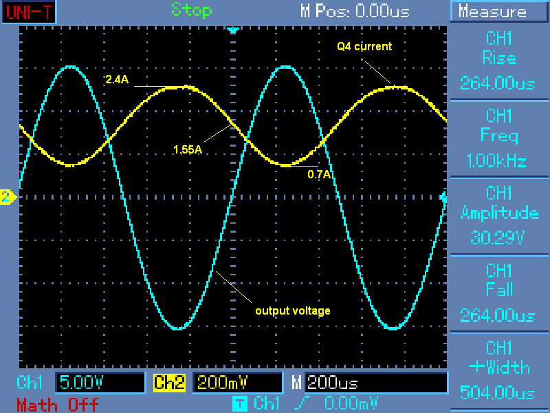

JLH is NOT a single ended class A. Both upper output transistor and lower CCS transistor are driven and the CCS is modulated by signal. It is able to give about 1.7 x idle current. Real measurement oft the CCS current attached.

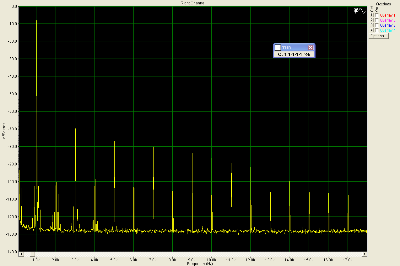

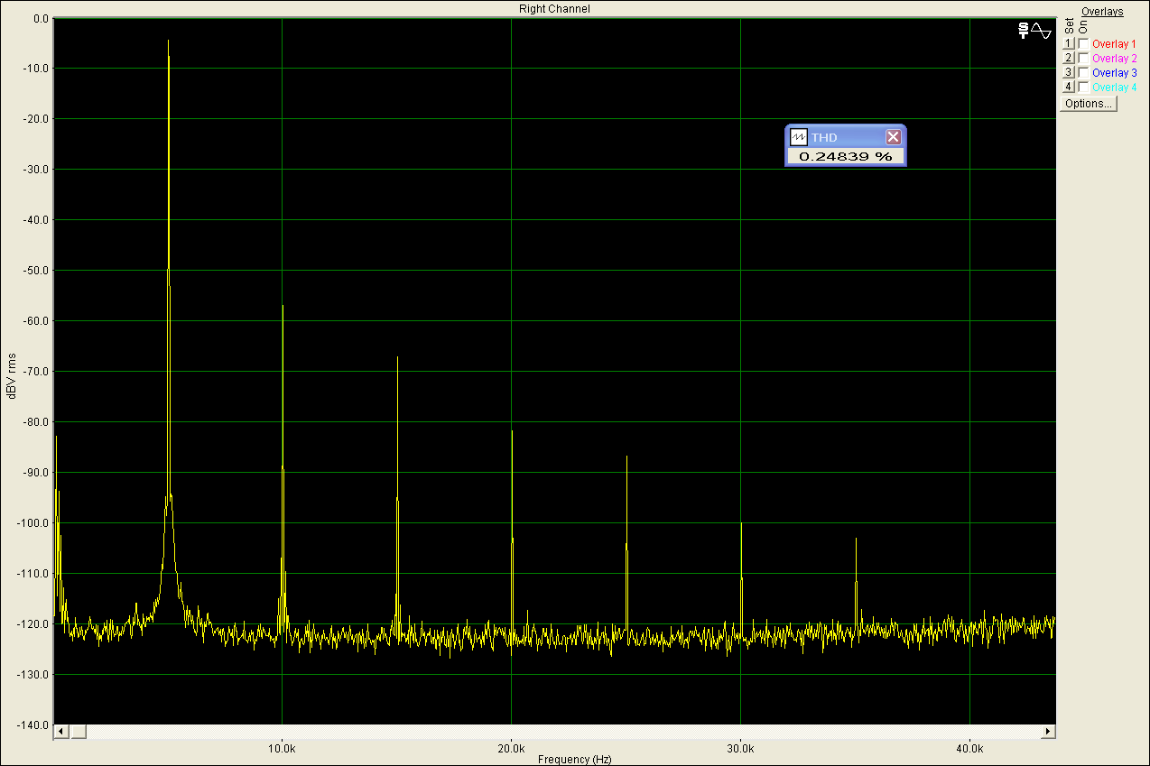

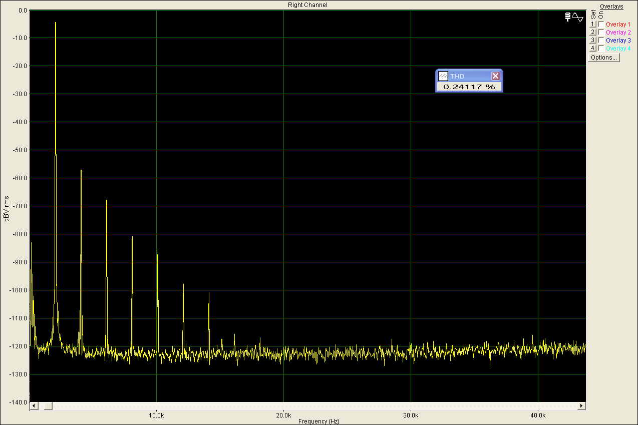

No, it does not happen in reality. I have made a huge set of measurements for various supply voltages, idle currents and loads. Near to clipping H3 starts to predominate, but not dramatically. Simulation does not give good results for this amplifier, and extremely depends on accurate models of output devices. Let me show a spectrum near to clipping.
I would like to add that distortion near to clipping strongly depends on idle current and load. The higher the idle current, the lower distortion and contents of higher harmonics. For the reason that the idle current determines characteristic of clipping.

For home listening, I have measured by oscilloscope and by transient recorder that I do not listen at higher voltage amplitudes than 2Vpeak. And most often it is like 500mV peak. So, the power is not an issue and THD at 100W is totally unimportant at such conditions, but 1st watt (as per Nelson), or rather 1st 100mW are important. The JLH, with its quite high idle current and possibility to give about 1.7x idle current for the reason of phase-inverted drive of the upper and lower output device covers low power area much better than ANY class B or class AB biased somewhere at 200mA. And THIS counts. At low power, the JLH has NO higher harmonics in the spectrum, though with high NFB "low distortion" amplifiers you will find low level high order harmonics (above 9th) as a rule of thumb, if you have enough resolution. This results in a dry, tough sound. These high harmonics are a result of NFB that suppresses low order harmonics at expense of creating high order harmonics, yes in a very low level.
