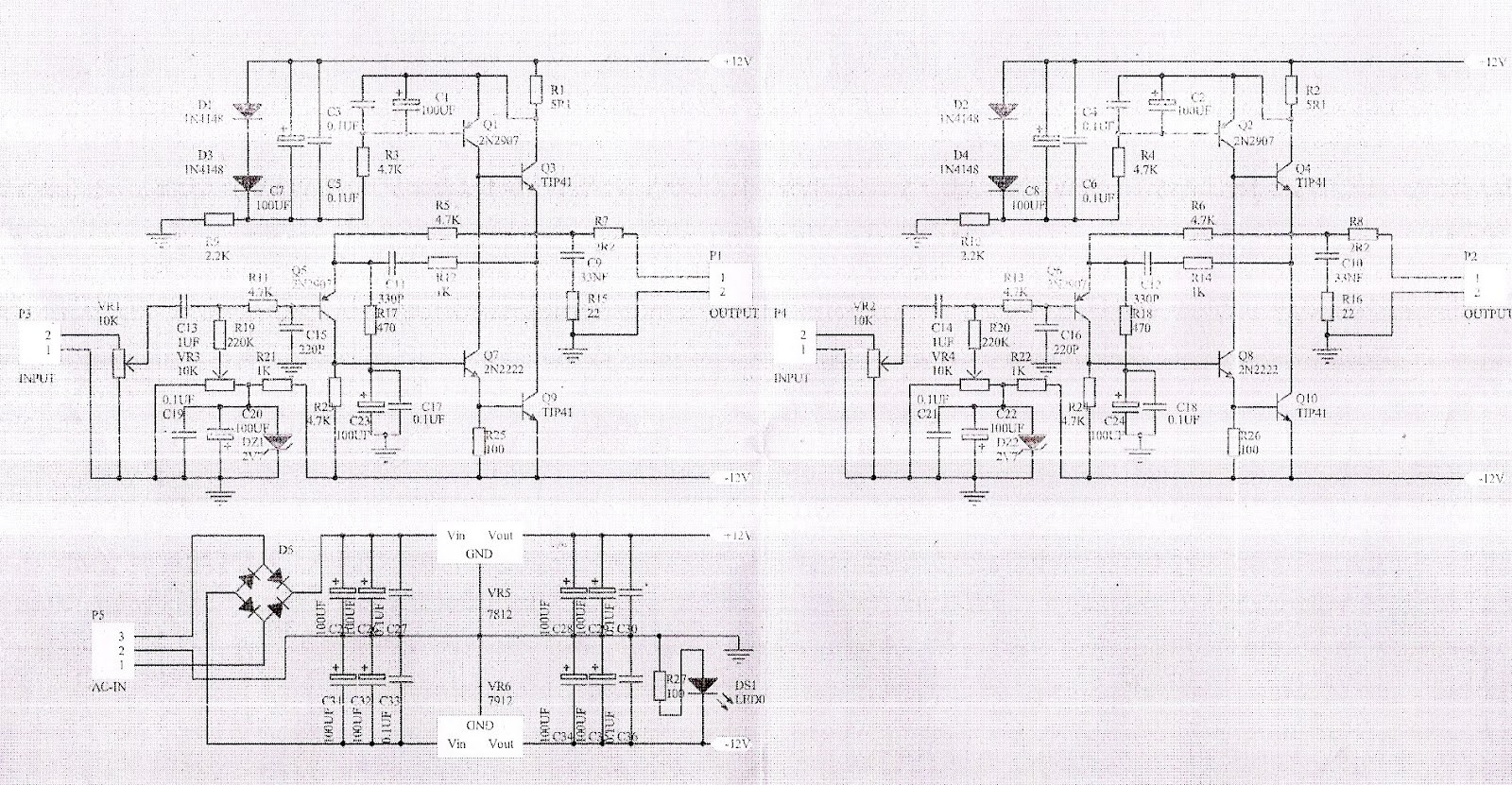

Hello Miles,
I made the modifications you described and everything worked well. However
there was hum cause the Transformer was to close. I decided to put the transformer in an extra case. When I connected everything and powered up and measured voltages everything was fine. Exept that I could not measure an AC Voltage that shoud double on the both secondaries...
So I put my headphone up and there was the most terribel hum I ever noticed!
I was wondering if I have to connect the earth coming from the mains to the
both secondaries which are combined for 0V.

DC offest is -31mV and 50mv
You should measure DC offset when amp is warmed up. The offset difference between cold and warm state is about 100mV. Anyway, up to 50-100mV DC is acceptable for headphones.
ahem I'm not so sure about that
I try to stay under 5mV for 'phones and 100mV for speakers.

I just finished assembling one of these ebay kits and had a few queries, how to adjust the gain (found that), the huge DC offset swing (found that too), and if 60c heatsink temps are normal (confirmed). So after 37 odd pages of this thread it seems i have another evening ahead of me prodding this amp with a soldering iron to work through an extensive list of mods. What a great read this thread was, and what a great forum this is. Cheers all

Has anybody got a copy of the board layout, everybody keeps referencing components like R5, C12 etc which i think is from a diagram on the original JLH site link which no longer works![]()
Some JLH schematics can be found here:
JLH headamps
Jacques
Thanks Jacques, those circuit seem to differ but i have figured it out anyway. Removed all the 0ohm links (measured ~5ohms) and replaced with wire, removed those eight 100nf ceramic caps and replaced the gain resistors with 2.2k which has greatly improved the sound of this little amp. I'm actually surprised how clean it sounds now, though the gain is still too high for my source so i might try replacing those 2.2k resistors.

Hi Mcandmar,
Could you post your final schematics?
How did you solve the swinging DC in output which seems to be the biggest problem associated with the JLH design?
Jacques
I don't have any schematic to post, unless you want a pic? Not much to see really that hasn't already been covered in this thread.
I haven't found a solution to the DC offset yet, but its fairly consistent with ~100mv cold start, dropping to ~0mv after 15-20mins.
If i understand it correctly the zener diodes on the board are used as a voltage reference, and that reference changes with temperature? Which has me curious if there is a better method of creating a voltage reference that dosent drift with temperature. Who knows mounting the diodes on the underside of the board may even help, a little pcb with a voltage regulator maybe?
I'm also curious as to why its suggested to remove the variable pot and solder a link onto the board, surly its better to retain the ability to adjust the offset? I also measured mine and both pots are currently set to almost exactly 3k ohms.

100mV does not cause any damages with any headphones. But if you would like to decrease it, set it to -50mV at cold, it will change to +50mV at warm (or inversly?
