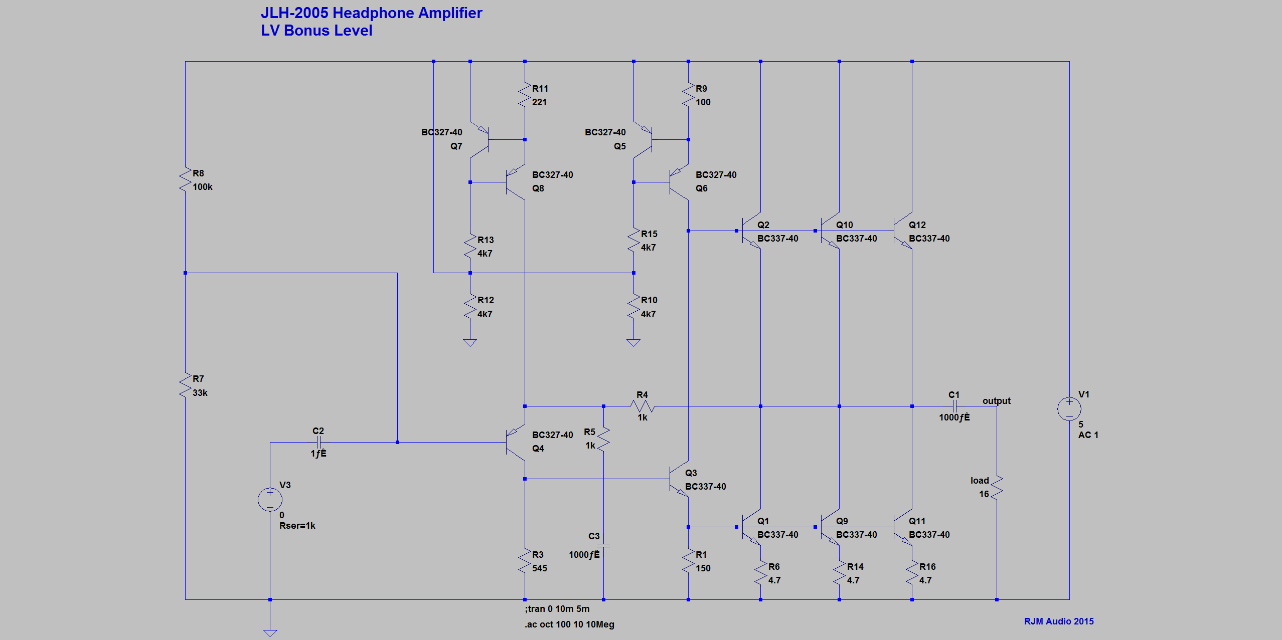

@diegomj1973
Good points all. Thanks very much.
Re R2,R13,R15 : indeed - dunno what I was thinking there.
I got lazy on the bias network (R7.R8) just because... well, until figured I'd tidy it up later when it became a problem. Right now the PSRR doesn't depend on the noise through R8. Bigger issues yet, with the current sources. I added the 5 V ties as you suggested and it made a massive difference ... which I didn't expect and which means I don't fully understand this yet and need to go back to the drawing board.
I figured 5 V would only really work well with low impedance, high sensitivity phones, so the gain is set on the low end. The gain can be increased, but the amp isn't going to be particularly good with 300 ohms home headphones like the HD-600 as there is very limited voltage.
This is the only part I didn't follow. Could you explain why BC327/337 are no good here?
Q4 must be a BC560C instead of BC327-40. Q3 must be a BC550C instead of BC337-40.
R18/C5 low-pass filters the PS noise and provides clean -2.3V relative to top rail for the CCS bias.
The other alternative is to replace your original 4k75 with a E102 CRD, though voltage headroom is perhaps a bit low.
So probably resistors & cap is a better solution, unless you struggle for space.
