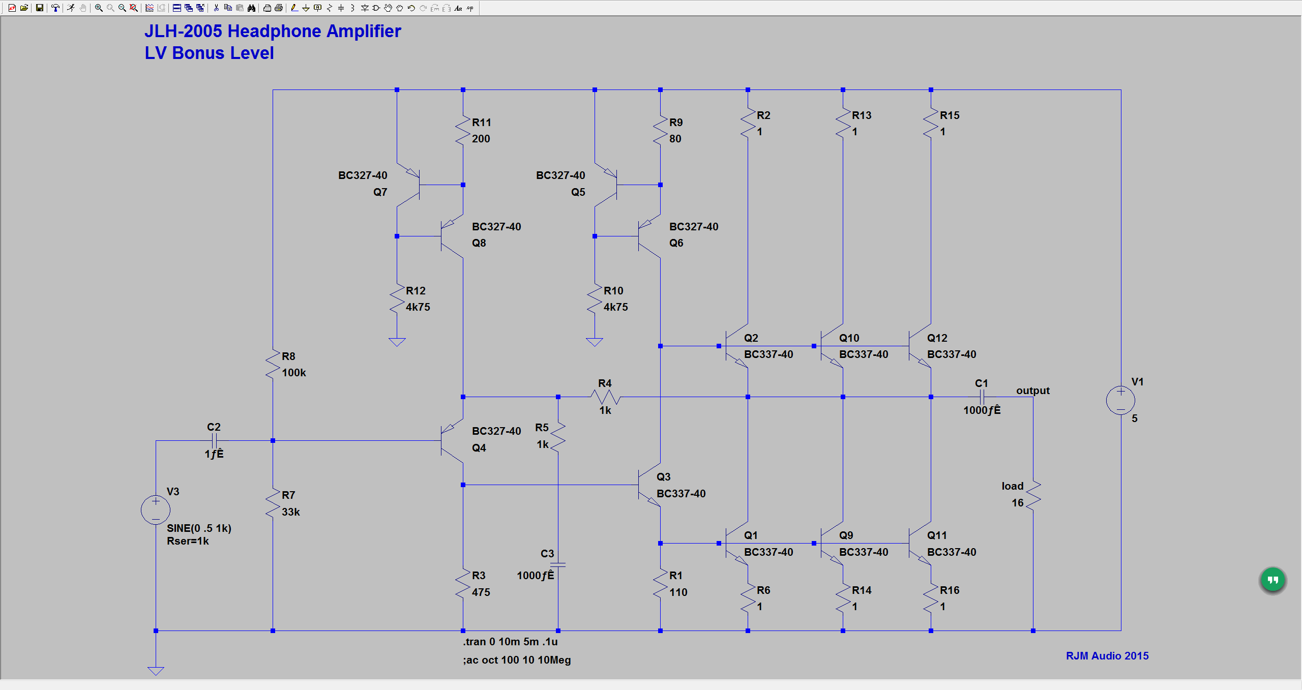

I'm not really too enamored with this circuit, but one neat trick is how it works at 5 V single supply (USB, every little charger on the planet etc.). As a cute, dirt cheap little headphone amp for IEMs, maybe it has some merit...
Noise from the power supply is easily introduced through R8 to the base of Q4. That noise needs to be filtered.
R10 and R12 must be partitioned to insert a filter capacitor from that point to + 5 V. For example, two 2K2 resistors in series with a small 47 uF capacitor from the junction of these resistors to + 5 V. This helps greatly to reduce the noise introduced by the power supply to the path of the audio signal.
R2, R13 and R15 have no function in this circuit.
Q4 must be a BC560C instead of BC327-40. Q3 must be a BC550C instead of BC337-40.
The gain required is only 2 or 6 dB?.
