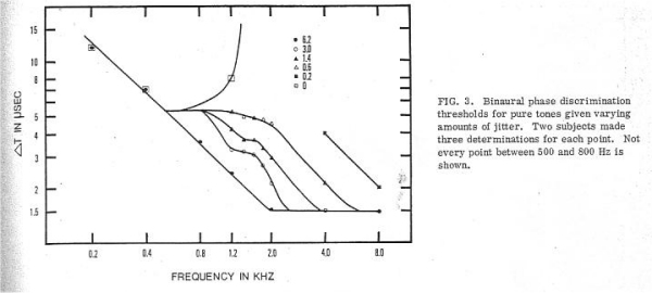

DF96, I am still with you on this delay thing, UNTIL it is shown to me that TINY time delay differences can be detected by humans either with frequency or differentially. Also, it should be clearly stated, by example, how much a time delay can be generated by a typical passive cable with frequency. Without real numbers, this is just speculation, not fact.
Moulton does introduce inter-channel delay - to aid "panning" but lowest delay mentioned is 100us:
Moulton Laboratories :: Principles of Multitrack Mixing: The Phantom Image
a older summary paper on lateraliztion - suggests differential time sensitivity goes away above ~ 1.5 kHz
http://web.mit.edu/hst.723/www/ThemePapers/Binaural/Grantham95.pdf
I would like to see the electrical cable/loudspeaker Z interaction numbers showing this 10us group delay modulation in the electrical domain - below 1.5kHz
See attached. Note that the same paper has a graph which takes it out to 12Khz.
For unjittered sine waves, the summary you speak of is consistent with this data. It is about 5 uSec in the 500 to 1000 hz range.
What cone excursion is required for jittering at up to 2,4, and 6 uSec, assuming 25 C air?
you certainly can get (and measure) Doppler modulation with large cone excursion
I was referring to time of flight, not velocity of emitter.
jn
