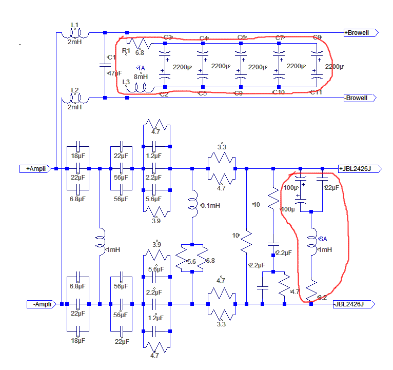

No poison, please read Richard Marsh's and Walt Jung's paper on measurement of capacitor distortion and DA.
We had made such measurements long before Mr Walt and Jung published their owns.
Please, again, refer to the context in witch i use them.
Look at the jbl network. Here, we had the choice to use a 50µf film. No audible difference. blind tested with several people at various levels.
Note on this that the inductance Zobel is sophisticated enough to compensate flat the inductance impedance of the moving coil up to very High Hf (up to 1MHz). Just for you can feel the level of precision of our work.

Why did you NOT keep the 50uF films in the circuit? Then you would be beyond any criticism.
Because our business relied on real sound quality more than image about a hidden part ?
Because everybody cannot afford 50 000$ enclosure and we try to bring the best for money ?
Because the size of this filter is monstrous and heavy enough ?
Because we had never any criticism about, you apart ?
Because, as it was a kit, where filter components was just a part's list, people in concern can choose their parts qualities ?
But you are right, in a way, on the long time it can add some benefit.
