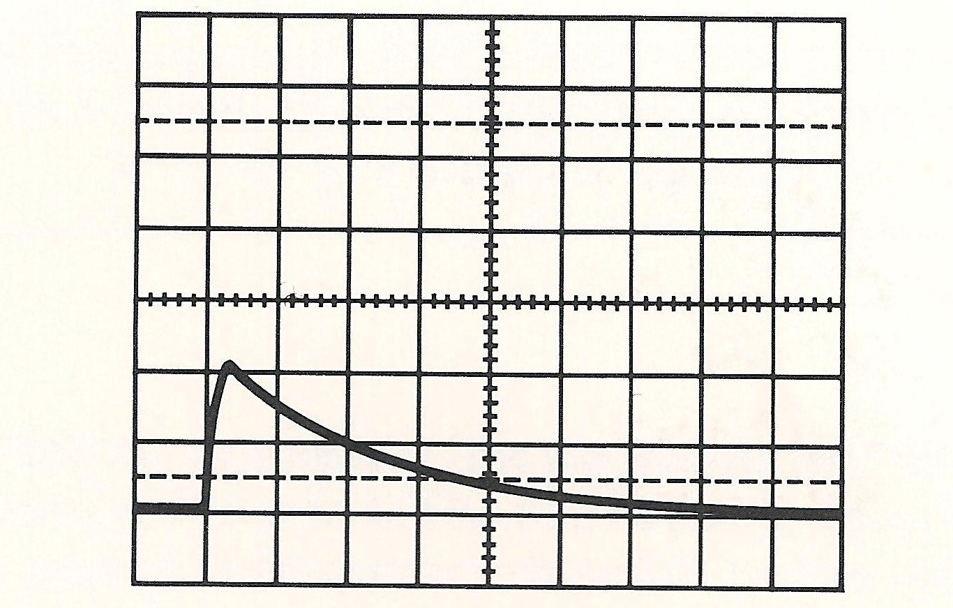

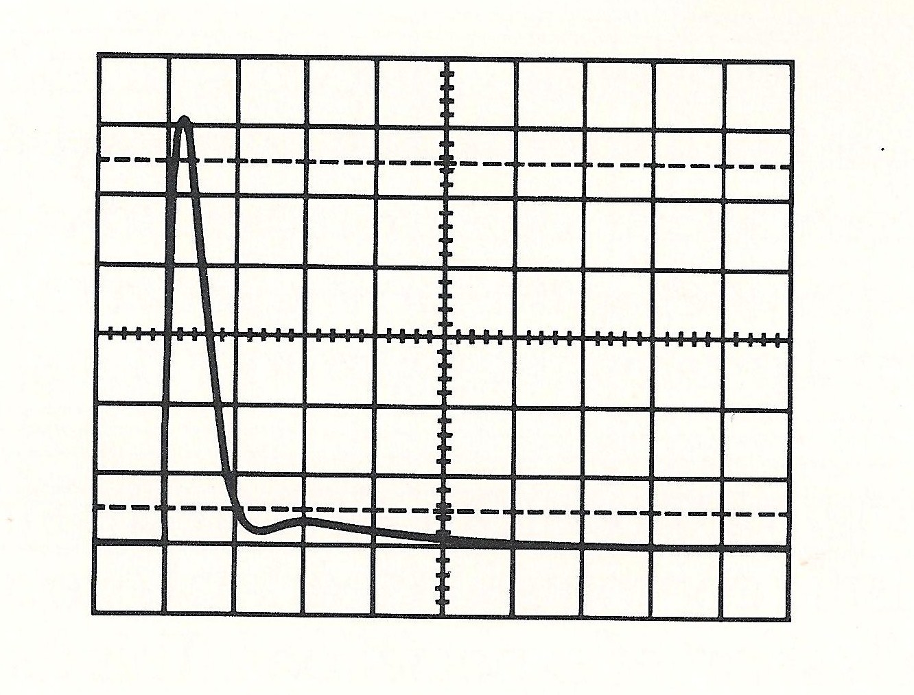

Here are two typical values which are found in cross-overs -- a several mfd. They are same C value and charged to same 5vdc and discharged into themselves-- current monitored [inductive pickup]. The vert scale is 5A/div. The film and foil allows a lot more current to be passed thru itself... compared to electrolytic type construction. So if you calculate the current delivered from power amp to be large, be sure it isnt being limited by unseen series esr from non-film caps. Thx-RNMarsh
[ps - also note the discharge period is then the resolution limit to the circuit]

Thanks for the graphs.
A few Q's..
Are they both jellyroll? Are they internally connected at the same end of the roll, connected at opposite ends of the roll, or somewhere in the middle?
If at opposing ends, they will run current like an inductor, and some of the dielectric will be current starved as well as the unit having higher ESL.
The best ESL will be with connections as close as possible, with foil currents opposing each other on opposite sides of the dielectric.
jn

comments
1. Neither cap used the opposing field construction to reduce its L.
2. The solution for many center image issues is to provide a center speaker channel... that really locks the mono-center image in its place/location. A low level mix added to a center channel does wonders for imaging. minor head placement doesnt affect the center image to the large degree a vitual image does. It helps minimise the affects of speaker dispersion and room affects on the center image as well. and helps lock the imaging between C-L or C-R as well.
I imagine if you used the surround sound channels instead for just across the front, you could use them for even better image localization across the full L to R stage.
-RNM

About the 'electrolitic cap' poison pointed by John, i believe we are back again in the black magic missunderstanding.
And i'm surprised to see that kind of assertion under the signature of an audio Guru.
An electronic cap present a (little) parasitic serial resistance and a parasitic serial inductance.
And minimal measured distortion, sometimes under the one of some film ones .
In fact a very good capacitance.
Dot!
When used in a network in serial with a > 1000 time inductance and a with a >1000 resistance, crossed by signals limited between 20 and 40Hz what the hell ?
When the speaker in // will naturally add a 12db/acoustic filter above 3Khz, when the previous filter is 18db/oct above 700Hz, what about supposed distortions ?
The only thing we can worry about is their life durability and precision.
I'm bored, so tired, with simplistic assertions like 'Electronic caps are evil".
Is is as intelligent as to conclude that car tires are not good after had tried them on a jet undercarriage.

What you see here is their internal resistance and inductance, refer in my above words.They are same C value and charged to same 5vdc and discharged into themselves-- current monitored [inductive pickup]
