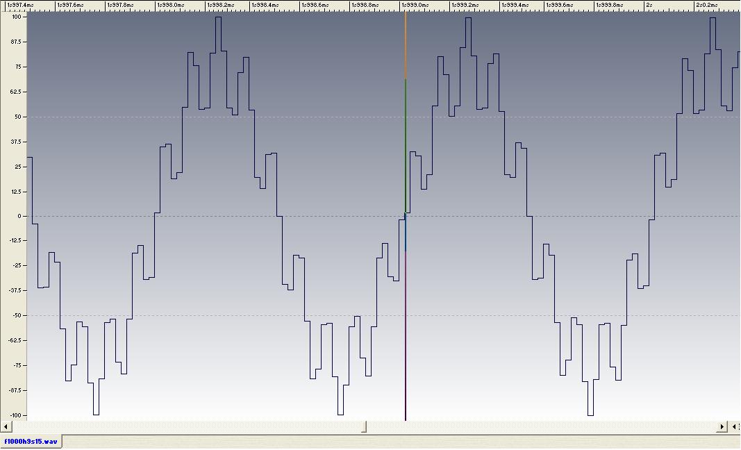

It should be 1K and 9K at 10/1 with the 9K 15 degrees before the 1K until 1/2 way when it changes to 15 degrees after!
How did you capture it? And is there an error in the compression expansion process? I could not just post a .wav file.
I unzipped what you posted and then I opened the unzipped wave file with Steinberg Wavelab 4.
The unzipped wave file has a duration of 3s998.050ms exact. Please check the exact duration of your initial wave file.
OK!
This 30 degrees delta phase may do some of the harm.

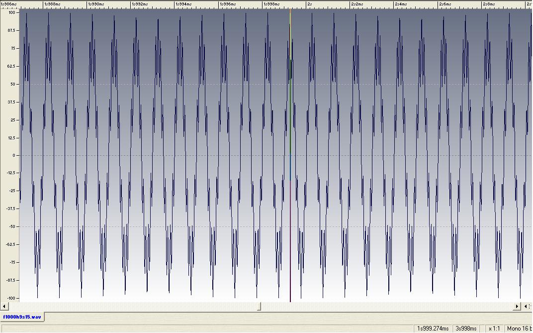

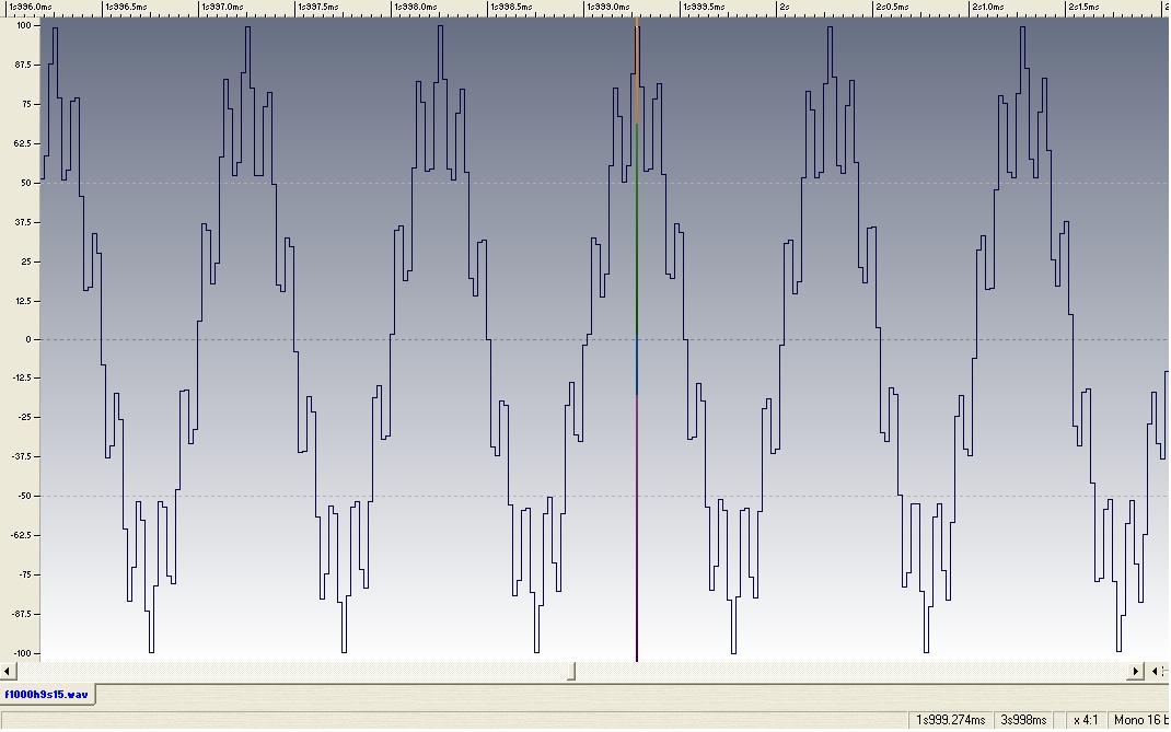

Watching the “glitches”, I can tell that the amplitude ratio is around 10/1. (Visibly, it varies from 7:1 to 11:1).
The attachments below show -with progressive zooming-the exact middle of the unzipped file (the vertical multicolour line is at 1s999.025ms)
Regards
George

The click is the switch from phase shift before to phase shift after. The sin waves should be undistorted.
My FFT was clean over a 110dB range. I used a Houdy7 window.
See the inverse FFT of 1 sec of the first part and 1 sec of the second part.
I listened to both but they sounded similar to me.
I can not perceive any acoustic difference between the two parts of the file. That’s good. It makes me immune to phase difference issues 😛
Alas, I can hear a faint click in the middle of the file.
I spent a lot of time viewing the waveform to spot any sign of a “click”. There is no such sign. I was positive on this. But I was hearing the click.
I changed sound card, amplifier, headphones. I kept hearing it.
Is this “click” generated in my ears/brain?

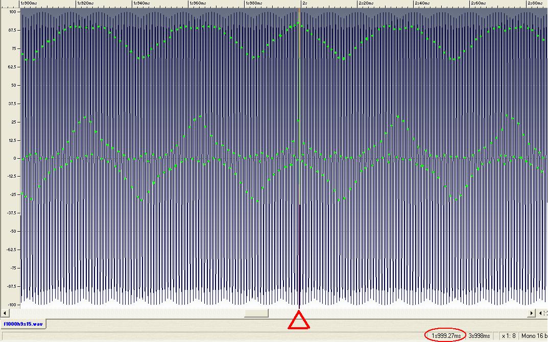

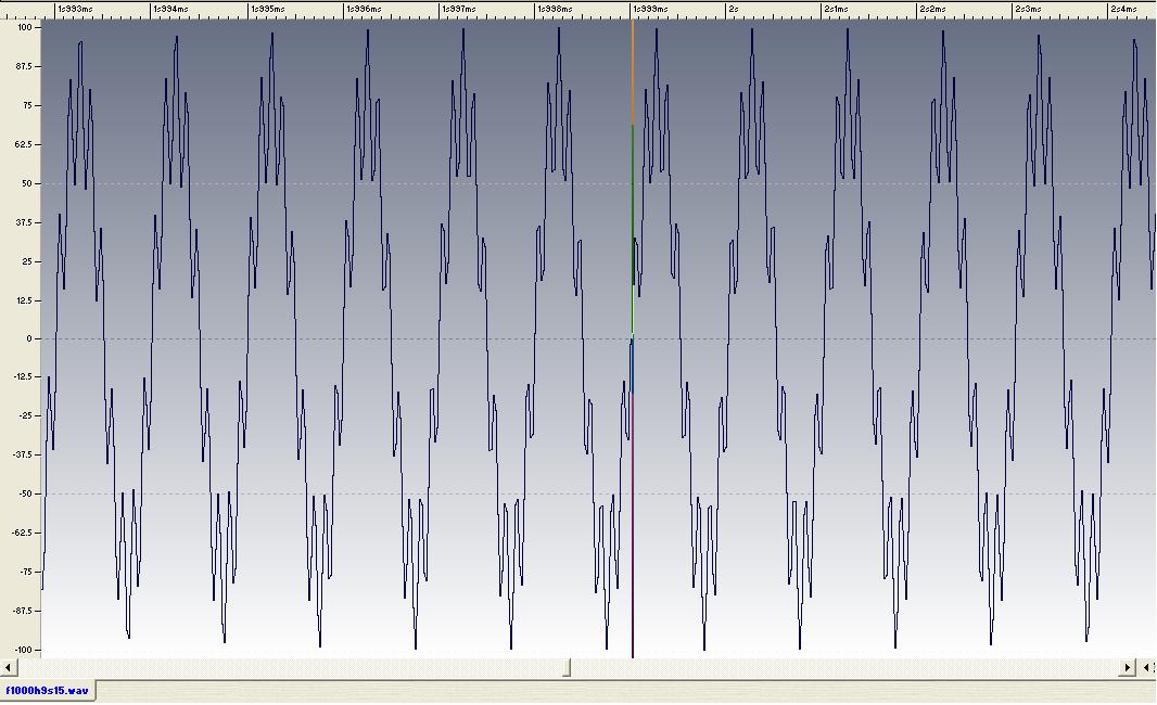

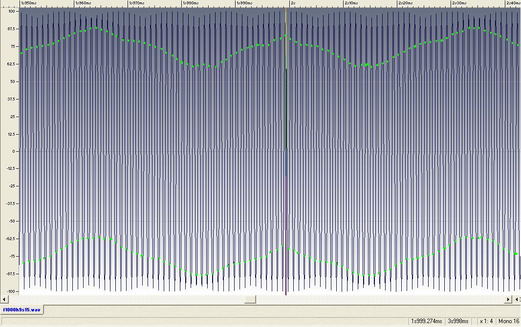

Today I viewed the waveform again. Maybe 😀 it is the morning coffee and the cigarettes that made me see a pattern change -at a specific only zooming level- in the middle (almost) of the file, at 1s 999.27ms.
Attached you will see snapshots of the specific location.
Attachment 2 and 3 are the only zooming levels that the pattern visibly differentiates.

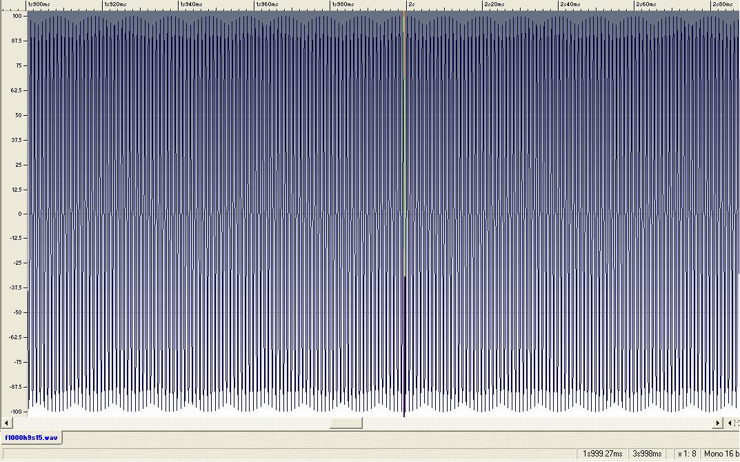

On the two attachments I have marked this pattern with green spots to highlight what I mean with pattern change.
I still wonder if this is what makes me hear the click.
The peak at 1s 999.27ms is ~ 40ms away from the previous and the next peak. The previous and the next peaks which are similar to all the rest, are ~80ms apart.
I’ve read that the brain needs around 50ms to form the timbre quality of a sound. Shorter stimuli are perceived as clicks. Is this what happens here?
