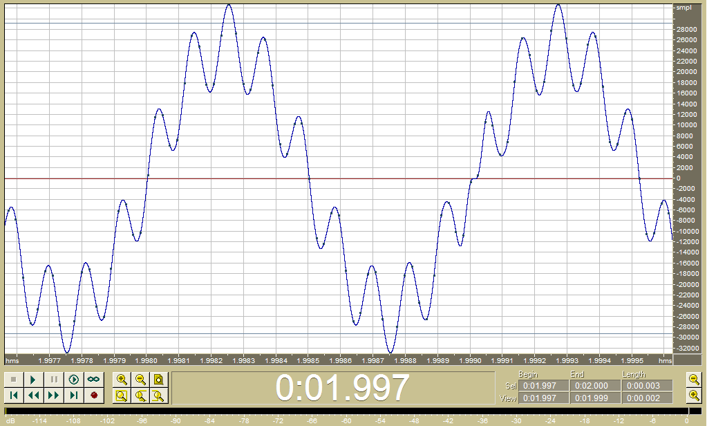

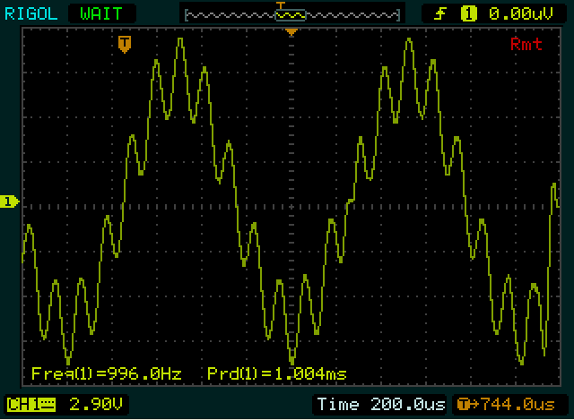

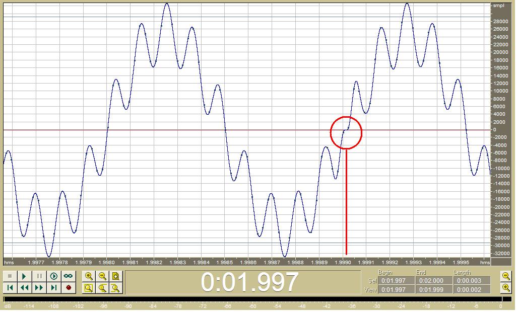

In wav generated with 44.1kHz sampling?
(The same moment, captured with dig. scope and in sound editor)

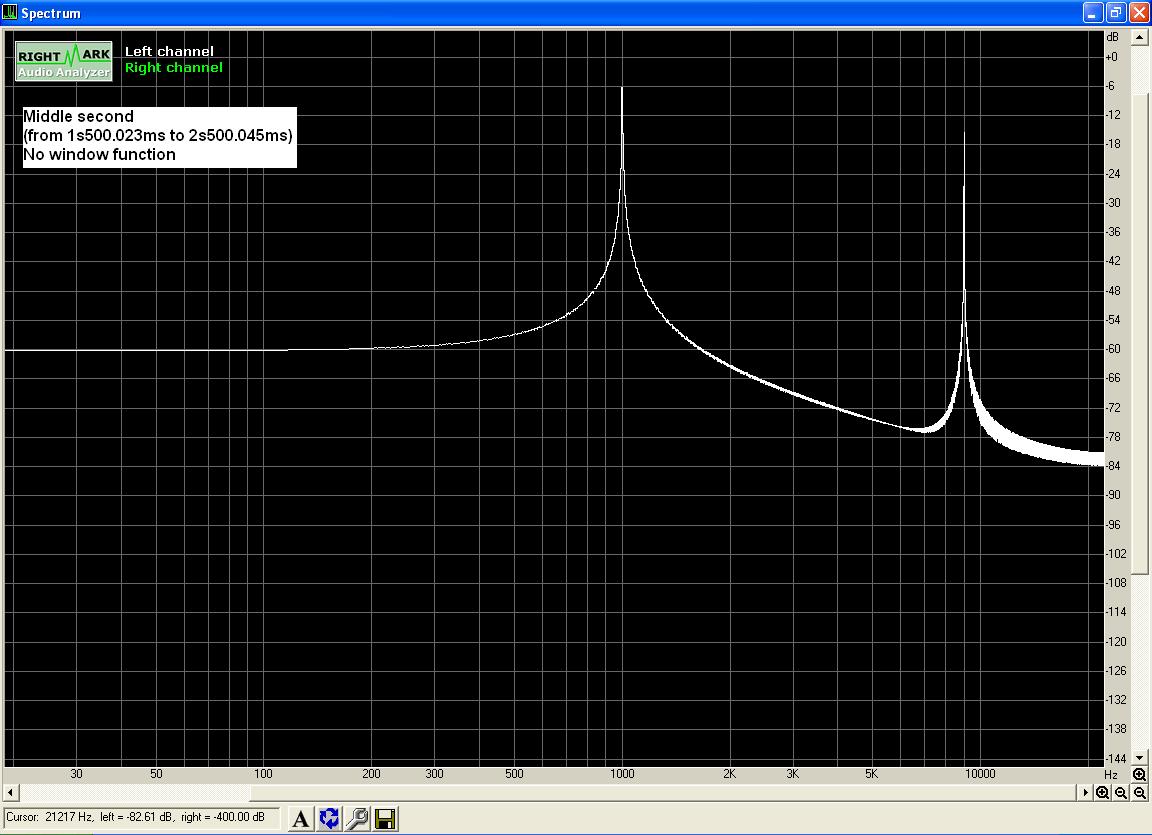

Thanks for the offer. I fixed the problem with RMAA 5. Now it works

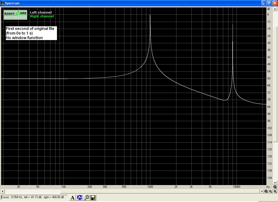

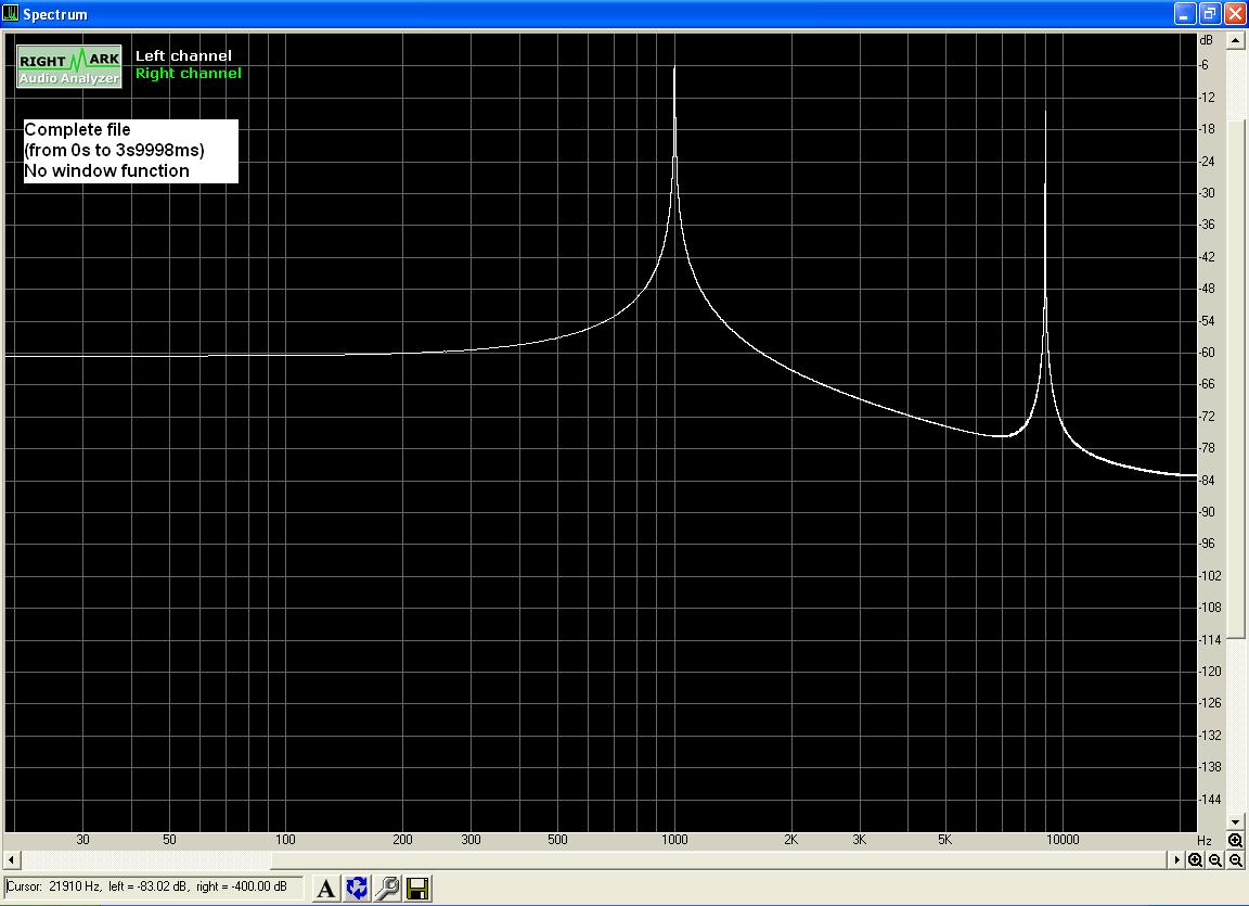

I did a wave file with the 1st second, one with the last second and one around the middle.
I can not hear any difference in sound in these three files. Nix (par the click in the middle).
Attached are the FFTs from the original complete file and from it’s 3 parts of it.
I don’t see any much difference in there. The 9kHz peak is exactly 10dB below the 1kHz peak on all of them.

The tick is a gap in the waveform at zero level where we switch between the phase shifts.
Now you drive me crazy ! :headbash:
Can you please specify the exact location (from the start of the file in ms) of this bloody gap ?

George the previous post shows it. The click is because the reproducing software has inadequate bandwidth, but if the expansion software you used is not the same as mine it may eliminate it!

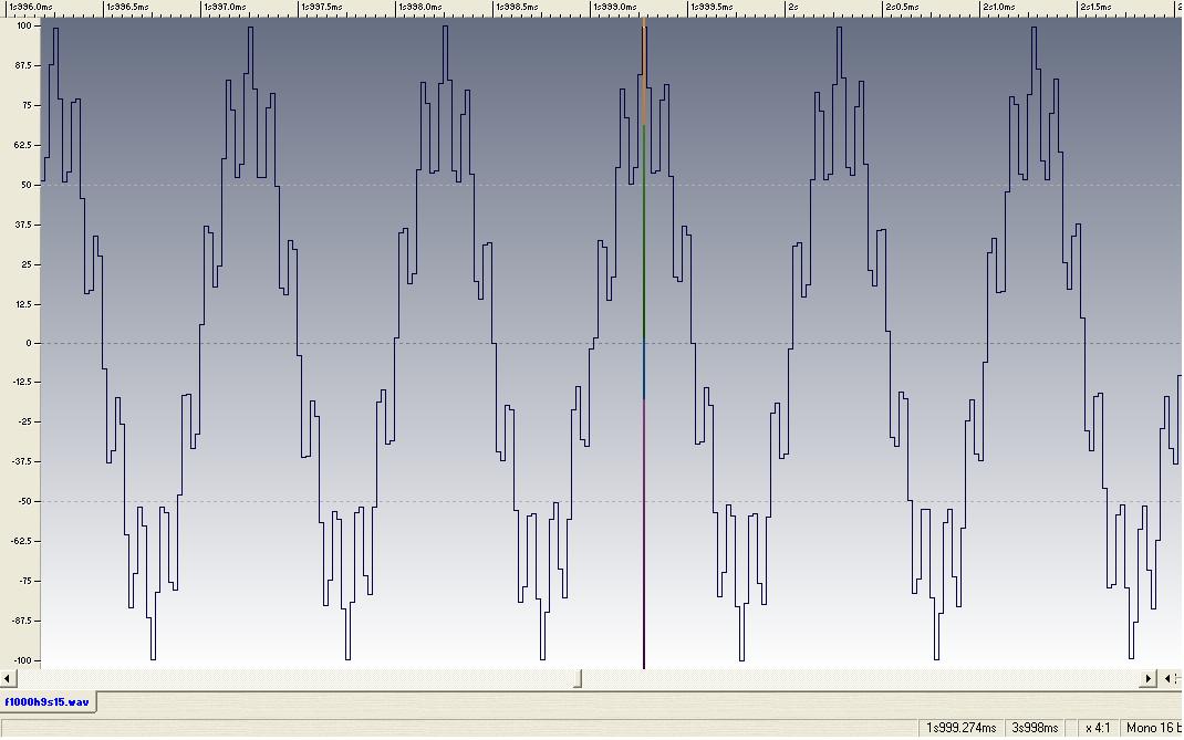

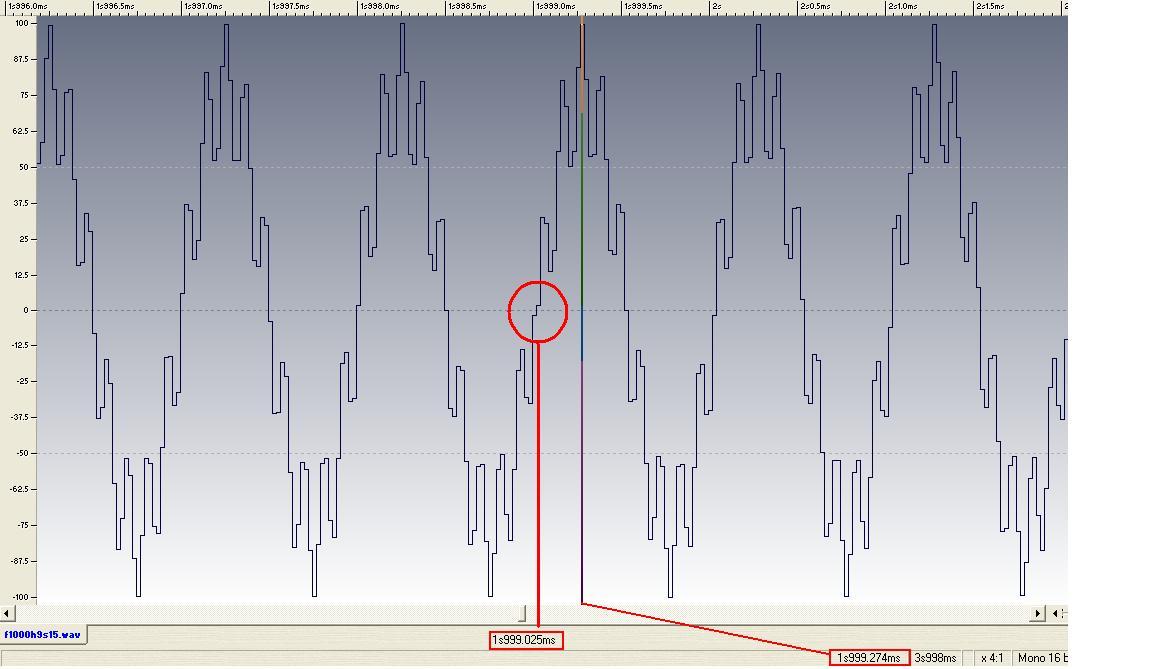

I hope you mean this (BV post):
http://www.diyaudio.com/forums/attachments/analog-line-level/236186d1313768164-john-curls-blowtorch-preamplifier-part-ii-wav1.png
Good then. It is at the place I had located the difference in pattern. http://www.diyaudio.com/forums/attachments/analog-line-level/236133d1313749778-john-curls-blowtorch-preamplifier-part-ii-click-4.jpg
But I really missed the cause of it (the “gap”). Sniff
Lesson learned (Mind the gap) :)

But I would like to ask you about the “tick”. You wrote : “The click is because the reproducing software has inadequate bandwidth
Have you heard it through a software without this bandwidth restriction? If yes, what’s the bandwidth and how it sounded (or it didn’t sounded at all?)?
I am afraid you are opening a can of worms with this. (the “gap” has a width of one digitisation step at 44.1kHz.) SY is gonna haunt you:D

No you are in the game because your results are honest.
The basic trick in the days of tape was to use a small magnet to erase the signal when you made a splice so that you wouldn't hear it. It is my OPINION the reason you hear a click at 1 sample for 1 LSB is that the player has issues. After all you can hear that and not the larger difference in the waveforms.

By the way, the click is 1 sample wide but it is not only 1LSB high. It’s amplitude is 1% of the 1kHz (peak to peak) waveform.
