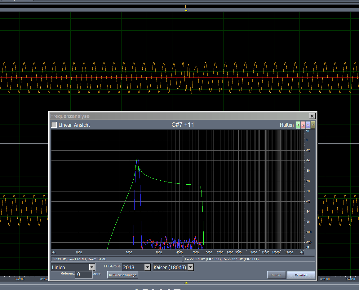

Good Morning,
I fiddled around a bit with Ed's "nyquist buster" and have to say from listening impression and signal analysis I'm tempted to have another opionion about what we actually do hear as the dominant effect (the blip at centertime).
What I did :
- upsampling to 176.4k and back (high precision, in Audition), gave the expected result, slightly different sample values around the blip coming from the brickwall, also seen in the spot FFT.
- there was no difference in sound when playing back the original and the brickwalled version (maybe not finally conclusive, though).
- to better audition the blip I overrode the sample rate of 176.4k with 44.1k (times 4 pitch downshift), it sounded exactly the same, just everything lower in pitch.
- next I filtered this with a 16th-order linear phase linkwitz-riley highpass @ HF tone (which is @2250Hz now), the effect can be seen in the attachment and it also sounds like this, the blip, now with symmetrical moderate ringing from the filter.
In my opinion we only hear the result of the phase shift from the discontinuity, there also might be a standing wave pattern issue in the ear canal resonances, too (I have experience with the sound of sudden phase changes at LF where room modes can vastly influence the percieved effect. Also psychacoustics play their role, the steady-state signals are quickly interpreted as non-important "ambient noise" which makes any changes more pronounced in perception.
With filtering at slightly higher freq we can expose the pretty dirac-like blip even more.
Any conversion artifacts would only be on top of that.
I've attached the brickwall filtered version, too, for those interested.
- Klaus

Klaus thanks for your efforts.
Ed’s explanation for the tick (click) we hear has got me thinking as well
I can not reject it though.
I have made a thinking here http://www.diyaudio.com/forums/analog-line-level/146693-john-curls-blowtorch-preamplifier-part-ii-1514.html#post2678028

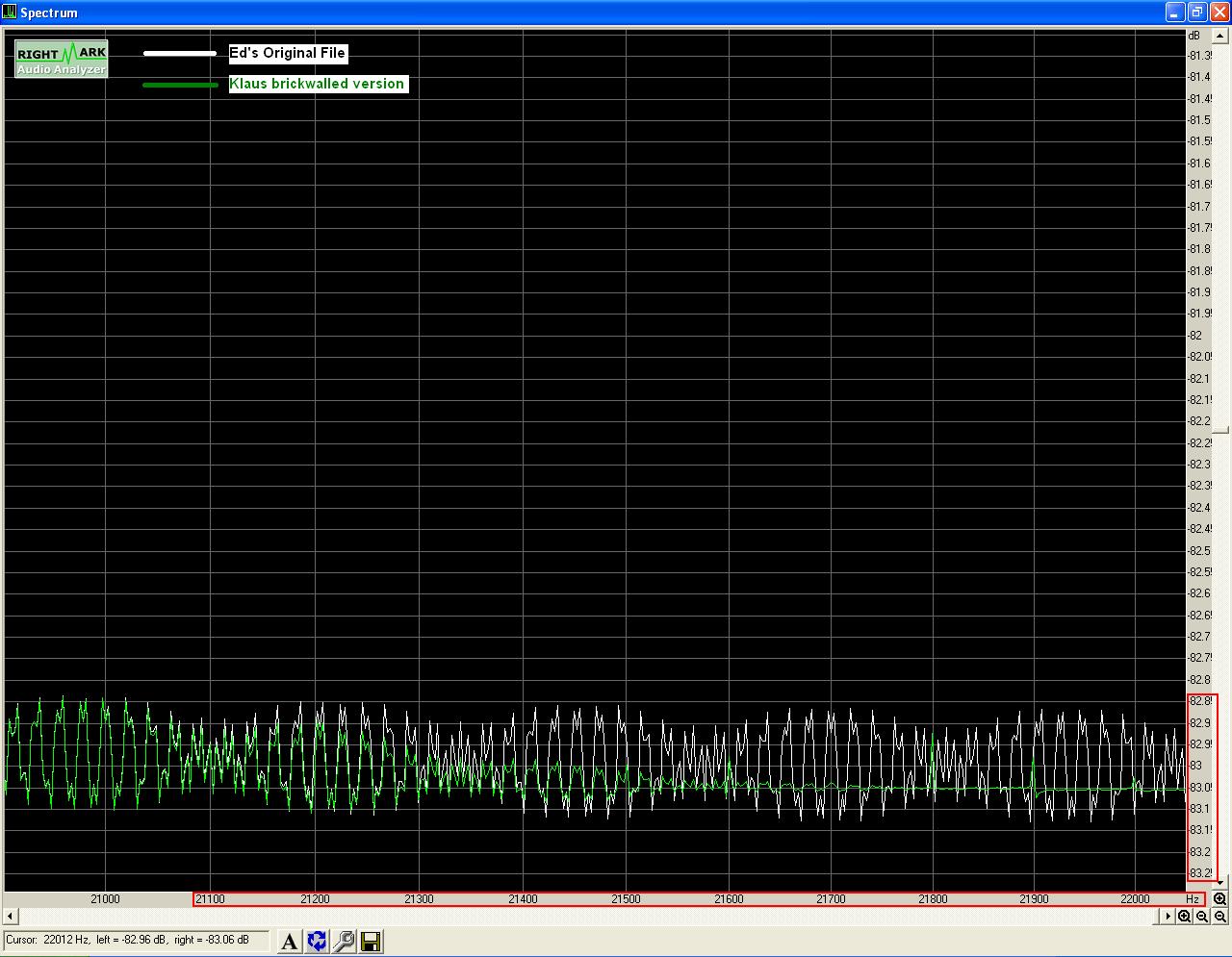

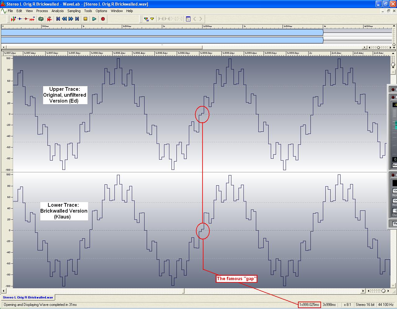

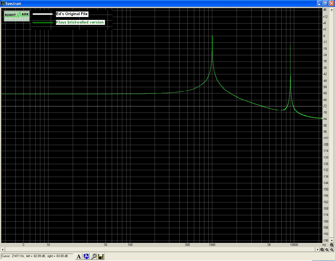

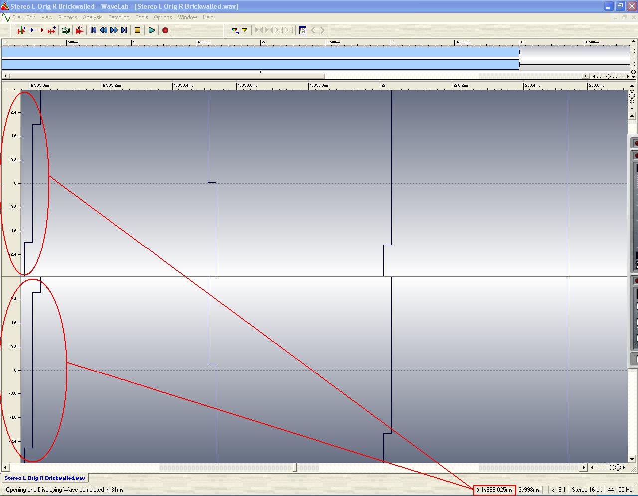

Now, I heard your brickwalled version. No difference to me as sound timbre is concerned. The tick is still there
I made a new stereo file. On the left channel is original Ed’s file and on the right channel is your brickwalled version.
I run an unwindowed FFT with RMAA 5. (att.1) There is not the slightest difference btn the two versions up to 21kHz. (att.2)
After that, I checked the waveforms visually (att.3). To my surprise, on your brickwalled version, some step changes were slightly reduced in amplitude, but the “gap” step change was slightly increased (times 1.303) (att.4).
This must be a heck of an Ed Simonic
“gap”
Regards
George

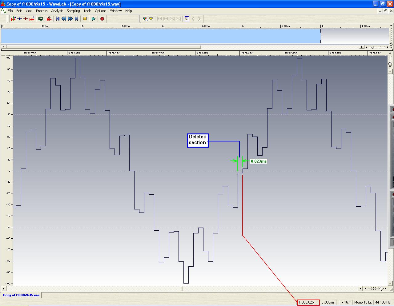

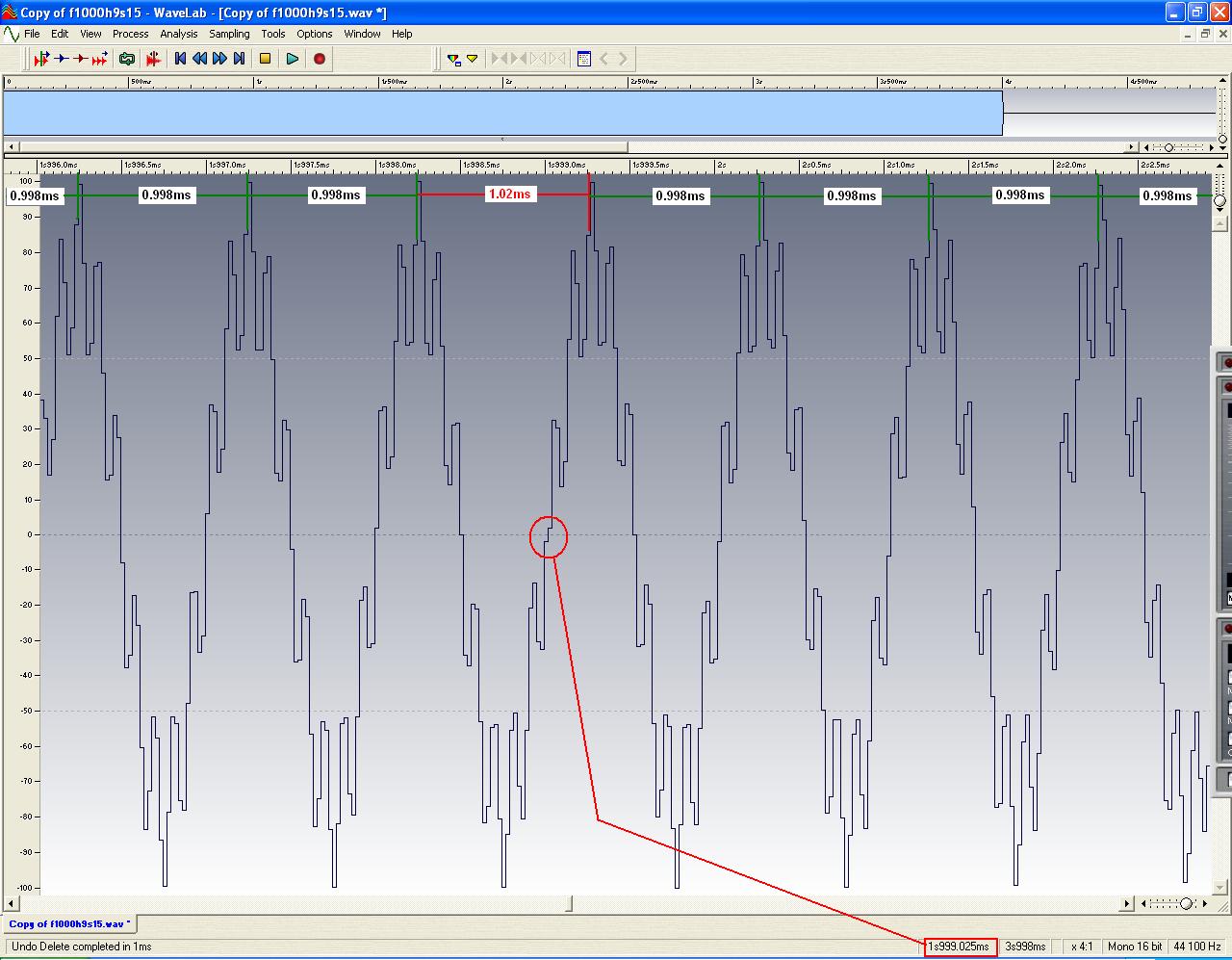

The gap issue has took me many hours these days (PS).
What Klaus proposed that happens seemed good to me.
So I set out to test this explanation.
I opened the original -Ed’s-wave file and measured the time period between the top of the 1kHz waves in the vicinity of the area where the gap is.
The finding is that before and after the gap, all the 1kHz waves are 0.998ms apart (some are 0.997ms).
It is only one wave period that differs from all the others. The one with the gap.
This one is 1.02ms away from the previous one.
I deleted a time period of one digitization step (0.023ms) from the area of the gap.
Now all are equally spaced.
Listening to the resulting wav file (attached in zip format done with “Winzip 8.1”), I hear no click any more.
Regards
George

Excellent!
I find the difference is now easier to hear. Decent results with one computer loudspeaker.

At the FFT snapshots I showed there http://www.diyaudio.com/forums/analog-line-level/146693-john-curls-blowtorch-preamplifier-part-ii-1515.html#post2678353 I didn’t see any difference on the three parts of the file (first second of the file, last second and middle second which includes the gap and the abrupt 60 degrees change in phase).
Does this mean that FFT can’t resolve phase related issues, or did I just performed it in an improper way?

Neither, you just didn't ask it the right questions.

In the first part of the file, what is the magnitude and phase spectrum? Same question for the second half. You don't want to look at the portion around the discontinuity- that will give you nonsense data.
It's certainly easier to look at the original waveform, but you can always do an inverse FFT to recover that if all you have is the transformed spectrum.
