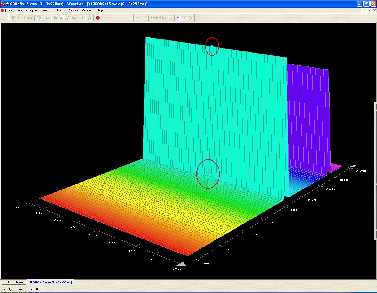

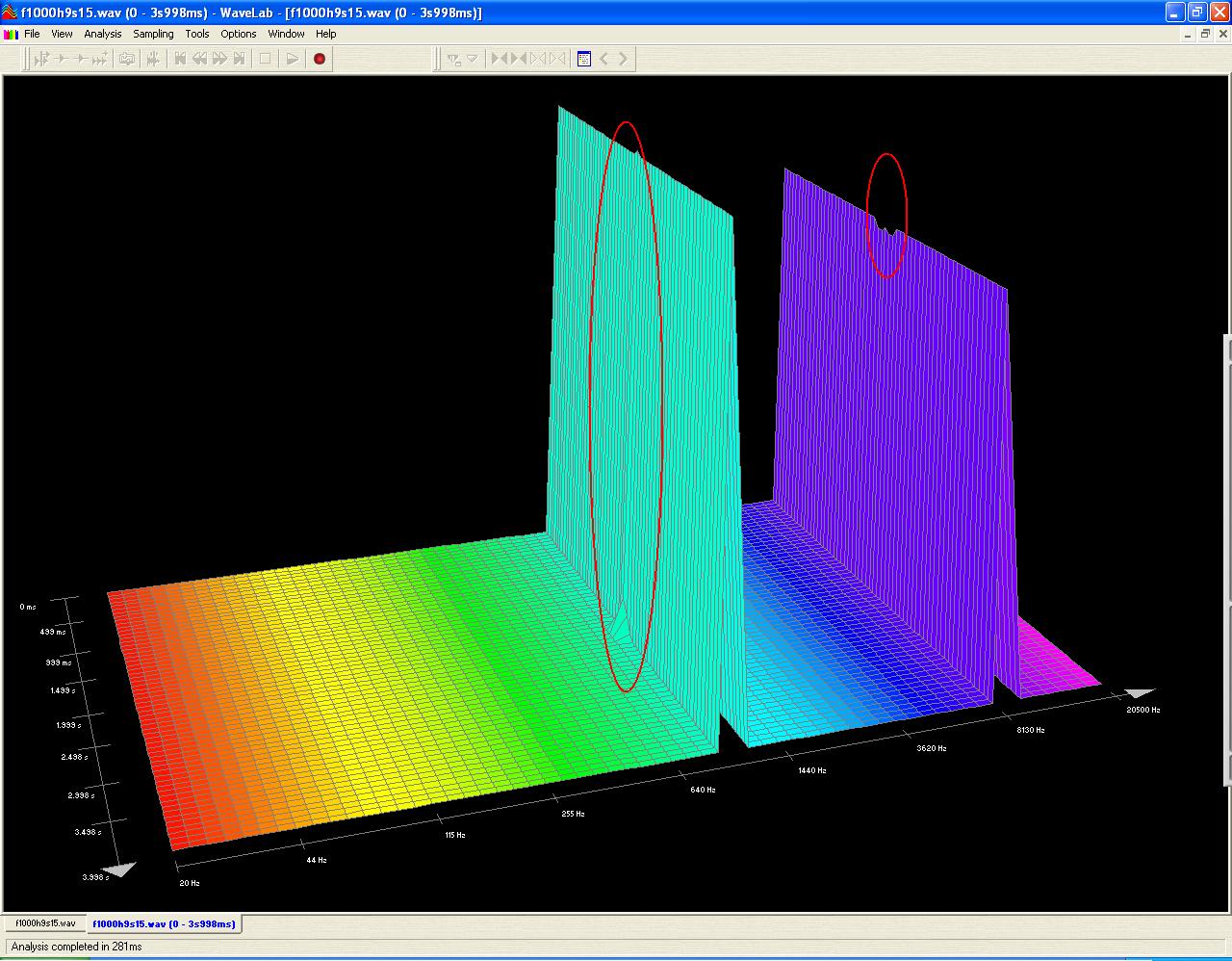

I know that it isn’t what you are asking for, but below is a 3D representation of the 3 files.
At.1&2 are original Ed’s file.
Att. 3&4 are Klaus brickwalled version.
Att.5&6 are gapless version.
Vertical axis is amplitude (linear)
Regards
George

The click is gone, and my ears must be really shot if others hear a difference between the two halves. Because I don't.
vac
in gpapag's file tick is not completly gone. Not audible, but visible on spectogram or spectrum analyzer. There is still audible difference between first and second part of the file, which can be described as some added high freq pitch or kind of extra harmonic component added or more harshness, like Ed Simon described. But less and harder audible in Gpapag's file (without tick) and easier audible in Ed Simon's file (with tick).
There is another difference between files. In Gpapag's file (without tick) right in the middle of the file, there are some audible anomalies. For the fraction of the second, sound is "wawing". Kind of Doppler effect, hard to describe, like source is moving forward/backward, but only for the fraction of the second.
In Ed Simon's file (with tick) this "waving effect" is not audible. Masked by the tick?
Please listen to both files and tell me that my ears are playing games with me. I would be happy to hear this, since those differences are puzzling me.
