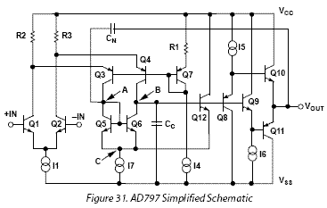

AD797 decompensation pin
Scott, is pin 8 (decompensation) connected to the output of the VAS/input of the unity gain buffer? I thought that pin 8 is low-impedance current mirror input (point A Figure 32 page 11 AD797 datasheet)
I might remind you of who provided the extra pin on this and the AD744.
Right, I still don't quite understand exactly what Dick did, no comment in any case.
Why don't you ask him, Scott. You two are friends, so I have been told.
At times I tire of this anachronism. This dabbling becomes tedious and boring.
Scott, this is the situation. Dick Sequerra made a phono preamp that is competitive with my designs, with your AD797, several years ago. He is still happy with the design. He told me that he ran it 'open loop' because he does not like the sonic compromises of global negative feedback. As a competitive designer, I have never personally asked him exactly how he did it, and then I came to a tentative conclusion that your 'extra' pin must be, as well, an open loop frequency comp connection. Then, all that would be needed is to use the pin to create an accurate RIAA contour, and I left it at that. However, later looking into that 'pin' it is NOT located properly to do that. So what did Dick Sequerra do? I thought that you might be interested enough to ask him, as you used to be good friends, wine buddies, and all. If I were you, I would ask him. Perhaps, if you won't, I will, sometime. I am curious about it, but I thought it was your place to ask first, perhaps.
One approach is to deliberately put a DC offset of about 80mV across the input pins. That will reduce the open-loop gain to about the right amount for an MC front end, and make even-order distortion strongly dominant.
DC offset can be fixed by a servo acting on pins 1 and 5 via high impedance. I presume those pins are connected to the emitters of Q3 and Q4 or something equivalent in the real circuit.
The response will roll off 6dB/Oct across the entire audio band so RIAA Eq can be implemented with a simple RC network after the AD797. Pin 8 could be used in the normal way to reduce output stage distortion, if desired.
If the DC offset at the input is made variable, that could be used as a gain control to cater for different sensitivities of cartridge.
I also made the AD745 null network in a very eccentric way so that the feedback to the null pins trick that Walt was very fond of works optimally. It makes a nice open-loop amplifier or RIAA.
