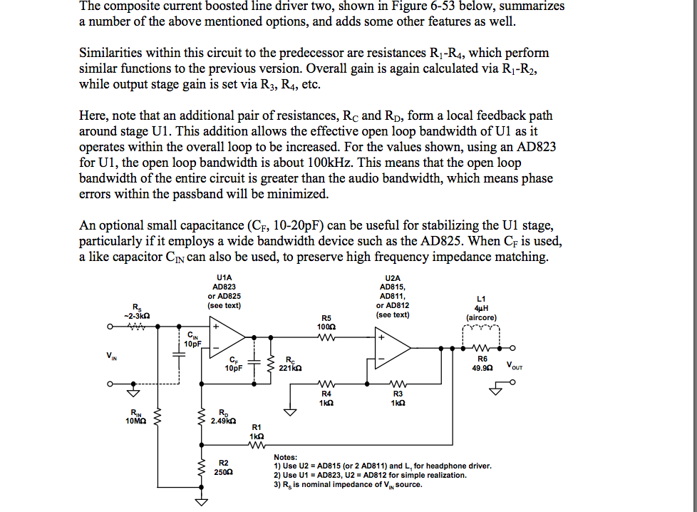

Yes, there is the cryptically named myrefc which combined a mediocre op-amp and a chipamp inside it's feedback loop. Some swear by it, seeing what it takes to be stable and what the main op-amp is I am not as certain.
Ciao T
Here we go ....
Has this ever being tried with power amps ?
Ciao T
As the Putzeys article explains, "nested feedback is functionally equivalent to global feedback." What you describe seems twice as hard as designing a single amplifier with proper feedback.Can not an amplifier being made with two amps in series. The first one has feedback to define a certain "open loop" bandwidth and the second one providing feedback over both ?
I have looked several times at the JC3 circuit before. Now i realize that there are two feedback loops and how innovative it was at that time. Anyway, i bring this up because i thought it satisfies both the high feedback camp plus the ones that claim high open loop bandwidth is necessary.
