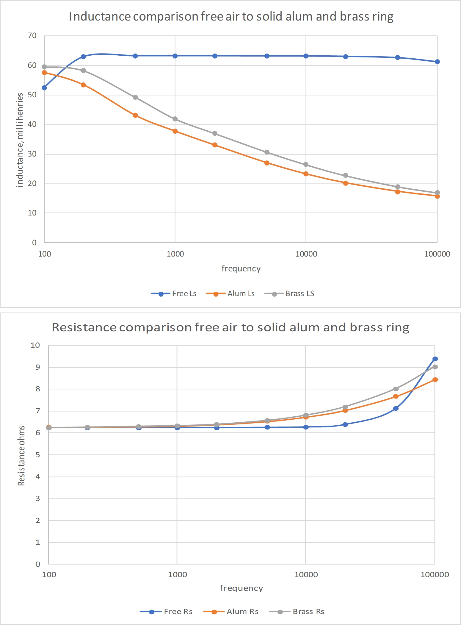

From what I've seen, skin resistance and eddy currents always shunt total impedance magnitude, not increase it. So when you compare a shorting ring to no shorting ring, you will always get lower impedance despite the increased resistive losses from skin effect. An increase in total impedance is only seen if you deliberately compare a real shorting ring with a perfectly conductive shorting ring.
Your inductive reactance may be 100 ohm, and your skin resistance 1kohm, but the skin resistance shunts the inductive reactance so your total impedance will decrease rather than increase.
If there are examples where eddy currents or skin effect increase total impedance rather than reduce it, I want to see them.
If you examine my first inductor/copper tape test, you can see that the total resistance of the coil as seen by the meter increased very significantly with frequency while the L decreases.
The same occurred with the tweeter coil and shorting rings.
The Ls/Rs model is the best to use for these values of L and R. Do not confuse it with an Lp/Rp one, as you will go crazy trying to keep a mix between the two.
Any coil being driven with AC excitation by a meter in Ls/Rs mode, when a conductive object is introduced into the time varying field, the response of the meter will be to show Ls decreasing caused by the magnetic fields of the eddy currents, and the Rs will increase as the meter sees the loss as an increase in the system resistance. It does not see the eddy losses in parallel to the primary wire resistance.
I have re-attached the two jpegs being discussed, for clarity.

I guess the reason for using Ls/Rs is that you can calculate voltage drops separately according to current, whereas Lp/Rp requires a known voltage instead and gives parallel currents instead of series voltages.
That too.
The HP manual recommends which to use, who am I to argue??

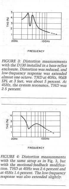

No, it is not, there are no universal cures, all distortion causes have to be tackled in parallel, like they did at Purify. Again, all this (partial) current drive can do is tackle the distortion of which the cause is impedance modulation. And this is not as far as I and others found a major consituent of driver distortion.

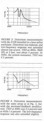

It works very well for the bass driver distortion reduction as I showed in 1985 amp mod at #28935 For bass in particular it is a universal cure.
![Marsh Graphs.png Marsh Graphs.png](https://www.diyaudio.com/community/data/attachments/708/708980-24acf7cd4fbc30db2968cdc37dbd176b.jpg)
The two distortion profiles are significantly and usefully different. The Marsh version shown has usefully lower distortion where it matters in the foundation tones of the music. The graphs are just one example of one 15" in a bass reflex cabinet perhaps not optimised to the Marsh amplifier. Getting rid of the normal 'double humped' bass reflex distortion characteristic in the 40-60Hz area would be of great benefit and for the price of a resistor and and some minor rewiring it's surely worth a try. Dan.
I disagree and the measurements show it is major contributor in bass region. Espec in region of LF resonance.
