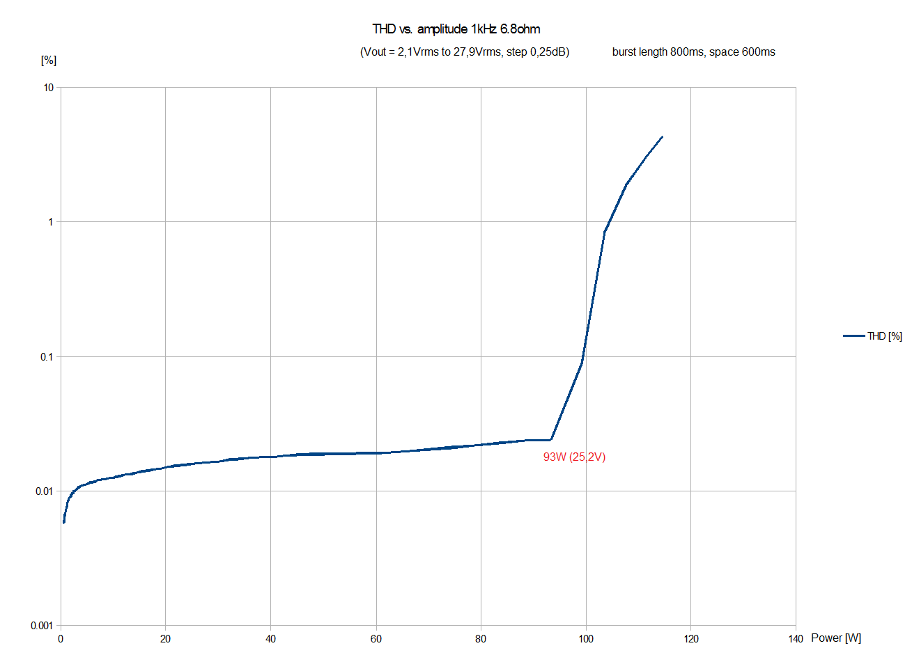

Hi PMA
Do you have the waveform saved so you can show the severity of clipping for the measurement?
Would it be possible with a metric on clipping, perhaps power from spectrum weighted with increasing frequency. Then multiplied with "blocking" time. Problem might be at wich powerlevel.
/örjan
Yes I have. Give me some time, please. Clipping occurs in last 4 columns. Other transitions are digital/soundcard issues during on/off. Fast digital scope is much better to catch on-off transients. I have it as well.
Hi örjan
here is some analysis that I can dig out from the saved wav waveform.
Measuring conditions:
- sine bursts 1kHz, stepped amplitude from 2.1V to 27.9Vrms, step 0.25dB
- load 6.8ohm, i.e. power 0.65W to 114W
- each burst length 800ms, each space length 600ms
- clipping starts at 25.2V/93W (at THD = 0.024%)
- 1% THD (usual specs value) at >100W approx.
Attached is a THD/power plot and also time plot at maximum level measured (114W) that shows PSU ripple 100Hz modulation leakage into output voltage. At clipping points, feedback looses its control and we can see big reduction of amplifier PSR.
Nothing more to dig out at the moment. The analysis is semi-hand made and extremely time consuming, analyzing burst by burst, so further suggestions will not be accepted, if they are not really revealing ideas.
