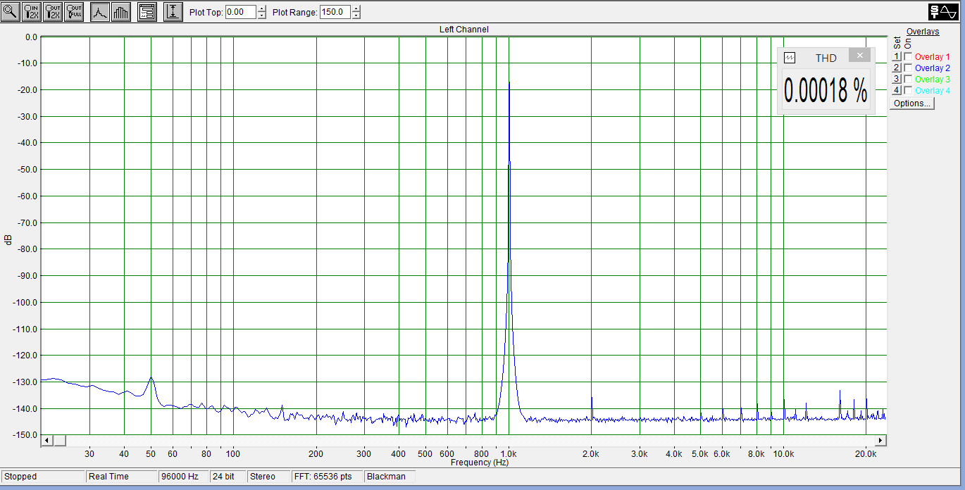

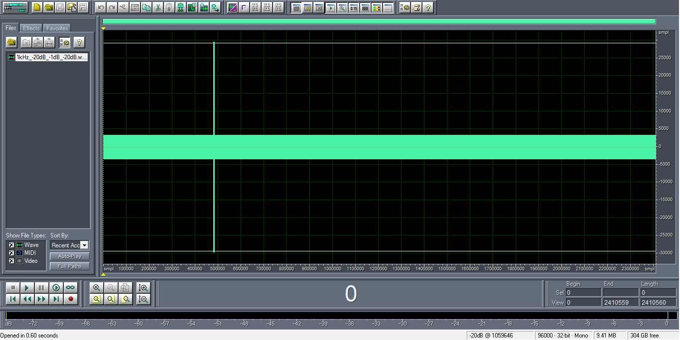

My idea is to have a test signal at low level (-20dBFS), total length of some 25s, which is at one moment changed to high level (-1dBFS) of short duration (now 50ms, to be tuned). This would make a short term thermal transient. Distortion of the low level signal would be measured and examined if it changes with time after the high level is turned off. There would be enough time for FFT. The envelope would look like this:

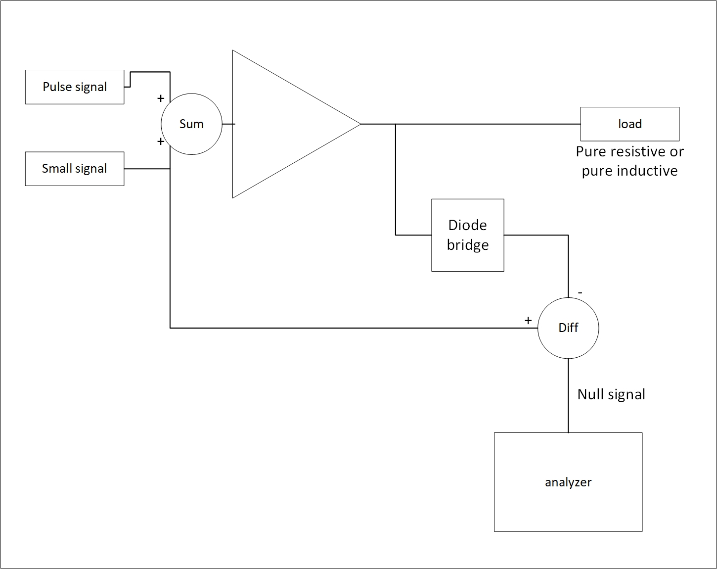

How about feeding the low level signal into a summing block to the amp, and also feeding the low level into a differential subtractor of the amplifier output, heavily into null. The high power tone gets injected only into the amp, and the amp output goes through a bridge limiter to prevent saturation effects into the differential circuit. block diag to follow...
I see you noted below as I was drawing...here is my thinking for others..the diode bridge is a very very fast limiter, sometimes used as a gating circuit...if anybody wishes, I can draw it up. one of it's advantages was to prevent scope input overload, as some circuits take time to recover from excessive input transients. I first saw it on a high speed sampling scope, it was used as a sample gate.
Note I also mentioned pure resistive and pure inductive loads. That allows selection of quadrants 1/3 alone, or operation through all 4 quadrants, where dissipation is significantly different.

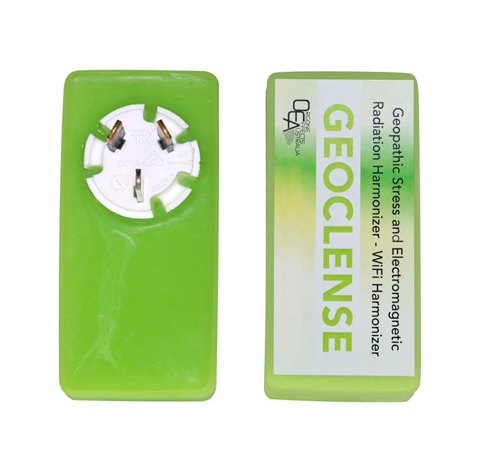

![Geo-clip-103.jpg Geo-clip-103.jpg](https://www.diyaudio.com/community/data/attachments/718/718397-5fdfdd90ffa62ca94d8f74841b343f15.jpg)
I borrowed one of these Geoclense units from a friend of a friend. The intended purpose is to 'harmonise' the radiations from household wiring. Turns out when plugged into dual wall socket supplying any audio gear the sound changes with marked (resonant) increase in bass. Just sayin'.

So nothing, yet. A "steady state" or suddenly changing in level and duration makes no difference. Negligible. Frankly, I was expecting this a bit. Maybe some non FB circuit might show some changes with these "non steady state" signals. It also indicate that complaints to so called "steady state sine wave tests" are in most cases based on no evidence, just on "feelings" and opinions. I also used a notch filter to magnify the residual, again, nothing. All negligible, only notch filter settling. No changes in harmonic profile and amplitudes.

Don't forget PMA's FFT averages out noise, so no visible change would be expected if there were only a brief noise increase following a transient. The test that was shown was a test for nonlinear distortion of the input signal.
If there were a transient induced input signal distortion effect it would be weighted in the FFT according to its time duration relative to the FFT acquisition time.
Geoclense Just sayin'.
Bioplasmic Radiation (Human Generated) imprinting produced by…
Juvenile emotional stress
Illnesses and diseased organs
Death imprints/” Paranormal” Activity
Previous occupants’ emotional distress
Negative psychic impressions/Psychic attacks
Solar and Planetary Radiation imprinting produced by…
Planetary Retrograde influences
Beta Gamma from X, C & M-class Solar Flares/Solar Winds
Beta Gamma Radiation from Cygnus X3 for people in the Northern Hemisphere
At least you don't have to worry about the last one
Reading through the whole thing, stunning in fact almost worth the $99 to take one and show that there is probably nothing inside it.

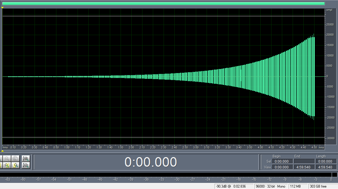

I tried all possible and impossible combinations of amplitudes (from noise to full scale), lengths (hundreds of ms to tens of s), signal/space (noise) transitions etc. Nothing interesting is happening, the "non-steady state" signals give the same results as "steady state" signals. No problems with sudden change of amplitude. Much more severe conditions than with any kind of natural music signal. Nuts.
I do not have any "lousy" consumer amplifier here, mine are rather overdimensioned in heatsink capacity, so they have no thermal issues under any signal conditions. If the amp had problems with dynamics, I would probably recommend to throw it away.
This is one of the signals.
