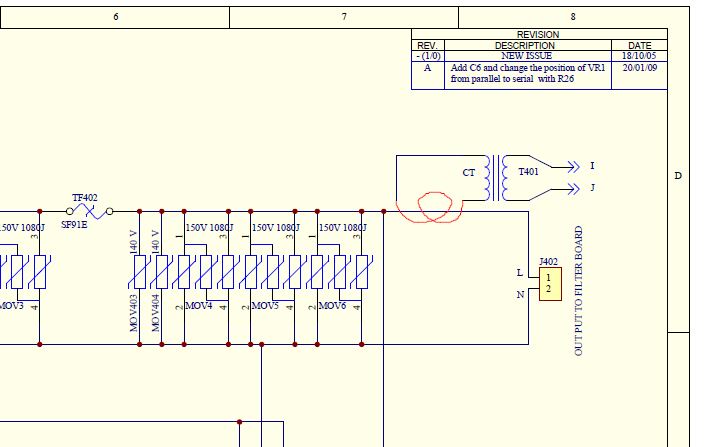

Of course you all know lightning strikes nearby induce a CM signal. So, you convert CM to DM and then eliminate it via MOV. L401, C401-C402 perform transient spike signal conditioning before the MOV. This helps extend the life of the MOV and reduces let-thru. To see the whole picture, you cant look at a single component... a network analyzer and HV transient generator is needed for proper evaluation.
Since this is not a consumer forum so much as design issue forum, I will say that the protection is not only for transients from lightning but also taking into consideration sags and surges on the utility lines and how they are handled is part of the design.
On the models with special isolation transformers, the protection from transients is mostly for the circuitry within as no transients get thru the transformers. Demian Martin can attest to this as he did the UL type transient testing during prototyping.
Of course with or without the isolation transformers, the LP filters greatly attenuate any transients making the MOV's primarily in a surge protection roll, only. Except at the input as discussed above.
THx-RNMarsh

Demian,
I'm glad that Richard posted the schematics here. Now you can have the one that he told me to not share with anyone. I'm trying to recall what you mentioned about the HTPS 7000 MKII, in page 1, 7D of he schematic. Something about the ST and the red wire in the upper right?

The item in the corner is a current transformer for the current measurement system. Its not drawn right and the red wiggle is supposed to show where its in the circuit I think. Also in the MK2 schematics the isolation transformers are missing. The key difference between MK1 and MK2 is that the center taps of the isolation transformers are switchable. You may get better performance with the center tab grounded or open. No way to predict really. And the GFCI's on the outputs are also not shown. The coax surge suppressors are missing the gas tubes. None of this should slow anyone down who could deal with one of these beasts.

For DM surges the MOVs shunt the surge. For CM surges opposed by L401 the MOVs are in series with the surge, they can only drop it's voltage by 150V or whatever their limit voltage is. And C401 lets any CM surge through anyway. So it's hard to see how this can be effective against CM surges unless they are low voltage surges.
Where is the CT switchable in the MKII? Also in the MKII Didn't multiple diodes replace the gas tubes? Or am I look at the schematic incorrectly. Wasn't there just one tube in the original and MkII with diodes?The key difference between MK1 and MK2 is that the center taps of the isolation transformers are switchable. You may get better performance with the center tab grounded or open. No way to predict really. And the GFCI's on the outputs are also not shown. The coax surge suppressors are missing the gas tubes.
The gas discharge tube has lowest capacitance and also higher capacity. Its placement within the 75 Ohm cktry of pcb layout is critical for frequency response > 1Ghz without selective freq atten.

Note: There may be errors and/or omissions in schematic. It is suitable for trouble-shooting.
