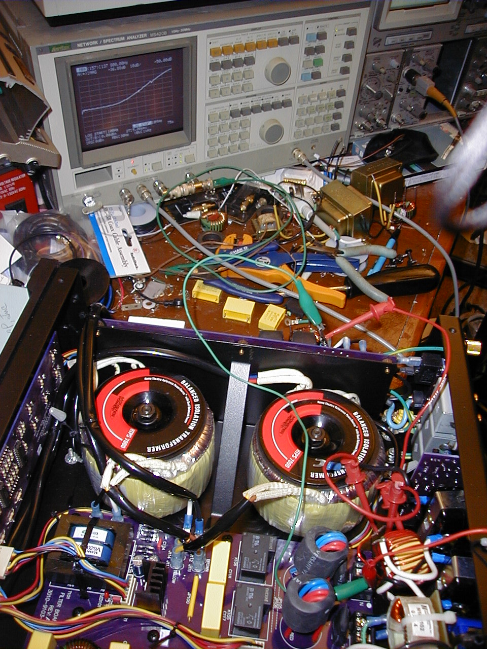

John,
The Blowtorch uses R core transformers, L and C passive filtering, and three stages of electronic regulation and filtering: a series regulator, shunt regulation, and a local cap multiplier. Do you hear the effect of a quality line conditioner, or line cord, or AC Bybees even after all this effort to isolate the active circuitry from line and load variations. Yes there will be a bun fight whatever you say
The CTC Blowtorch preamp actually uses a low capacitance E-I transformer for each channel and gain section, so it uses up to 4 identical transformers in its power supply case. Two for line, two for Vendetta phono, if added.
We add a common mode choke, hi speed diodes, and multiple capacitance in each as well, then we apply 3 stages of active filtering, first an IC for hum suppression, then a discrete fet shunt regulator for transient suppression, and finally a fet based cap multiplier that is on each gain stage. We don't use MOV's so we could be subject to lightning based surges, but we have been lucky so far.
As far as line conditioning is concerned, we often feel that less is best, IF POSSIBLE. When I do add line protection externally, I usually use a 10uf 600V polypropylene motor start cap directly across the power line (fused of course) and a gas tube transient suppressor that has direct circuit breaker protection. A gas tube will not turn off without manual reset, so this is necessary. There are 100's of these units out in the world without any significant complaint, as Bybee once made these units commercially, about 20 years ago. I do use a line conditioner, but it is a very exotic unit from Bybee, and I do not really understand its operation.
This is a different approach from Richard and Demian. Their approach is 'brute force' and all situations covered that can be very necessary and useful. Jack's and my approach is 'simple' and perhaps exotic. It seems to work pretty well too in many cases.

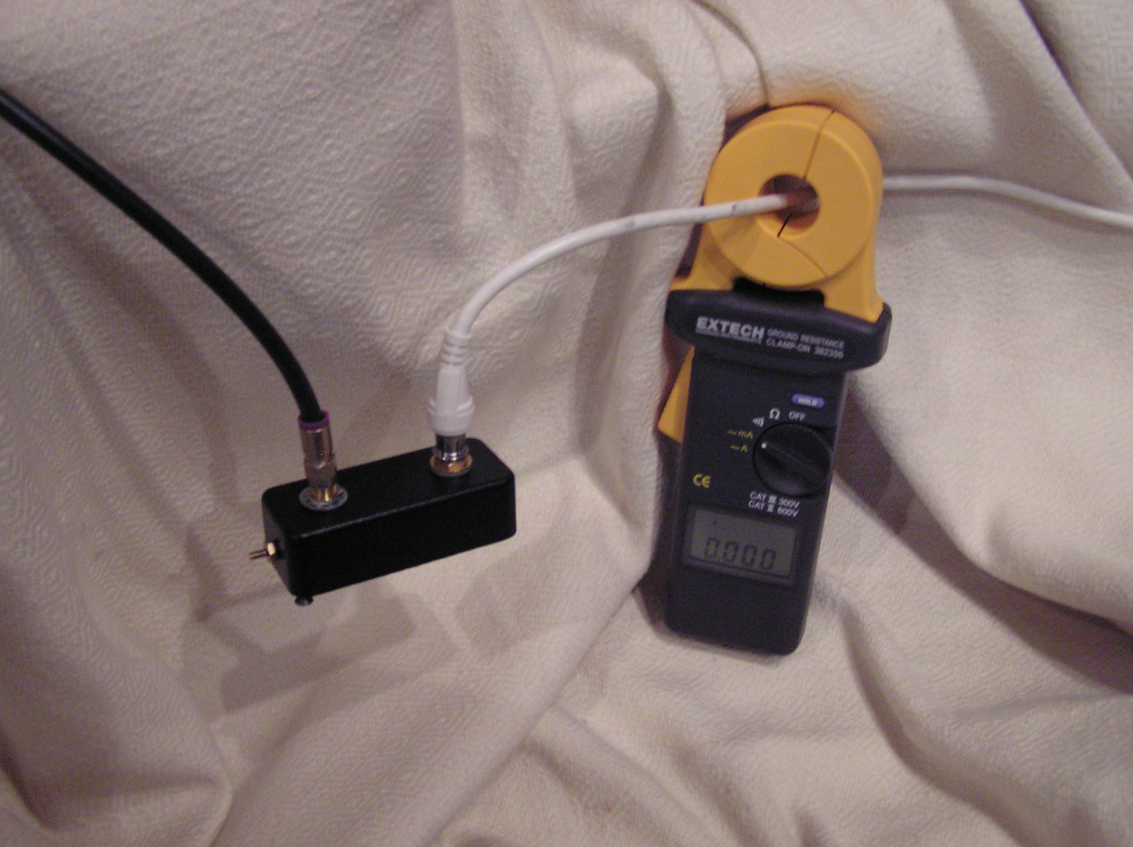

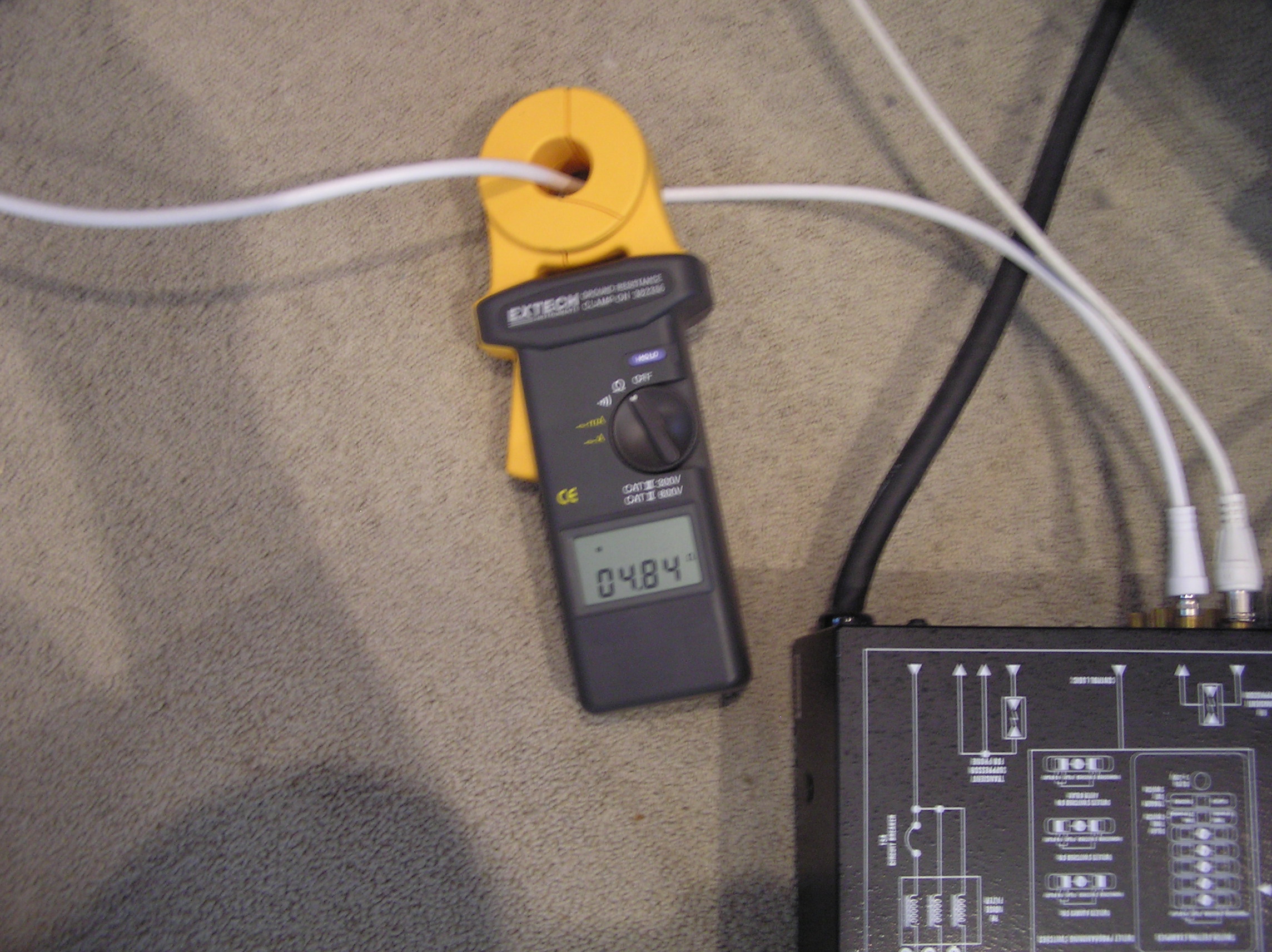

How much current can flow thru such multiple point grounds? My house has such older type grounding and so is measured as an example for you. Shown is 4.84 mA.
![GND Current loop1.JPG GND Current loop1.JPG](https://www.diyaudio.com/community/data/attachments/721/721965-a0270e61a5ef9baf3ff862ef9e42ce78.jpg)
Those homes will need a CATV ground breaker installed in series with the CATV coax cable.
![GND-Loop suppressor 001.jpg GND-Loop suppressor 001.jpg](https://www.diyaudio.com/community/data/attachments/722/722165-1e2c7253fce42232d00a902fd6c67d29.jpg)
Often audio systems alone are fine but when a video system (home theater) is added, the multiple ground issue causes hum and interference and the sound is not as clear as before. This is why.

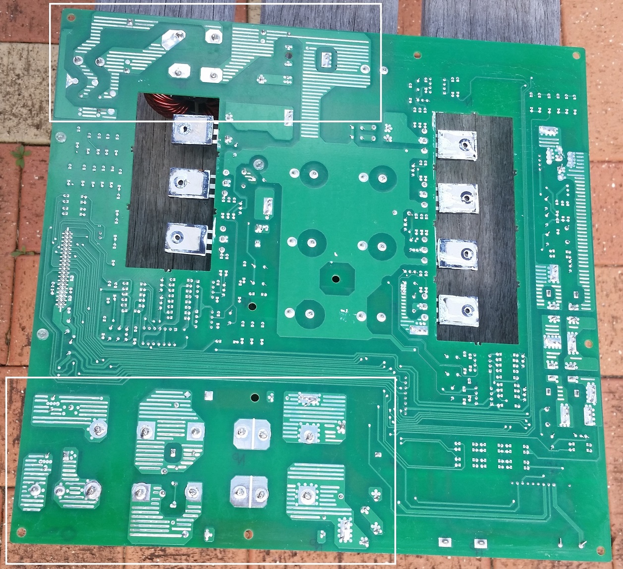

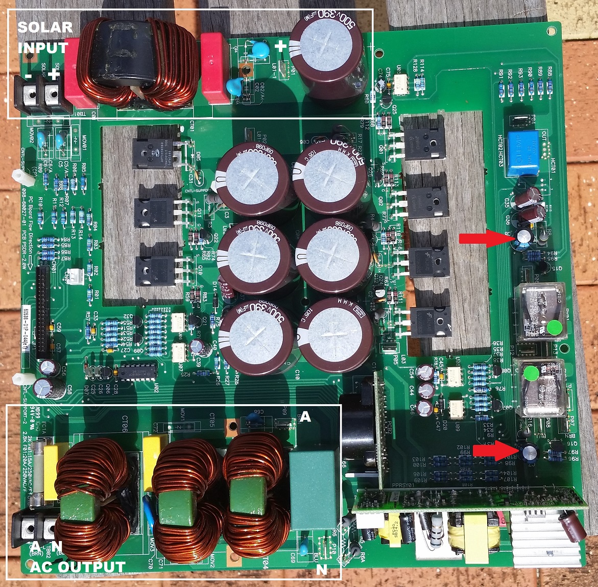

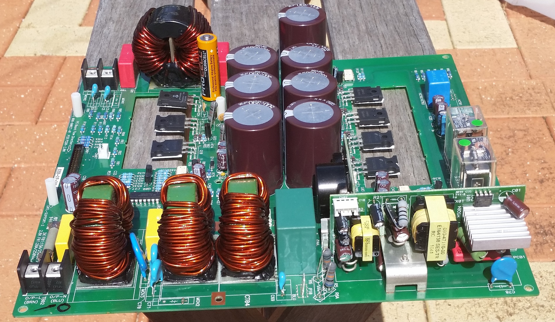

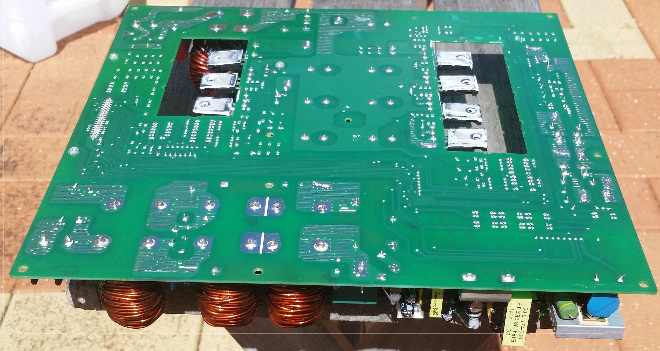

The annual local area verge recycling in underway and this wrecked solar convertor pcb was free for the taking.
This board contains useful filtering/protection stages and is ideal for removal of these pcb areas for DIY power conditioning stages.
This is one example, plenty of modern gear has high capacity line filters in particular air conditioning outdoor compressor units and washing machines.
AA battery for size reference in Pic 01 and red arrows in Pic 03 highlighting failed/vented electros right next to 2W resistors dropping relay coil voltage... exactly this arrangement is common fault, in audio caps too close to regulators is common also, when will designers learn !.
Dan.
Dan.
