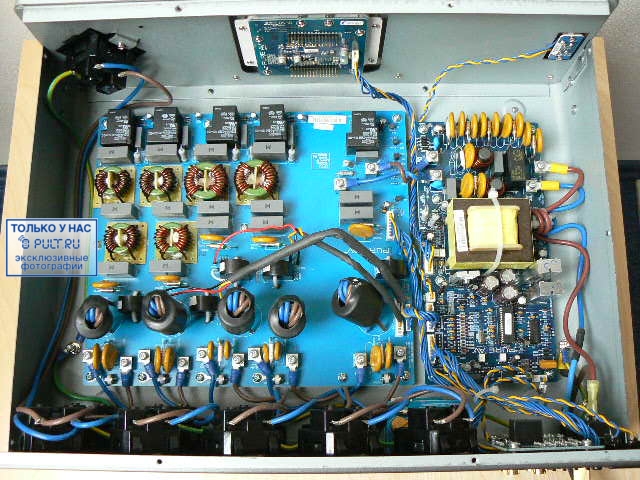

Thanks Richard for posting the info. I used to have a Belkin Pure AV filter/conditioner with delayed starts and supervisory display of volts and current like this....Dan....
The Monster HTPS-7000 is/was the most advanced specifically for audio only line isolation and filtration ever sold. Included are two 200VA ultra isolation transformers made to my spec.
Well worth the $1500 retail selling price. Built to last a life time. Heavy duty construction. UL tested and approved, too. Contrary to Scott, I also do Real engineering.
![Belkin psu 01.jpg Belkin psu 01.jpg](https://www.diyaudio.com/community/data/attachments/715/715378-d8258cdcf91a5e269a4a423e7ed39b64.jpg)
The filtering looks to be not dissimilar to what you implemented and it worked as advertised in terms of reducing mains noise BUT I couldn't get past the ferrite sound it injected into the system so out it went.
I now know how to eliminate or at least minimise ferrite sound so perhaps I rejected it too soon, someday I will experiment with different core materials including different ferrite formulations and powdered iron cores. What core materials did you use and where and why ?.
