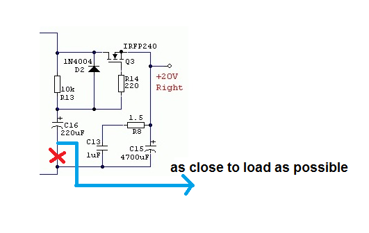

Can see down the road seems there was variables how good performance some builds and their layout gets, therefor share that in past we many time guided by specialists to get sense point as forward to load as possible maybe with remote wire, and performance will measure much better. Not specialist myself and have not lab gear to confirm but see below what was suggested to application as this and 78/79xx plus LM series, below schematic is half part taken from schematic into post 147

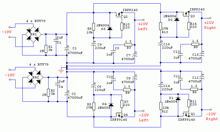

I have tried to open schematic in post#1, with different browsers but to no avail. Curious what's behind that closed door, Anybody...
I did not know folks can't see the schematic. Here it is reposted from DIYA server.
![585920d1481786375-jumas-easy-peasy-capacitance-multiplier-juma-cx-schematic.png](https://www.diyaudio.com/forums/attachments/solid-state/585920d1481786375-jumas-easy-peasy-capacitance-multiplier-juma-cx-schematic.png)

I tried using with various size uF caps on the Cx which im drawing +/-18V at 5amps per rail for a total of 10 amps per class A monoblock. Later it was simmed and showed maybe an improvement of 1 maybe 2 db across the audio band. I just went with low esr caps and on C7 I paralled 5 x 1000uF, just because...
