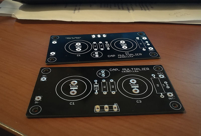

Hi Günther,
I did recieve today your last two PCBs left over. Nice PCBs

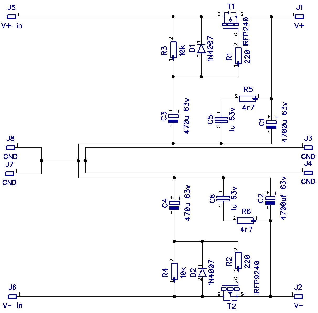

Hello.I ordered this 3.3V-12V In / +-15V Out Dual Power Step up converter to power my preamps from USB or batteries. Can you suggest a capacitance multiplier circuit with low drop voltage to put at the output of the step up converter supposing max output current wont exceed 100ma per rail?

That's hard. A BJT based on can do 0.6v drop but that's a different thread. Much easier to get a step up that will take your outputs to much higher voltage and boost by +4v. Dual rail is harder to find. You could take two batteries ea to a MT3608 converter and put in series.

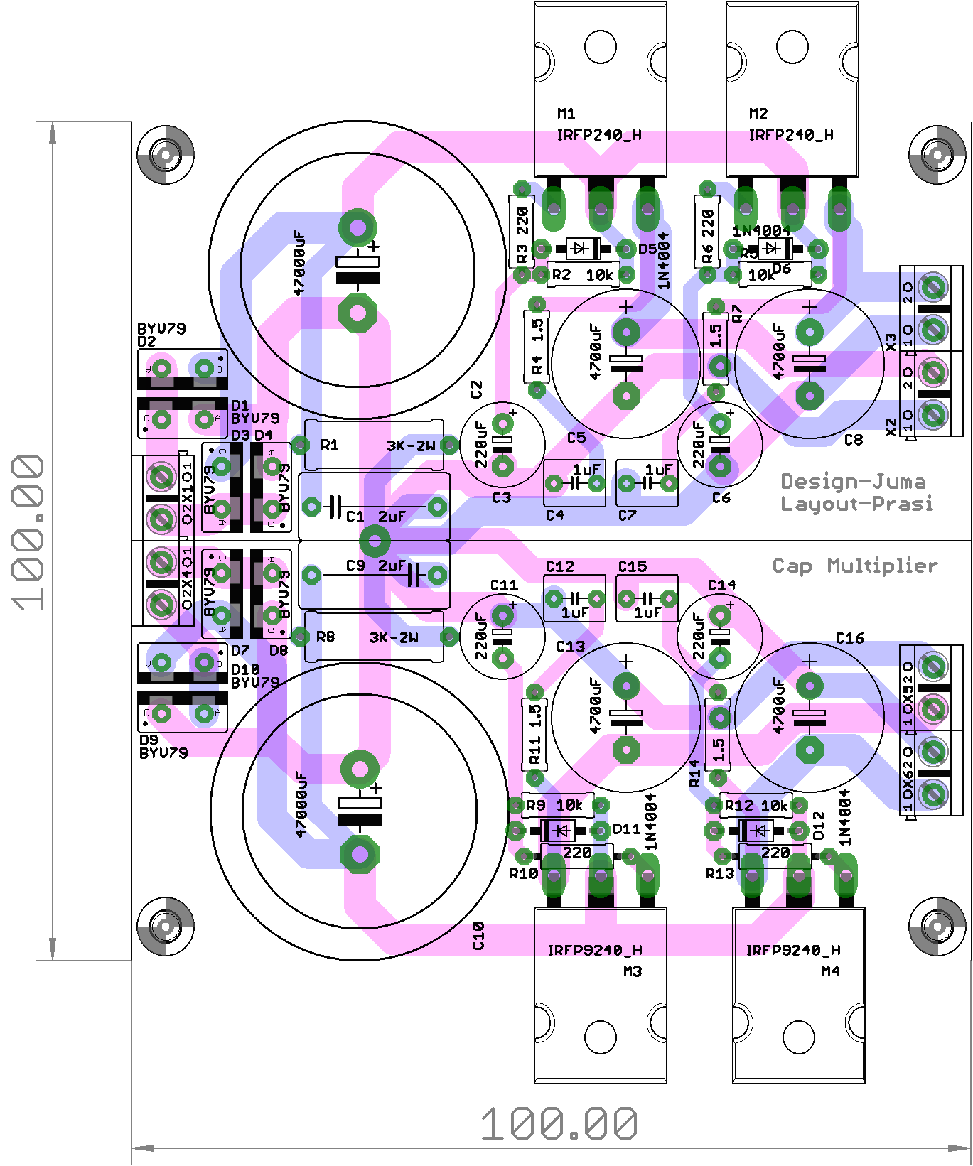

Hi everyone,
I'm building an alephj mini version with one pair of IRFP240 which needs +/-16V. I would like to use the attached Juma's cap multiplier from post #10. I guess I have to start from a 2x15V transformer but I need to ask what should I change to the resistors' values.
The resistors control the ripple control response rate in combination with main cap value (220uF). Just know that there is a 4v drop across the multiplier. So you need about 20v DC. Under load, the transformer's output will sag about 1v or two. So if you will use the cap values shown in schematic, don't need to change resistor values.

Hi Prasi,
It would be nice if your PCB also had option of installing spade connectors for AC in and DC out, rather than screw terminal blocks.
