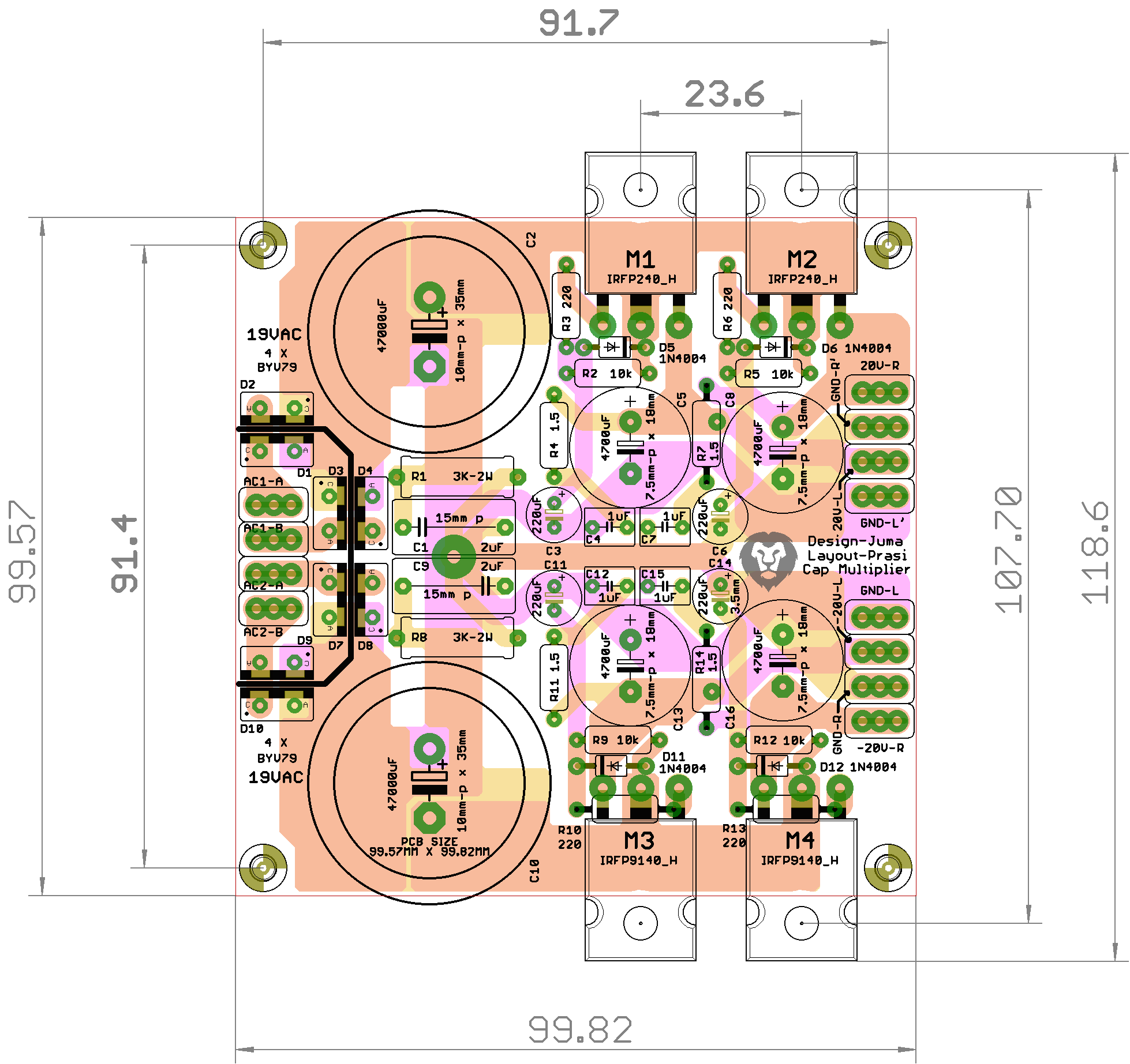

I will post all the gerbers files required for board manufacturing by boardhouses. you could order it yourself. 11 pcbs for 12 USD total @ easyeda.
Let me refine it a bit more, by tomorrow.

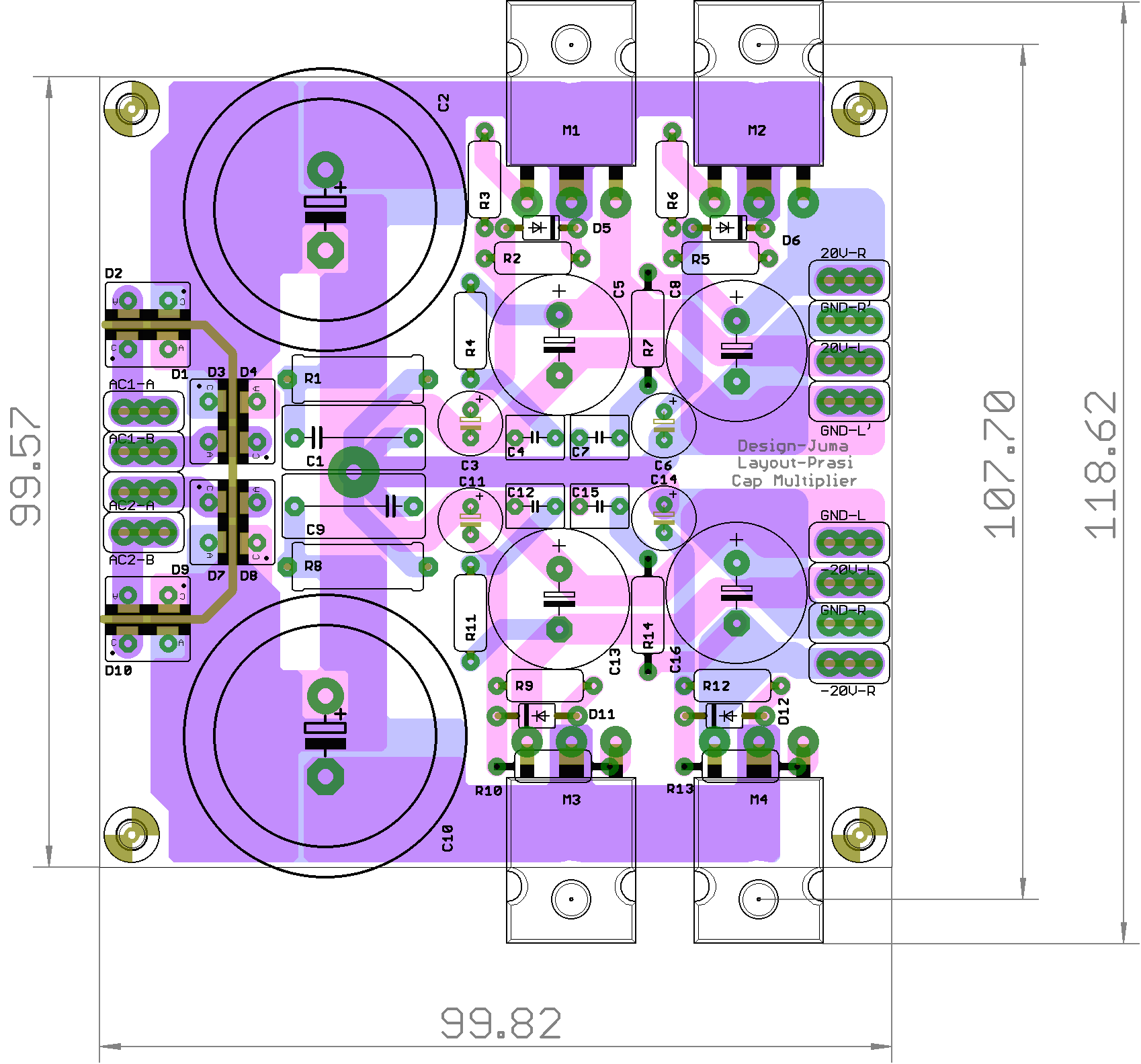

Four cap multipliers on one small PCB.

Yes, thank you Prasi - this is going to be a very useful board to have. Fitting four onto a 100mm square is true art and huge cost savings for us to get fabricated at typical PCB maker where huge discounts for small 100mm exist.

Under Class A operation I am a little concerned about how much heat dissipation we would need on those TO220 diodes. Assuming 1.5amp working current, that's about 1w ea or nearly 8w total for all diodes on the dual bridge. One option is to use an external monolithic bridge (center bolt with 4 spades), in which case we could add some clever jumpers at the appropriate diode holes and connect the DC input to the AC spades. But for Class AB operation, the setup as is will be just fine.

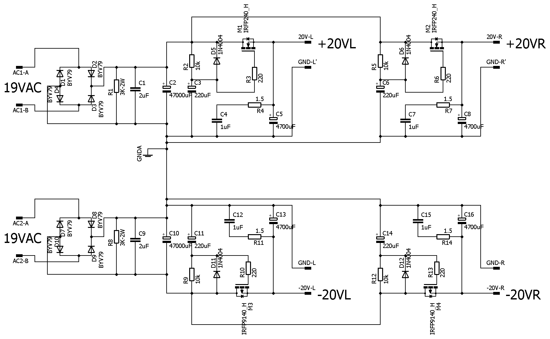

Sorry to take the discussion down to pre-school level, but I need your help for my project here. I am building a p2p CM for a TDA7297 amp, meaning, stereo and single rail power supply. The schematic on page 1 refers to dual mono dual rail power so I had to extrapolate a little bit.
This far is no problem, but since I am illiterate in schematics, let me confirm a few things:
- DC+ from rectifier connects to the 10k resistor (that is in parallel with 1N400*) then connects to Drain in the MOSFET
- DC- from rectifier connects to negative lead of 220uF cap
- Positive lead of 4700uF cap connects to Source in MOSFET, also acting as DC+ output?
- Negative lead of 4700uF cap joins the negative lead of 220uF cap, effectively as common ground so DC- input (from rectifier) and output (to power amp) are also joined in the same spot?
Please advise, before I blow something ^^
Thanks so much, appreciate the handholding.

Jonathan,
You are 100% correct. That's all there is to it. Just keep in mind that a mosfet like IRF610 will drop about 4v from input to output. So size the upstream PSU appropriately to get desired voltage downstream. An SMT mosfet like ZVN4306 drops only about 3v. An IRFP240 can drop as much as 4.5v.

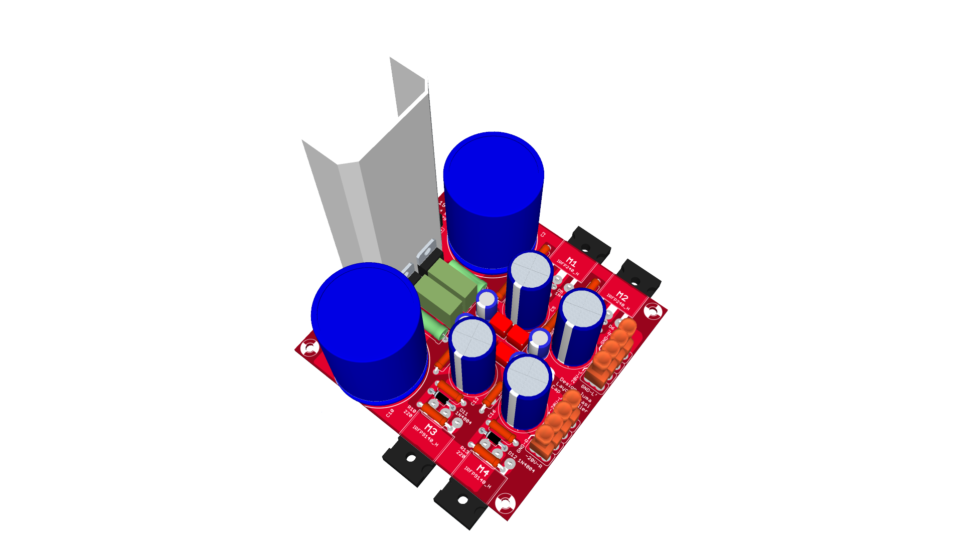

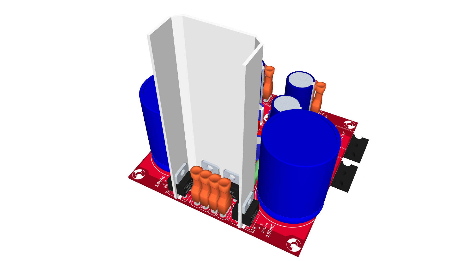

Apart from the option suggested by you, one more option below.
I have made a provision for a 1mm thick al plate as a heatsink. one could mount a small finned heatsink to that plate on top.
xrk,
visual of second option. on this aluminium plate, one could mount something like M-C421 Heat Sink Kit Cincon | Mouser India
but this would a bit of diy effort I guess.
looks pretty isnt it?
ofcourse one would use to-220 diode insulation in between Al plate and diodes.
