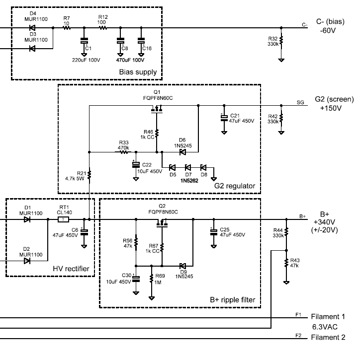

I have builted Juma 's cap multiplier (post 1) with a very good results for my headphone amp. I just wondering if these is any circuit that work the same way for high voltage applcation? (150-250v)
Thank
Just look here or schematic below;
DCPP Amp
Look for dotted square called B+ ripple filter.
Works like a charm, I often use it.
Thank
Motor run capacitors are usually plastic film type and rated for 250Vac (roughly equivalent to 400Vdc).
Motor start capacitors are sometimes electrolytic. I don't recommend these even though they are rated for short term use on 240Vac mains systems.
If you need 300Vdc to 400Vdc capacitors, then motor run capacitors are about as good as you will ever need.
There may be some motor run caps rated for 400Vac (across the phases of a 3ph supply). These should be good for voltages upto 550Vdc, but do check with the manufacturer.
Actually, 'chat' was asking for components for a high voltage (150 - 250V) equivalent of juma's C-Mx on 1st post this thread - excellent performance can be expected from the 'motor' caps but there's no real reason that electro caps will still create a good result - what's that saying about 'a horse and a cart' ...
Apart from different circuits that have been suggested to me which I'll try them out. (I find changing PSU do effect the sound and it's a lot more fun than changing coupling Cap 😀)
The circuit in post 1 can be used for higher voltage provided appropriate components are used. However big 4700uf cap might be a problem. I'll try smaller value i.e. 470uf and see if I like it.
