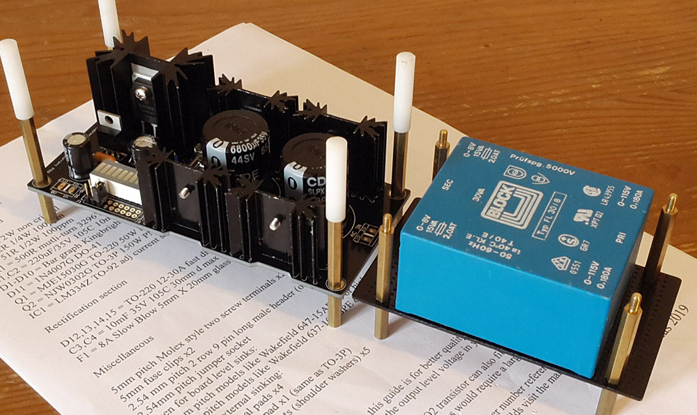

I wouldn't touch the board level sinks with a grounded cable or a probe or to a chassis associated with ground. Those instances would mean a hard short obviously.
When such actions to be avoided are under the original builder's control, a bit of thermal paste only and the simplified mounting are more practical for both work and rework, also more thermally efficient. If I was handing the build to unsuspecting persons I would insulate the semis on the board level sinks as a mishandling precaution.
For when outboard sinking to a heavy chassis or to external sinks in touch with a chassis, fully insulating the semis to the cooling surfaces is a MUST anyway.
P.S. The electrically floating board level sinks are discrete for each device in this design. That is why we could discuss choices in mounting practice. Insulation is a must for any devices sharing a common sink or chassis but working at different voltage levels in this or in other designs even when the sink or chassis is not grounded but floating.

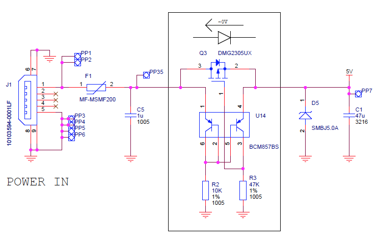

BTW, about the quote and nano-computers à la Raspberry, any rule of thumb about wire gauge? These DIY micro-USB plug are tiny, I guess I can solder 20AWG on it but not more.
And I can't figure out if the use of a 5V and GND pin on the GPIO header is wise, I mean safe enough to bypass the micro-USB power socket and will bring any benefit.
The extra 0.1/0.2V is a handy trick, not curing the source of the problem sadly
Hey, thanks. I have seen some use the GPIO header, I don't know how wise it may be. Dim Dim maybe knows better to answer if he will also read your question. On RPi 3 the red & black USB wire in the post#1's picture was enough at 5.1V L-A setting not to see the yellow thunderbolt popping up on Raspbian anymore. That one looked about 20AWG. Keep it as short as usable.
