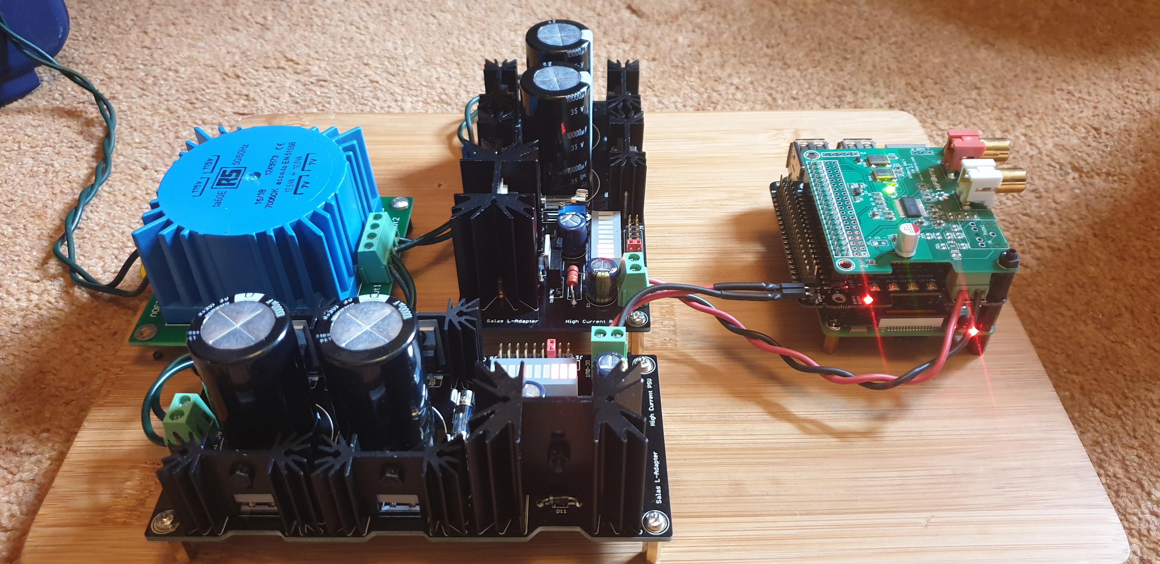

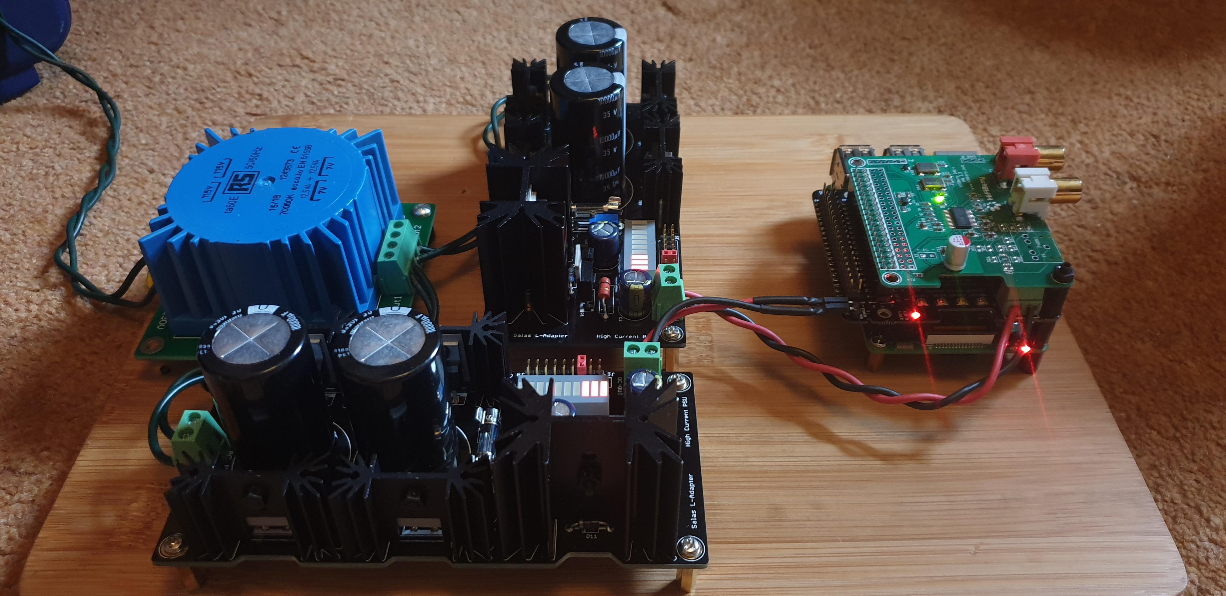

L adapters powering Rpi and Ian Isolator
So I have my 2 boards built and tested and running nicely at 5.2v unloaded.
One powers the Pi and one powers the DAC board. Probably a little overkill amperage wise for the DAC but I am waiting on other components to build other psu for there.
I had a noise issue when I introduced the Isolator when powering with single 5v so I will try this later today and see how we get on.

The noise issue I have pinned down to a sampling rate thing within Moode....but the psus have really quieted down the background. I have a niece lodging whilst their house purchase goes through and as a nurse on night shift she is currently sleeping so haven't had chance to listen at high levels....but so far very pleased
Thanks again Salas and Tea

It seems your gear really benefited from those PSUs. Good decision to combine, strong result. Congrats and happy listening. The L-A PSUs are going to remain useful for a long while, not only for that particular combination but on various and future gear also, due to their wide voltage and power range compatibility. Good to have them in your arsenal.
What is it which is between pi and dac?
