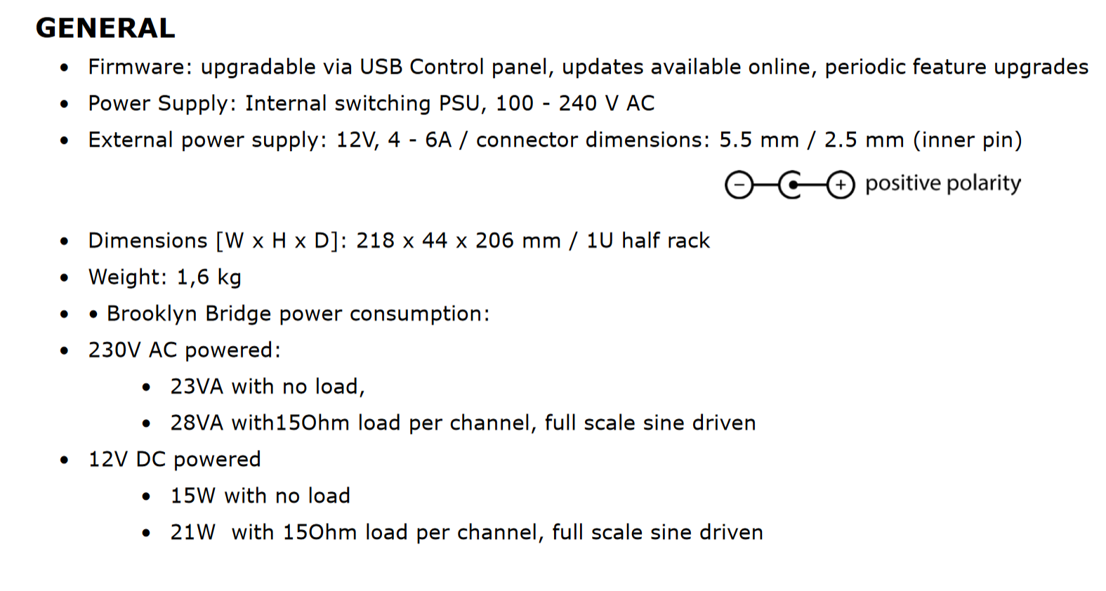

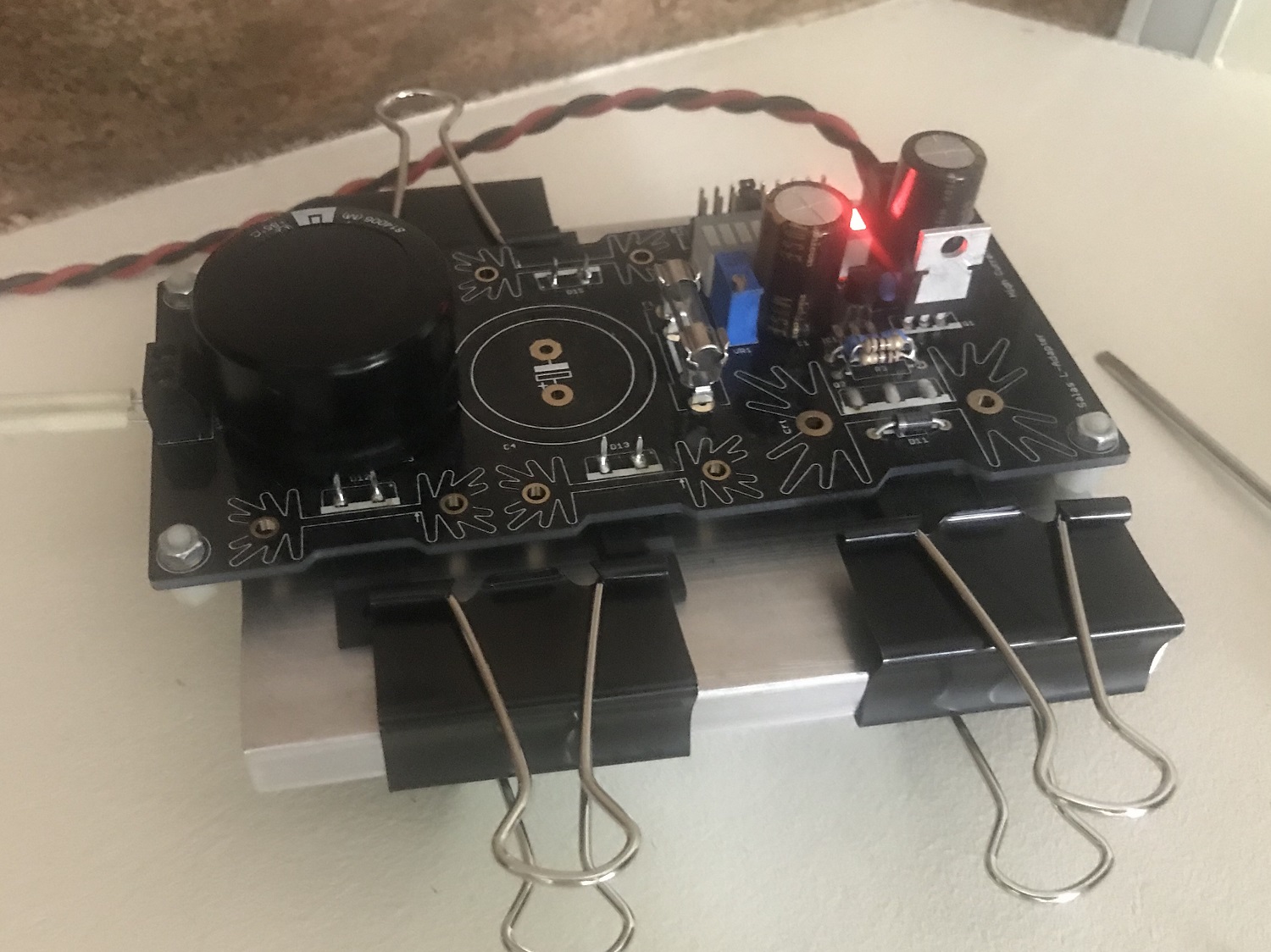

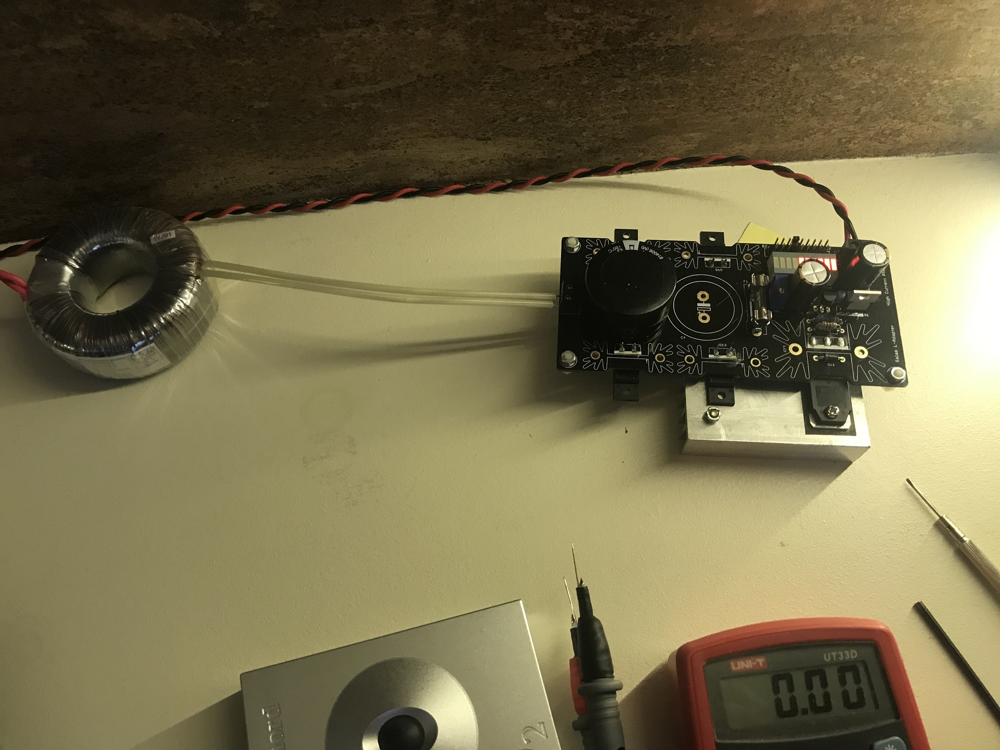

50VA trafo (14vac 3.57A), configured to 12vdc to feed Mytek Brooklyn Bridge. If internal switch power supply is used, it consumes less than 21W.
Turned the reg on just for a couple of minutes, otherwise the heatsink gets pretty hot, obviously bigger one should be used. Diodes are warm. 12vdc is stable.
Added data from Bridge manual.

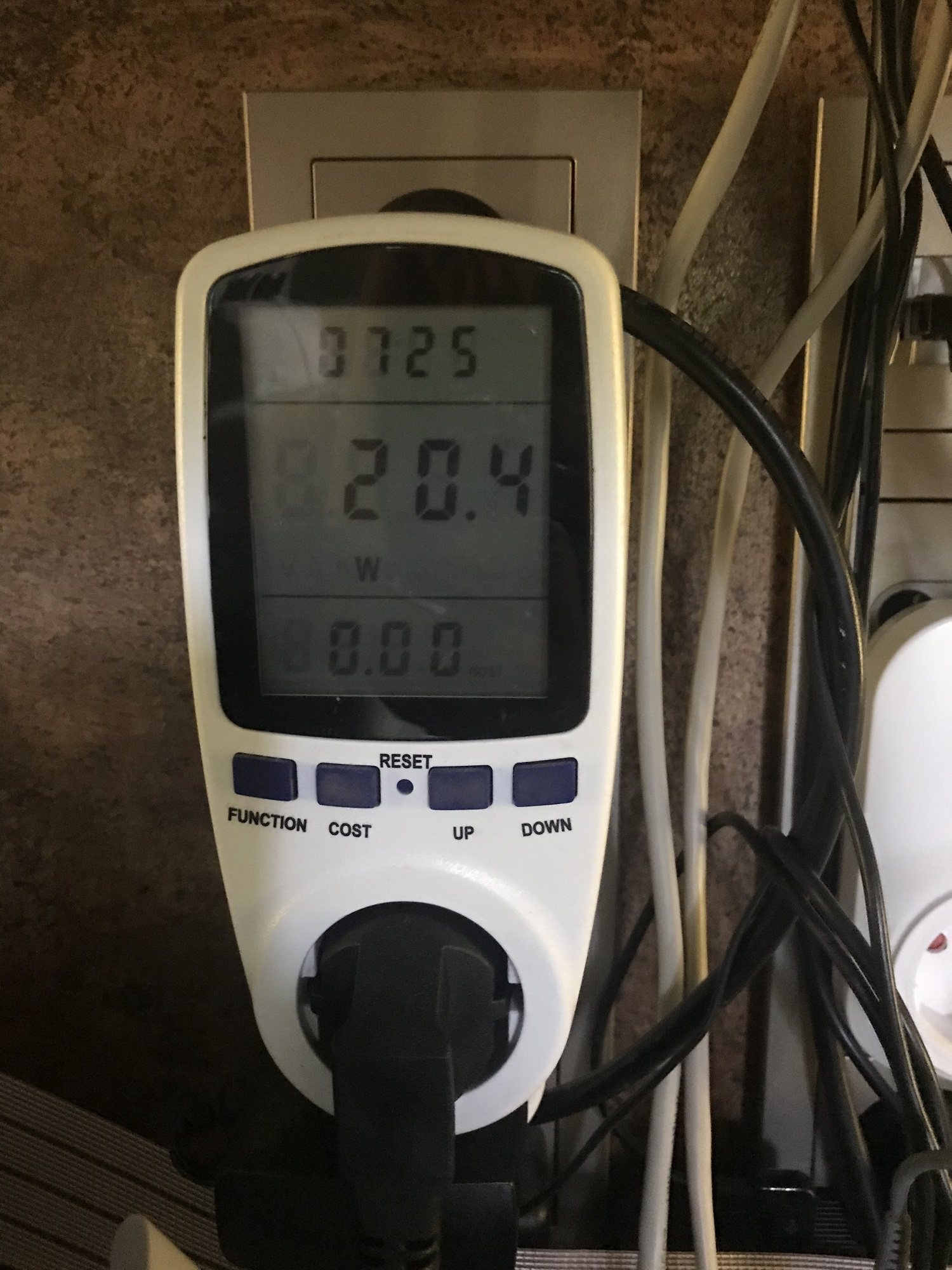

is that ok that the reg consumes 33W

Yes, the one in the picture is an obviously small sinking plate for your application. Enlarge it until adequate.
Part of the 33-21=12W difference in consumption from the wall should be the linear vs switching efficiency difference and another part a different power factor maybe. In general your build looks like behaving normally. Does your transformer become any warm as well? That should take some time in work to tell. Transformers lose about 40% of their nominal AC secondary current ability for DC in full bridge rectification.
will find a bigger heatsink and check the toroid. As it is now, I did not notice any increase in temperature on it.

hi!
after 5-7mins the heatsink (solid Al plate 120x100x10mm) is kind of burning (not possible to hold fingers), probably about 60-70c. Is there any easy way how to calc proper plate size? Should it be doubled? The idea was to use bottom of some aluminum case as a heatsink, but now I am not even sure what case should it be to dissipate all heat
Just a plate without fins, not attached to chassis, covered with the PCB, hmm it will eventually go high. Do you have a lower secondary transformer for a test? Maybe you don't need all the headroom you now got? That would drop the dissipation. What DC you got across the 1N4007? Otherwise you would need a proper finned sink with correct orientation. Fins looking upwards along the hot air's move. Or double the plate. Even if you stand the build with solid plate you now got vertical on its small side it should lose some C. Try that to see if its primarily about mass or air circulation.
To try roughly calculate another plate in a certain assembly situation it takes to measure C/W above ambient for this one sample first.

it's 5.9vdc across 1n4007. Ambient C is about 25-27c. The trafo is pretty warm I would say, but not hot. Unfotunately do not have any other to test with. Might it be less hotrod with 30VA toroid, for instance?
