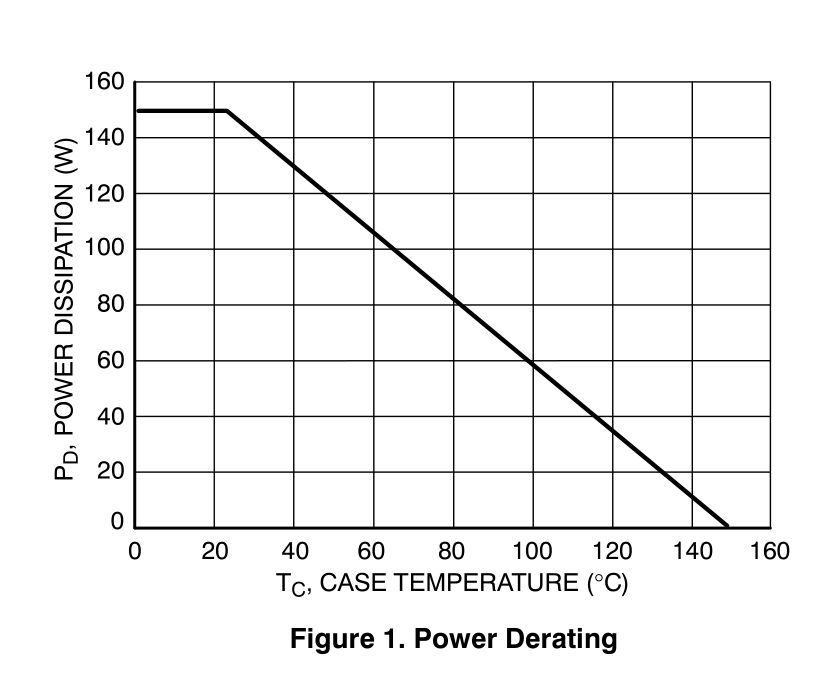

Depends of the dissipation ( P= (Vin-Vout)*Iout ), and the heatsink's thermal resistance.
The NJW0302G inner thermal resistance (between junction and case) 0.83 C/W, so -for example at 50W dissipation- the case 41.5 C degree cooler than junction.
Typical junction temperature limit is 150 C, so if the case below 100C, yet -it this case- didn't exceed the limit.

BTW if you read the transistor datasheet, there is this figure:
p.s.
