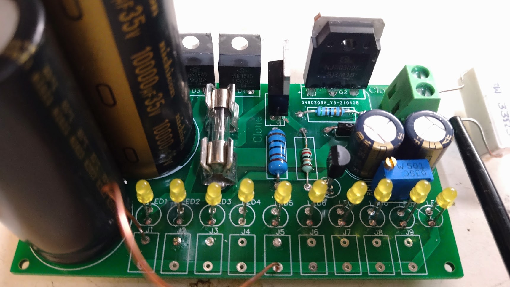

Maybe an insulation issue? Does it work if you will lift the PCB off the chassis? Don't worry about developing heat without sinks when unloaded.
yes that did it. It now measures perfect when everything is detached from the chassis. Now I have to find the cause. Q2 has a isolation pad. the rectifying diodes did not get and isolation pas as a I assumed that these do not need isolation

That last thing is exactly what I did. First populated the pcb, then mounted all chassis mounted parts. Fixed the pcb's on the standoffs and as a last step I soldered the rectifier diodes and Q2 to avoid solder joint stresses when tensioning the screws for the chassis mounted parts.
I used a plastic shoulder washer on Q2 and mounted everything again on the chassis, checking voltages after every connection. Now all is fine. I think it was the srew for Q2 just touching the edge of the metal.

I have done a prototype board and fired it up. Seems to work but with less voltage reduction. I have used some leds i have at home and they seems not to work out any good. Any suggestions for replacements? As you can see i need common single leds. I tried to measure them for voltage drop at 5mA but did not come out good in reality.
