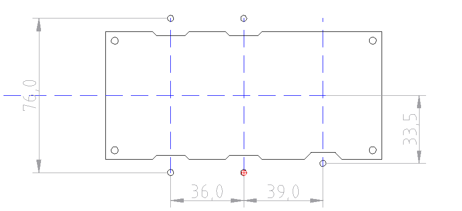

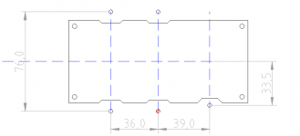

I am looking at using a Hifi2000 GX288 enclosure as heatsink for the PSU. So i came up with this drill pattern for D12-D15 and Q2
Next to that I have a few questions:
-When soldering Q2 in this way to the PCB one has to be careful with D11 not touching the legs of Q2. Who has been there and done it?
-By looking at the parts i have in the minikit from TeaBag it looks like I only need an isolation pad for Q2 and that i do not need isolating grommets for the screws.
I will just use a tiny bit of thermal compound. Is this correct?
thank in advance
thank in advance

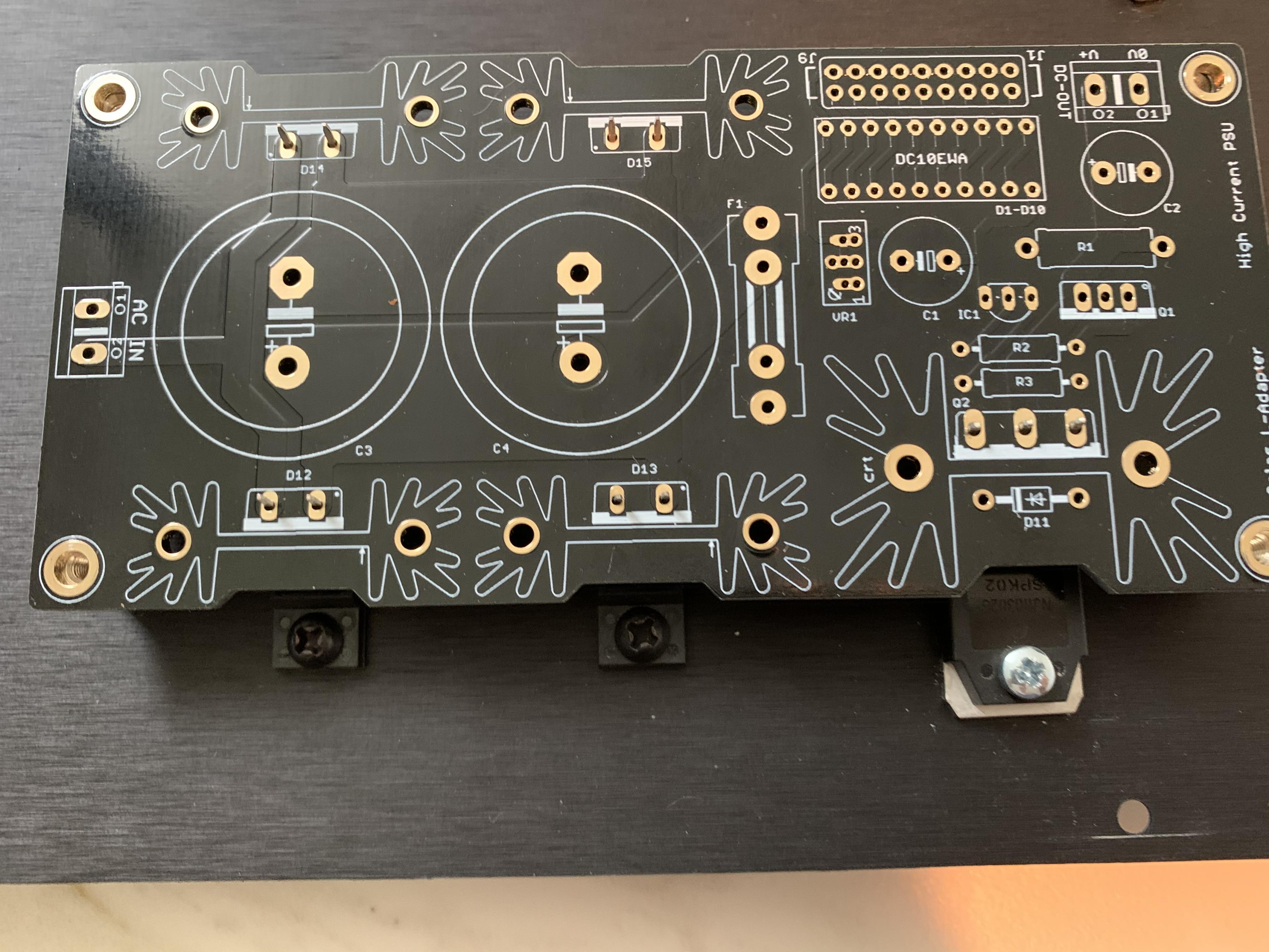

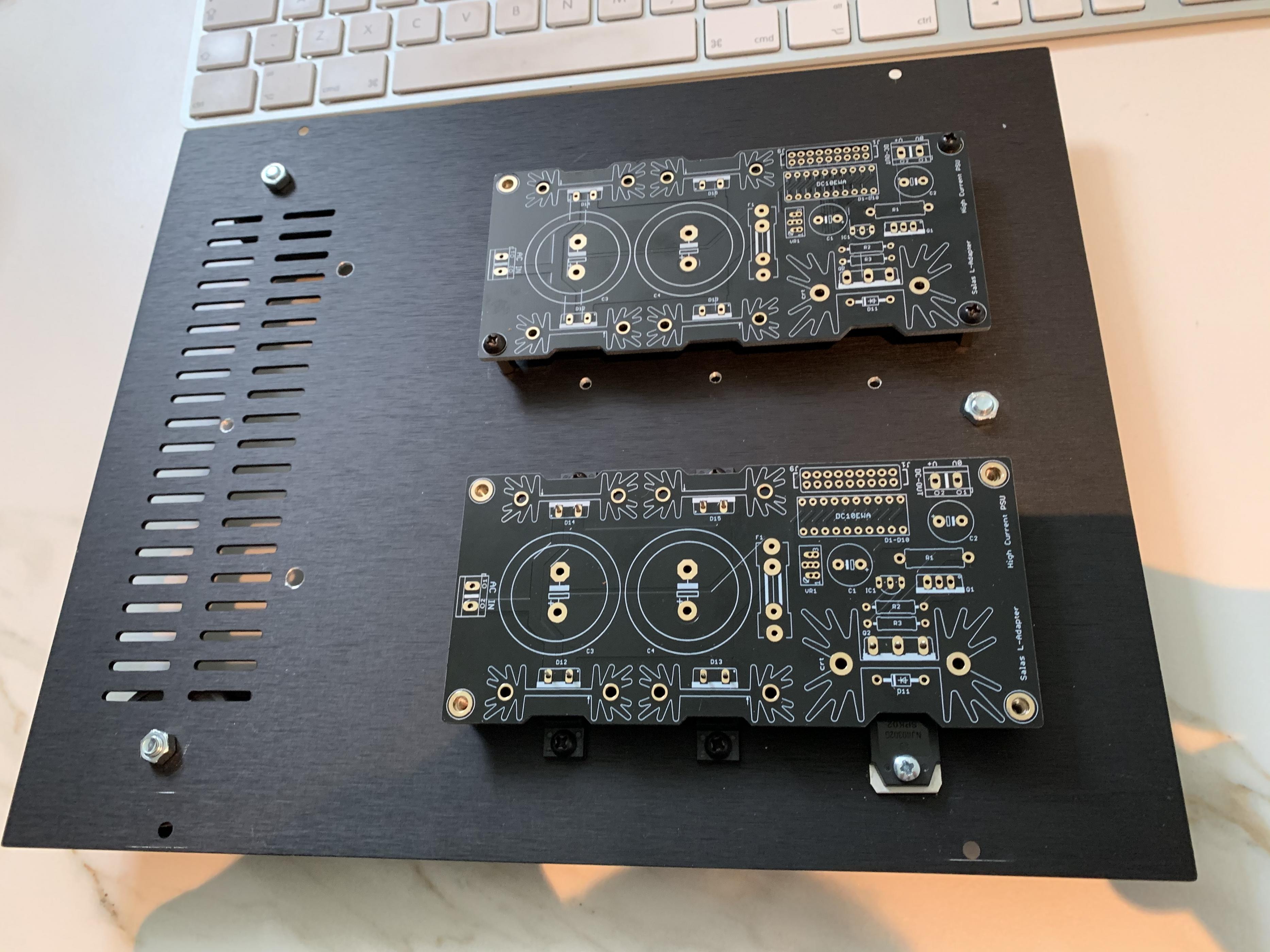

In the first step I drilled all holes in the base plate of the enclosure and tapped m3 thread for the PCB standoffs and for fixing the transistors. The enclosure can fit two PCB's. I start with a 12V and later I will add a 5V power supply in the same housing. The pictures show the first fit, nothing is soldered yet. I will start by the small parts first.
https://www.diyaudio.com/forums/attachment.php?attachmentid=941274&stc=1&d=1618144179
https://www.diyaudio.com/forums/attachment.php?attachmentid=941275&stc=1&d=1618144179
