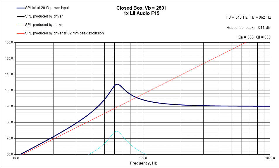

Looking at the golden ratio chart I came up with about 280L as the largest speaker that could realistically fit in my home. That works out to 42" Height x 26" Width x 16" depth.
The first three were run that way. The closed box looks like about 100hz is were crossing over would make allot of sense. I believe that is the number a few people have been using at this point.

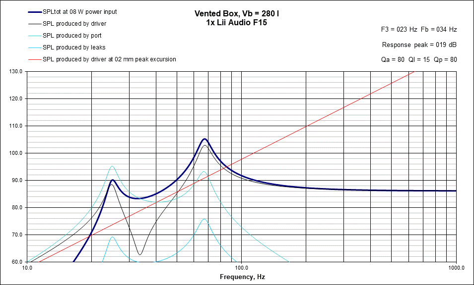

The vented box is pretty interesting in that it digs much deeper but I'm not sure how it would sound with the double peak.

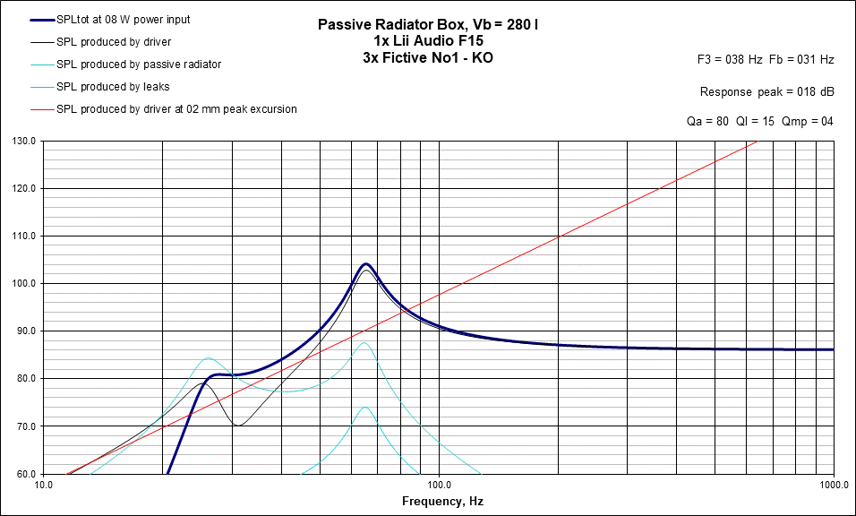

The passive radiators I think I put in correctly. I used the rule of thumb to have double the passive radiator surface as the driver, so it worked out to 3 12" DS315-PR. The box has to be 280L just to fit all those radiators somewhere. One of the front with the F15 and one on the left and right side's. Or maybe one in the front and two in the back, I don't know.

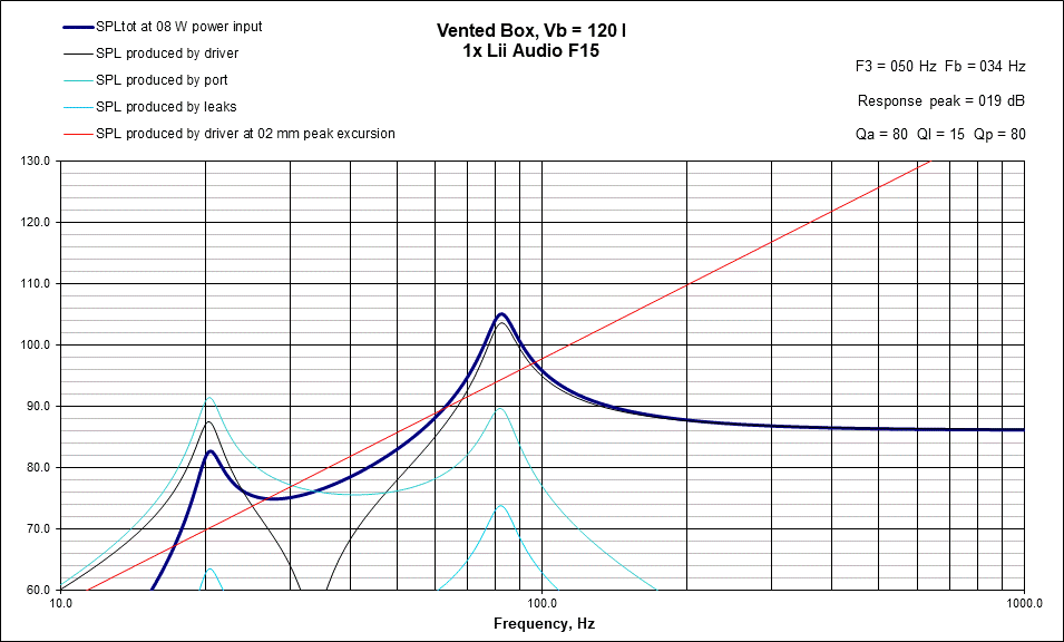

The last one I ran was dropping the cab down to 120L and putting in two ports. I recalled reading that the 0/96 speakers had looked at a big 15" full range driver so I figure I would toss in there cabinet and ports and see what came out. It looks like it will dig pretty dang deep, it's a fairly agreeable size too. 31" H x 19.5" W x 12" deep.
Anyways I attached the charts Unibox spit out. Again not sure I did everything right. I was more curious if anyone else had look at things other then OB.

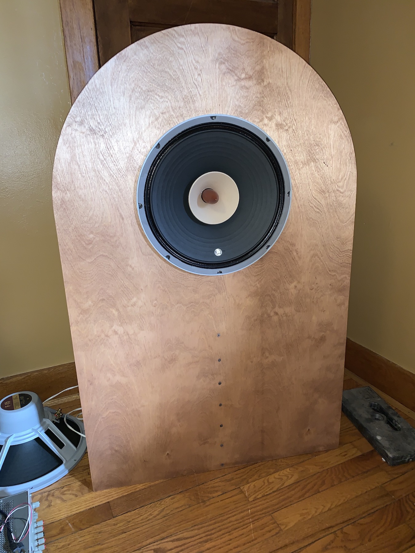

I have been listening to these in my system for a few months now. I recently changed the baffle to something a bit more aesthetically pleasing. Just trying different baffle shapes until I finalize a design before cutting into 2" hardwood! 😀
I recently moved my modified Klipschorns out of the room to free up space behind the baffles and that made a significant difference in improving the size of the soundstage. The new baffle below also moved the speaker up closer to ear level at about 32" off the floor which improved the mid and high frequency details. Bass did not seem to be affected at all. If you listen to jazz, classic rock or "older" music, this setup is fine. But for more modern music with lower synthesized bass you will be missing something. I am patiently awaiting a pair of W-15 woofers to assist these.

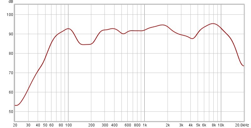

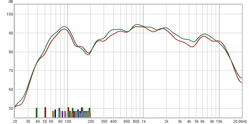

Yesterday I took some measurements with REW and a calibrated USB mic at listening position. I was pretty impressed with the results. There is a significant dip at 200Hz and 4.5kHz. 200Hz appears to be my room as you can see the room modals in the lower left corner. I assume the 4.5kHz is the whizzer cone. My long term plans are the W-15 to fill in the bottom and possibly a set of Fostex T-90A's for the top end.
So far I am really enjoying these drivers! They are the most natural sounding fullrange drivers I have heard to date. They also extend further into the lows and highs than any others I have heard as well. Sadly, I am afraid my beloved highly-modified Khorns will not be returning to the music room. 🙁

Took another measurement at 1 meter straight on (not listening position). The dip around 200 is still there. I pulled them out into the middle of the room and re-measured and curve looks almost identical. I would assume then the 200Hz dip is baffle related which unfortunately is exacerbated by my room modals. The 4.5kHz dip is still there and I am convinced this is the whizzer cone.
