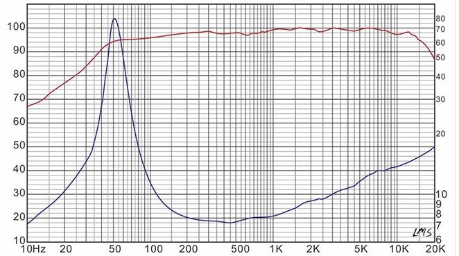

IF the calculator I grabbed was correct and my input ballpark, then that curve shows super low Qes -- ? It would be better to have Re taken lower than 10Hz.
Sd "might" have been given in wrong units as could be square inches.
crazy stuff.
double check that curve and method
anyone messing with speakers ought to have an automated speaker parameter device.
crazy stuff.

... curious about the discrepancy about the Q ...
One should expect differences.
Where different techniques/SW method pick the numbers off the curves, and the weather. Further, according to the authour, DATS is one of those tools that estimate sthe parameters from the curves, not a direct measurement.

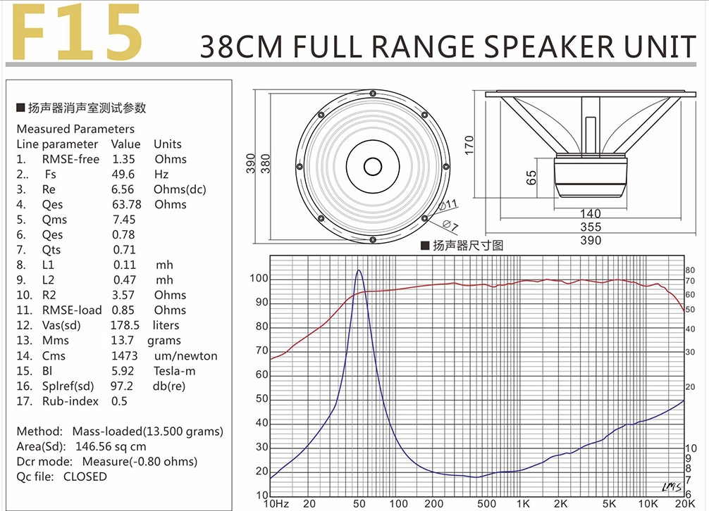

Using published Cms, BL, Re to reverse engineer Sd, then used HR to calc the rest:
851 cm^2 Sd
6.56 Re
51 Hz Fs
151.8 L Vas
3.97 Qes
8.29 Qms
2.68 Qts
Using the impedance plot, I can't find my notes now, just recall it being around a 0.31 Qts = silly published data!

Pretty smoothed...............
That's an understatement!
And polars would show how much beaming ... which is probably quite extreme given the size of the cone...
Here's the rest of the screen grab
Like I said, pure BS/silly! No Sd or effective diameter, 13.7 gr Mms! Maybe the whizzer is! A 5.92 BL, not strong enough to get out of its own way!
GM
I think there's error in translation....
There is a Sd of 146.5 cm2 mentioned, but obviously, that's not the Sd of a 15" driver, so it looks like a file swap between drivers.
fwiw I took the 13.7g (says 13.5g as the mass they added to their non existent graph to shift parameters "down" - - that hardly is enough)
the Z shown has low qts and 3mH inductance
also the 146.5 as "square inches" - not impossible with narrow surround

probably a great driver but specs up in the air other than WT3 indicating unsuitable for
ordinary box applications
it can be whatever one wants it to be !
