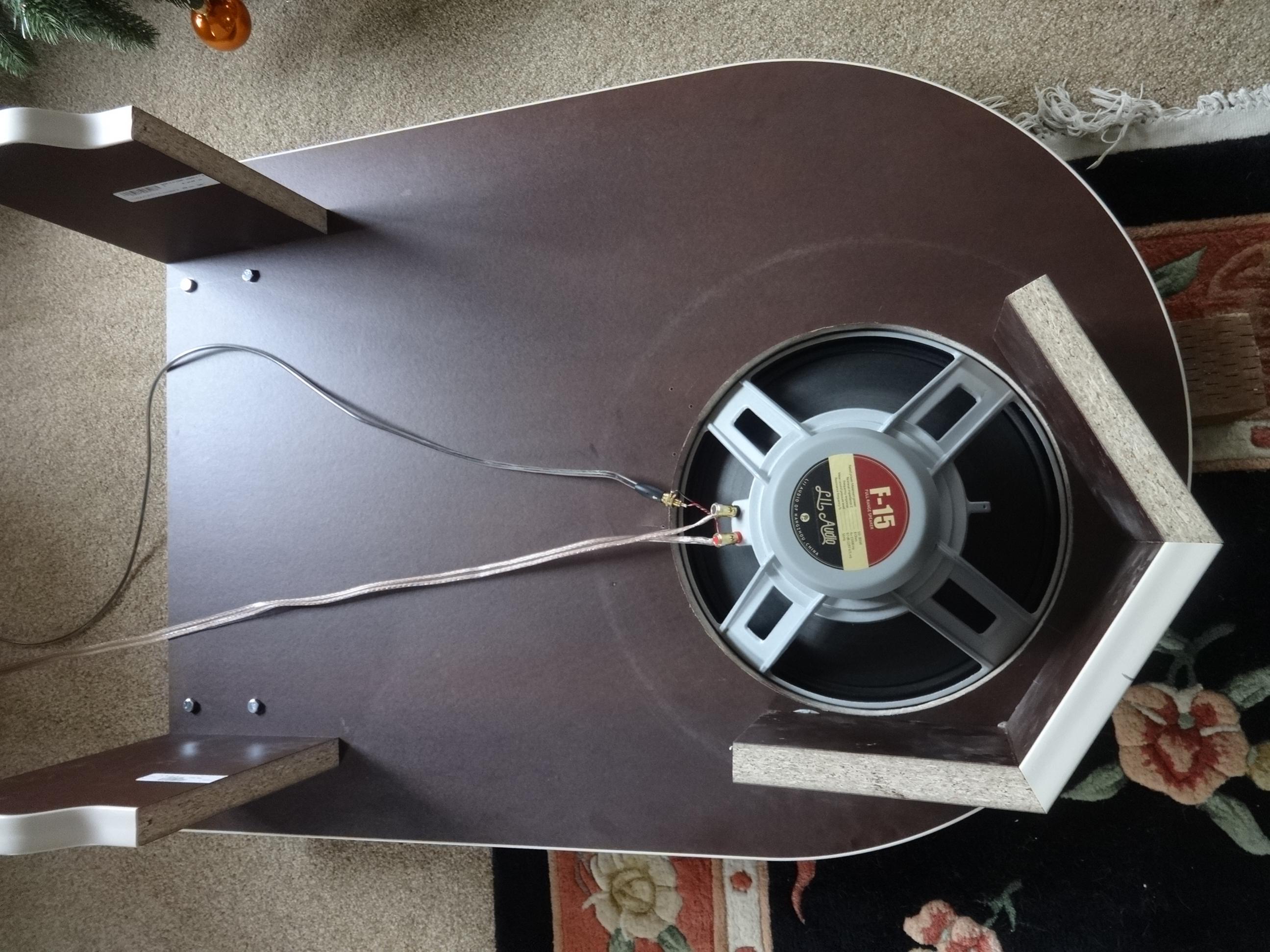

There's a checkbox for "open baffle" and if you know your board is 2' wide, you can choose a height and then place to driver anywhere on the board surface. It outputs a frequency response; I was told the useful part is the hump and dip near where the low frequencies start to roll off. Driver placement position on the baffle effects the hump and dip magnitude; there's better positions than others regarding minimizing these.
When I tried to model my baffles, I chose a position (one of several) that I felt minimized the OB hump/dip characteristic. That position however was not optimal for bass response, so I have to compensate by trying an arrangement of wing structures on the rear of the board.
They certainly seem to improve the bass extension, assuming by blocking the rear wave from wrapping around the baffle so easily to cancel the front... I'm trying to make the structure not be excessive to avoid introducing unwanted artifacts, such as a tubby sound, by making it "1/2 a tub" at most - only compensating for the "short side" of the offset. I've got another piece to glue in place on each board to extend the block a bit down the short side -

@tooppy - If you look back at post #35, there's a few pictures showing the Edge program UI and a corresponding frequency response plot. The first simulation I did had the driver centered and produced a 5 db hump, the next simulation I moved the driver closer to the edge and now it's 3db. So there's an example of this program providing a frequency response plot corresponding to driver position on the panel.
It's just one way of helping to decide where to place the driver. I just played on it until I got the hang of what approaching an edge with the speaker did to the frequency response / hump. Certain I was going to use an asymmetric offset, I then hunted around the baffle model with the driver for a frequency response I liked; a 2 db step I believe. With my intuition's approval and coordinates in hand, I proceeded with the project. I still got one more board or two to place and a couple other details, but soon I'll do actual frequency response measurements to see how they behave in the room. The tree is gone.
So far, with a little player EQ they're doing everything right - except that low bass.
That's improving with the winging of the backside of the baffle. I'm really glad I got these and first tried them in an OB. As I gain time with them, there's been many instances of "Well - I - never heard that song quite like that before!" To me, their frequency response sounds just right and the sonic image they make on some material is addictive. Just a lot of fun to listen to, no fatigue at all and can go in an evening from the 2020 Vienna Philharmonic New Year's Concert to the Chinese animated action film "Ne Zha" and do great with both.

Hi jjasniew, thanks for your reply, I was talking of pictures of your OB, back, front & sideways if you can. This give an added idea to everyone.
