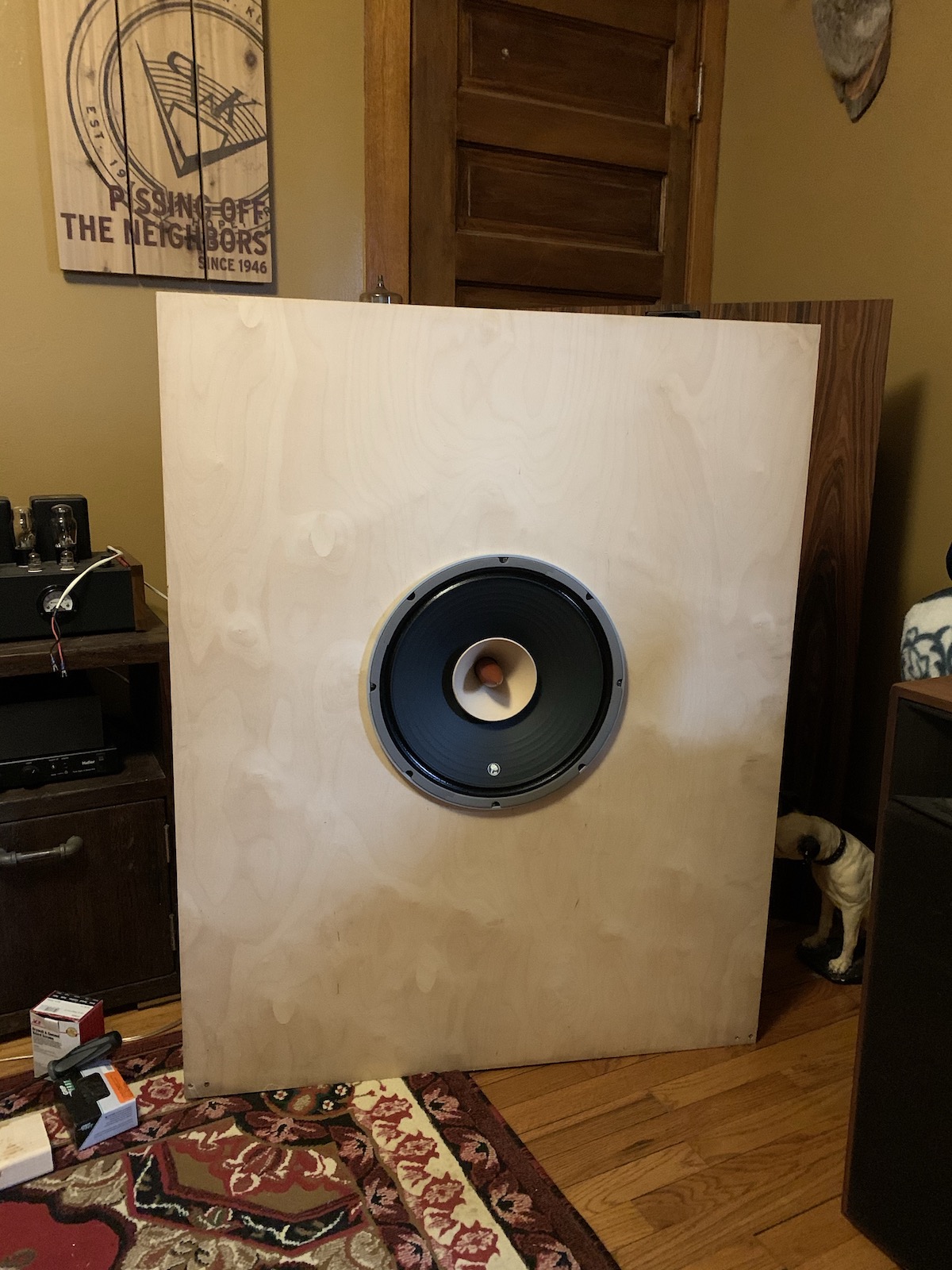

@Pano - Tonal balance sounds fine - excellent - to me. However as an older fellow, I realize no super tweeter for me - I wouldnt hear it anyway, unless it effects the bass notes somehow (which I've read...) As I add wing structures to the back, bass improves and I can use a little less digital EQ.
I have a sub which I believe will be more than adequate to pick up the bottom where these cant touch. That's the easy way. I bought a pair of cheap 18" PA drivers and could cut the baffle for them, drive them with their own EQd amp - but considering that effort, I'll try the sub first.
I have a couple pairs of other FR drivers, a second pair of baffle stock (currently stored under the bed) so I can always try the 18s with those before cutting up the boards that now have the F15s mounted. I'd like to try for something a bit narrower in appearance; push on the U frame capability and still allow for loading the F15s onto those if I want. That project's out on the horizon; still need to finish these, measure them and see what the sub can do with these to improve the lows.

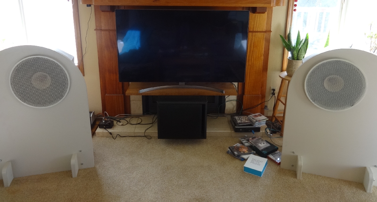

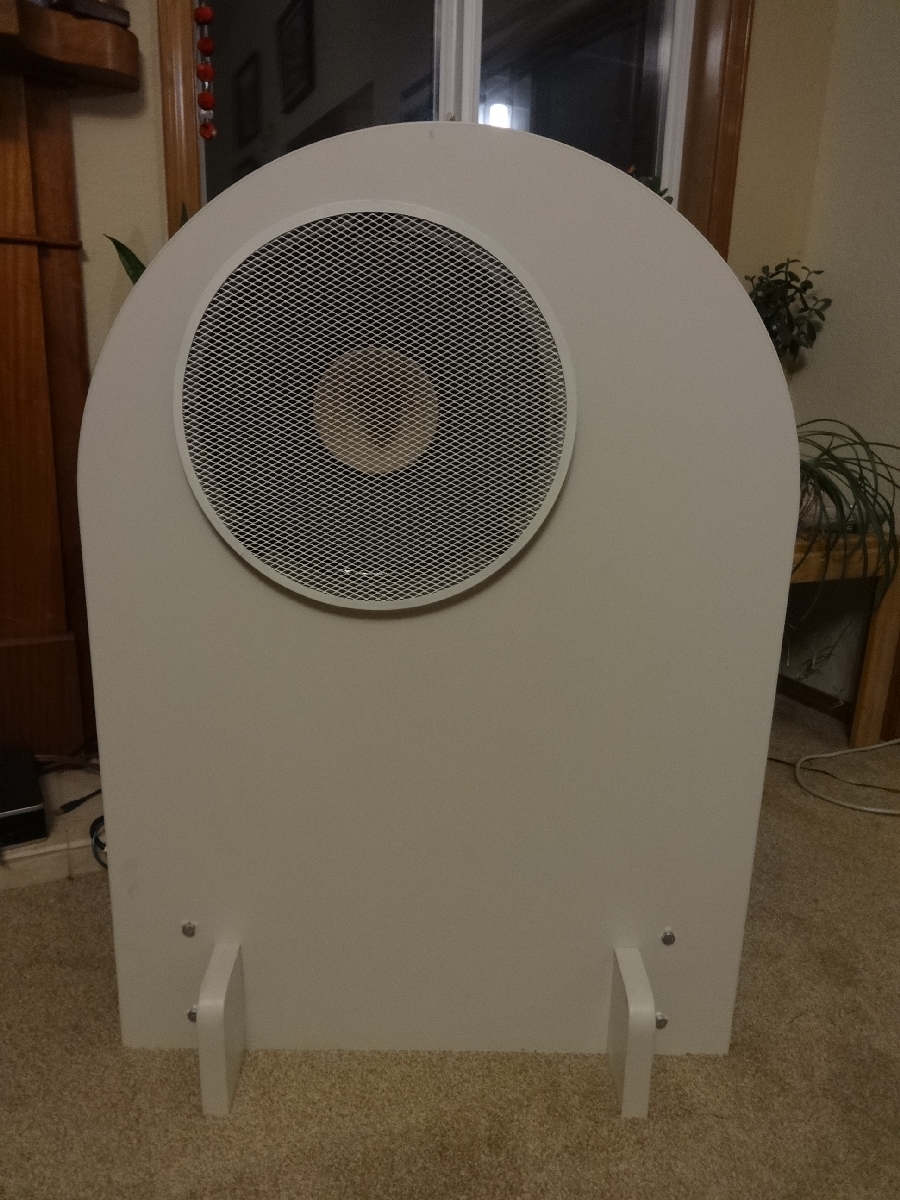

Here is my temporary baffles made from scraps in the basement. I am planning a Decware large baffle eventually.

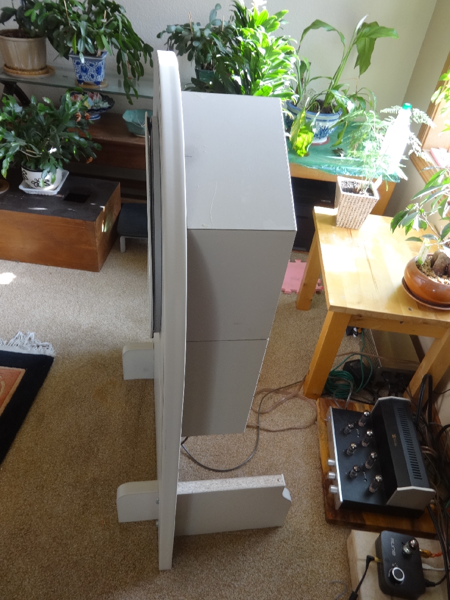

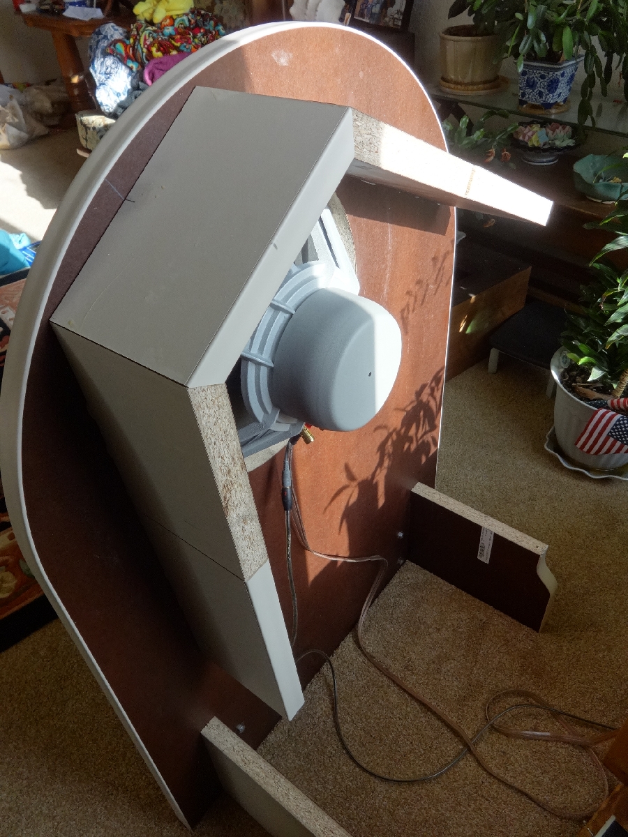

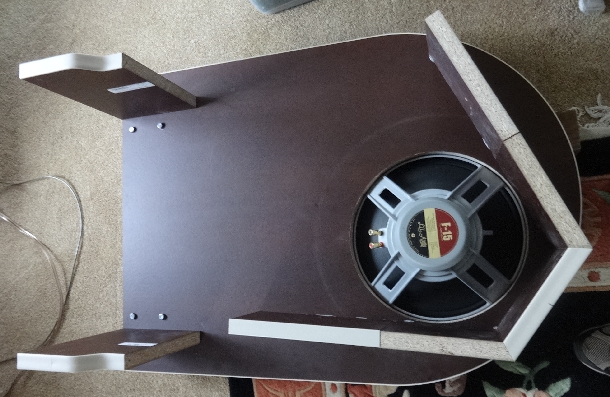

Try adding some 'spare' board as side panels and play around with 'splaying' them out at 45* instead of right angles - you can use tape to temporarily hold the sides in place - I've done this with the "Betsy's" with surprisingly good results - although it's only an 8" driver, the 10" and 18" side panels are just a variation on the basic 36" full width baffle - not sure if it'll be any benefit but easy to try....
@tooppy - you asked for some more pictures, so here they are. The baffle is 30" X 42" and the boards I stuck on the back are 6" tall - just the size of 10 pieces of scrap baffle board material I happened to have available. I extended the wing-age a bit as can be seen in the 1st photo. The other photos show what it looks like from different angles and the last is the whole system.
I brought up the 12" Velodyne sub and placed it dead center. Using the headphone outputs of the Aune DAC to drive it gives me a easily accessible level control. I dropped the 31.5 and 60Hz levels to -6 db in Daphile's BruteFIR EQ and set the sub to ~80Hz, then leveled it up to where I can just hear it start to contribute. Now the system sounds more like a normal stereo in terms of bass extension. I assume with the bass reduced like that and taken up by the sub, the little Jolida 6BQ5 amp (and the DAC) arent stressed at all.
I'm already imagining a sub box that fits better in the spot and doubles as a video screen stand. We obviously never use the gas fireplace.
Speaking of bass guitar, Victor Wooten's does sound good on that Flecktones 3 flew over the cookoos nest. Very fun to listen to and the sub's added depth makes the deeper notes more believable. Obviously, still experimenting with where to put the crossover point to the sub. At the levels I'm listening at, it's not doing a whole lot of work. I'm not doing a whole lot of work either to integrate it into the system; pretty much plug 'n play.

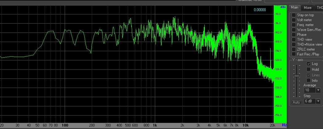

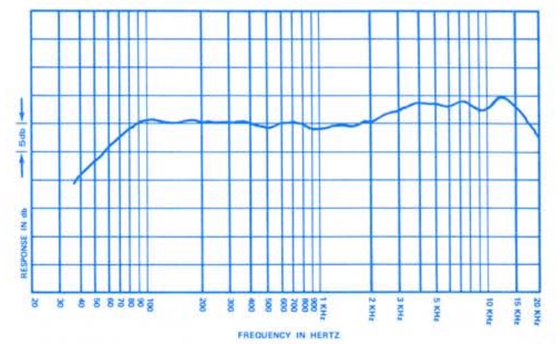

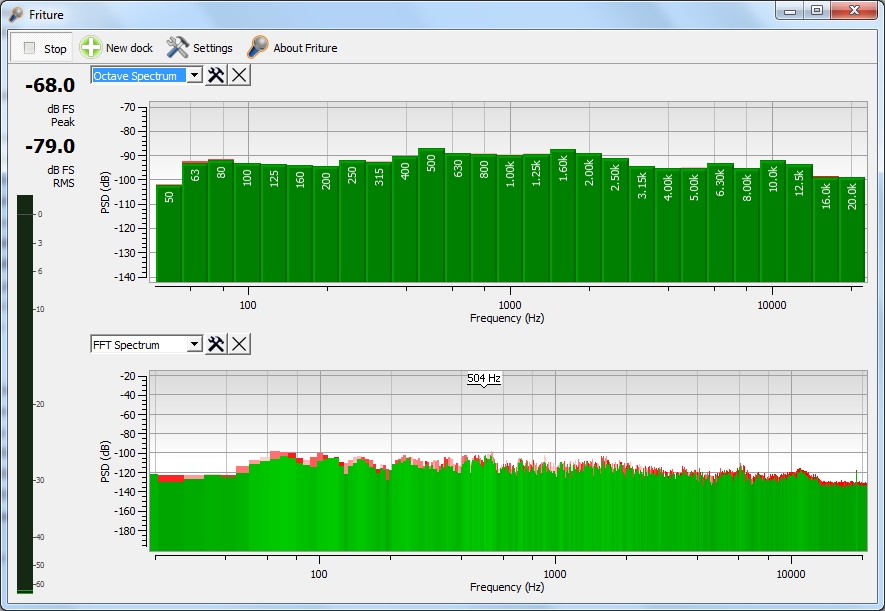

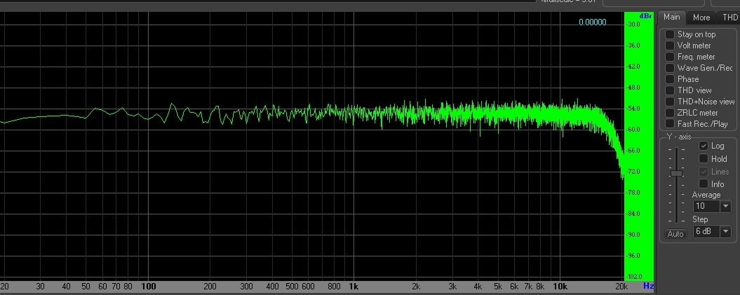

Here's some measurements I took of the Lii F15s this morning. I probably need a better microphone, I only have this EV 1710 from the 70's. (1st picture is the 1710 OEM spec sheet response) I used an M-Audio "JAMLAB" for the monaural A/D.

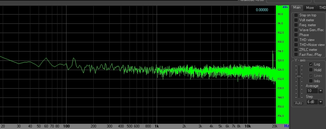

I happen to have an Ivie white/pink noise generator, so I used it for the signal source. I used a program called "Visual Analyser 2019". 2nd photo is the white noise signal at the right speaker terminal. I cant explain the fall off between 10 and 20 kHz... 3rd photo is the noise floor of mic in room with no signal. 4th is the frequency response at my sitting position.

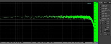

I also tried pink noise with an octave band analysis, using a program called Friture. 5th photo shows those results at the seating position. (I did verify flat response with the pink noise as input, but apparently lost that screen capture...)
So that's this time. When I get better at this, I'll redo and repost. Thanks!
