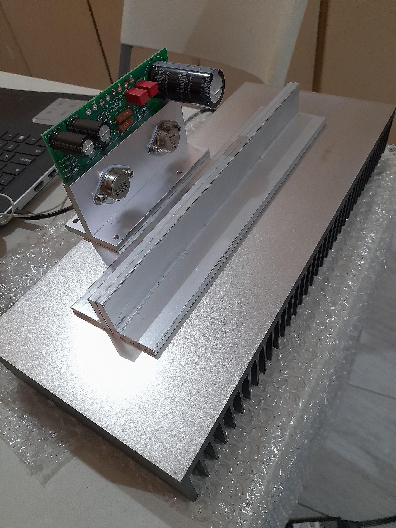

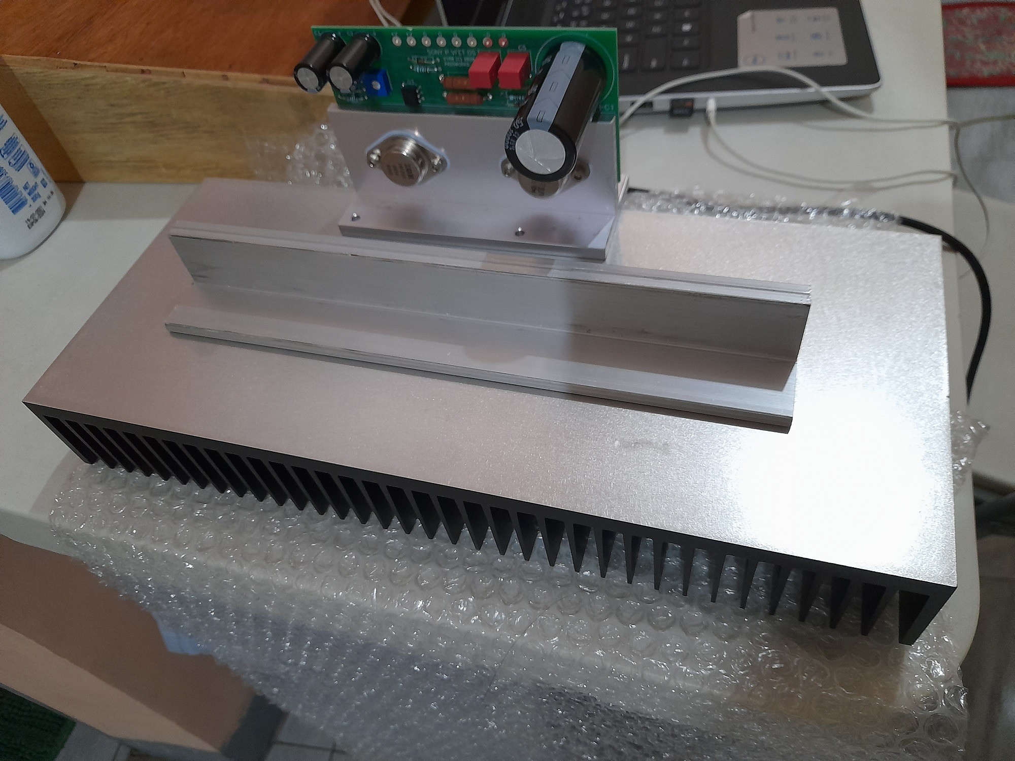

use just one - lower L , mosfet pins are not long enough for doubled thickness
elongating is more important than increased area, per se
so you'll be good
so you'll be good
of course , M4 screws of proper quality, split washers
proper quality means either quality mark on them (5.6 enough, 8.8 more than enough) , or buy Stainless Steel ones
everything to avoid mass produced cheese hardness
for that length, 4 groups of 2 screws
easiest to shoot between fins, so you can drill through hole and tap more safely
or use Allen head screws from out (maybe some shaving is needed to squeeze them between fins), nuts inside
put some thermal goop between L bar and heatsink

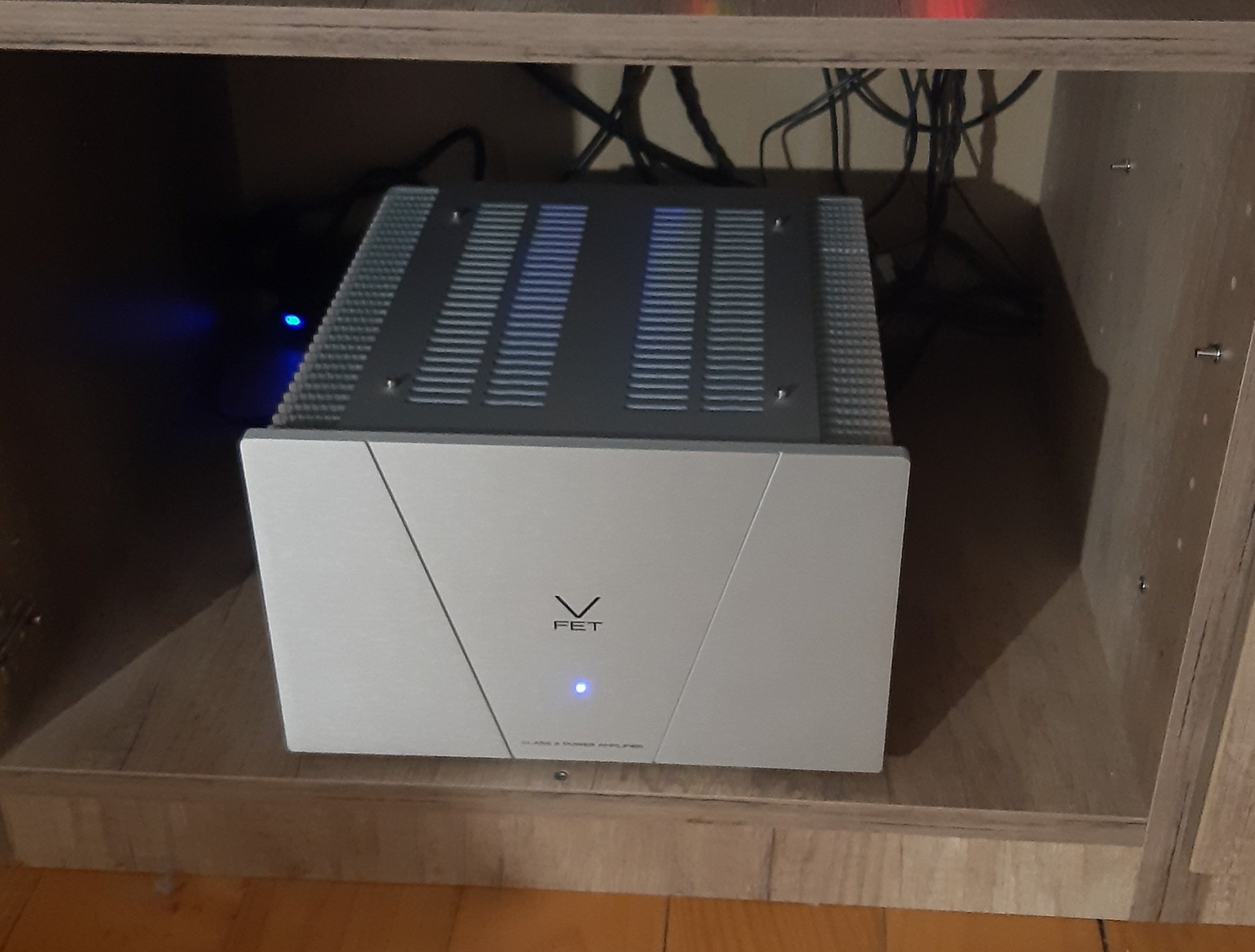

This little jewel come to me.
First BIG Thank You, to all responsible people for this amp, Nelson Pass, DiyAudio crew and Zen Mod.
Without Zen Mod's help this amp would stay in pieces for a long time as my life is in the fifth gear at the moment.
About sound....This amp is sooo pleasure to listen to, so relaxing with all necessary details.
--- Proud owner 🙂
P.S.
Delayed on/off circuit works perfectly.
--- Proud owner 🙂
P.S.

ZM, did you use any loctite or thread fastening compound on the threaded studs, where they enter the heat sink, or on the bolts used to fasten the heat spreader to the heat sink? Any reason not to?solving thermal issues; see pics, pretty much self-explanatory
whoever did arrange with Modushop guys assembly with M3 screws is not having enough mileage with all things mechanical/thermal; not blaming a guy at all, I know that this wasn't operation made by professionals and outcome is still extraordinary
that's exact reason why I'm posting this, to help Greedy Boyz in proper finishing and to feed my own OCD
fact is -these 4pcs of M3 screws needed to be M4 and additional 2pcs of M4 are necessary
only that way , with lapped T Bar, there is enough squeezing force at disposal to get rid of air gap between T Bar and heatsink
The primary purpose here is to help anchor the studs in the heat sink. I'm a little concerned that the M4 threads I tapped are too loose to hold a stud properly, hence I want to try a thread locking compound to hold the studs in place. I still plan to use a star or split washer setup to compress the T-bracket to the sink.feel free to use it, even if there is no reason to use it at all, considering that I insist on using split washer (or any other variation of same) wherever thermal cycling is in case
if tapping is so fluffy, locking compound is not going to help, maybe just hardest - gluing iteration of Loctite
if in doubt, repeat tapping
if nothing else, more holes are allowing more air
