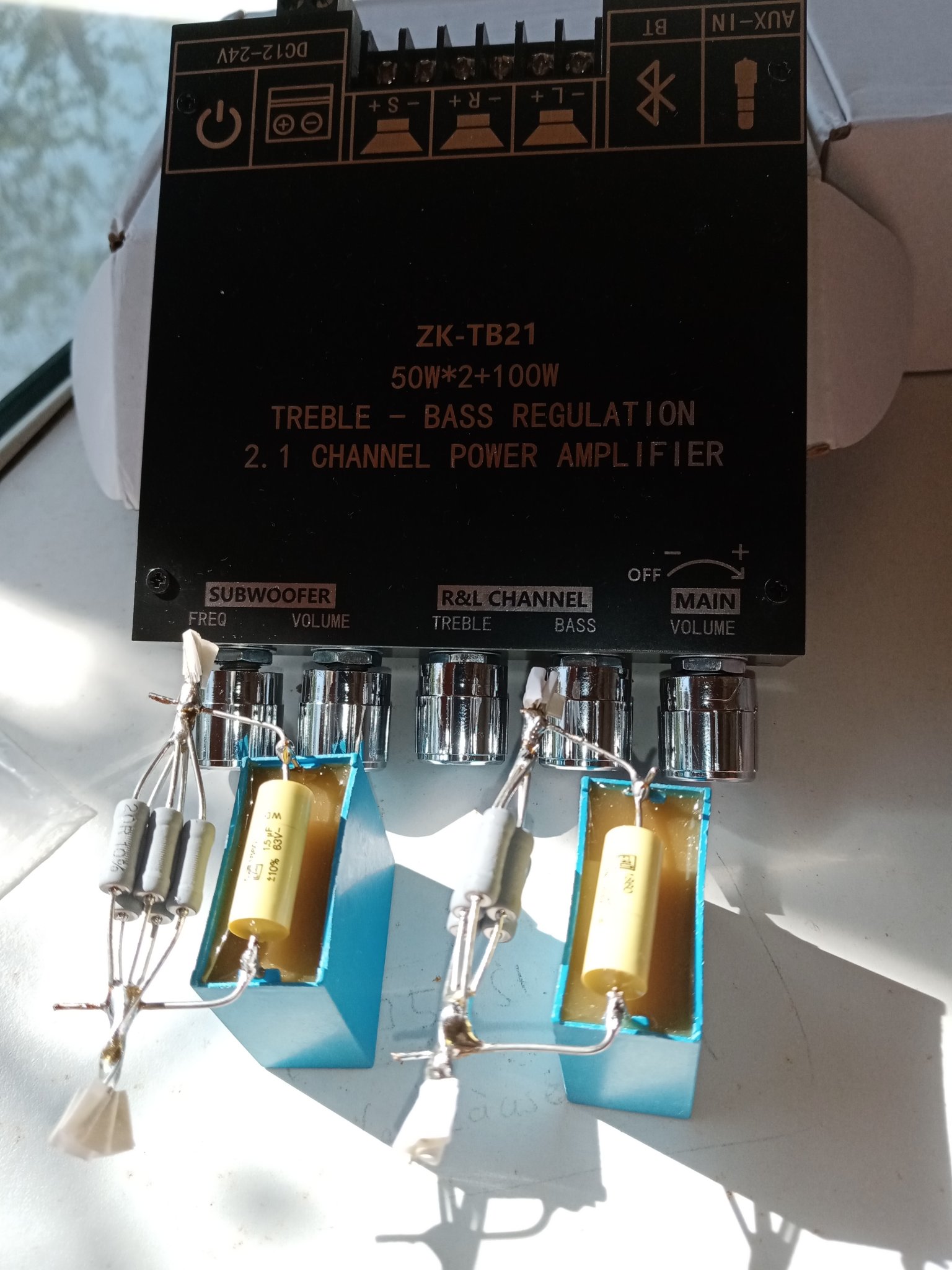

But I tested first time simple resistor method with 4 ohms and 1.5 microfarad in parallel bringing very good sonic result too with this 8cm fullrange loudspeaker. So for this speaker I bought an efficient D amp and prepared some resistors for a 2.1 system.

As I am a fan of fullrange loudspeakers I tested amps converted to basic current feedback.
This type of loudspeakers profit a lot from this amplifier topology.
One possible answer concerning ideal choice for a current driven amp is using quality fullrange drivers.
