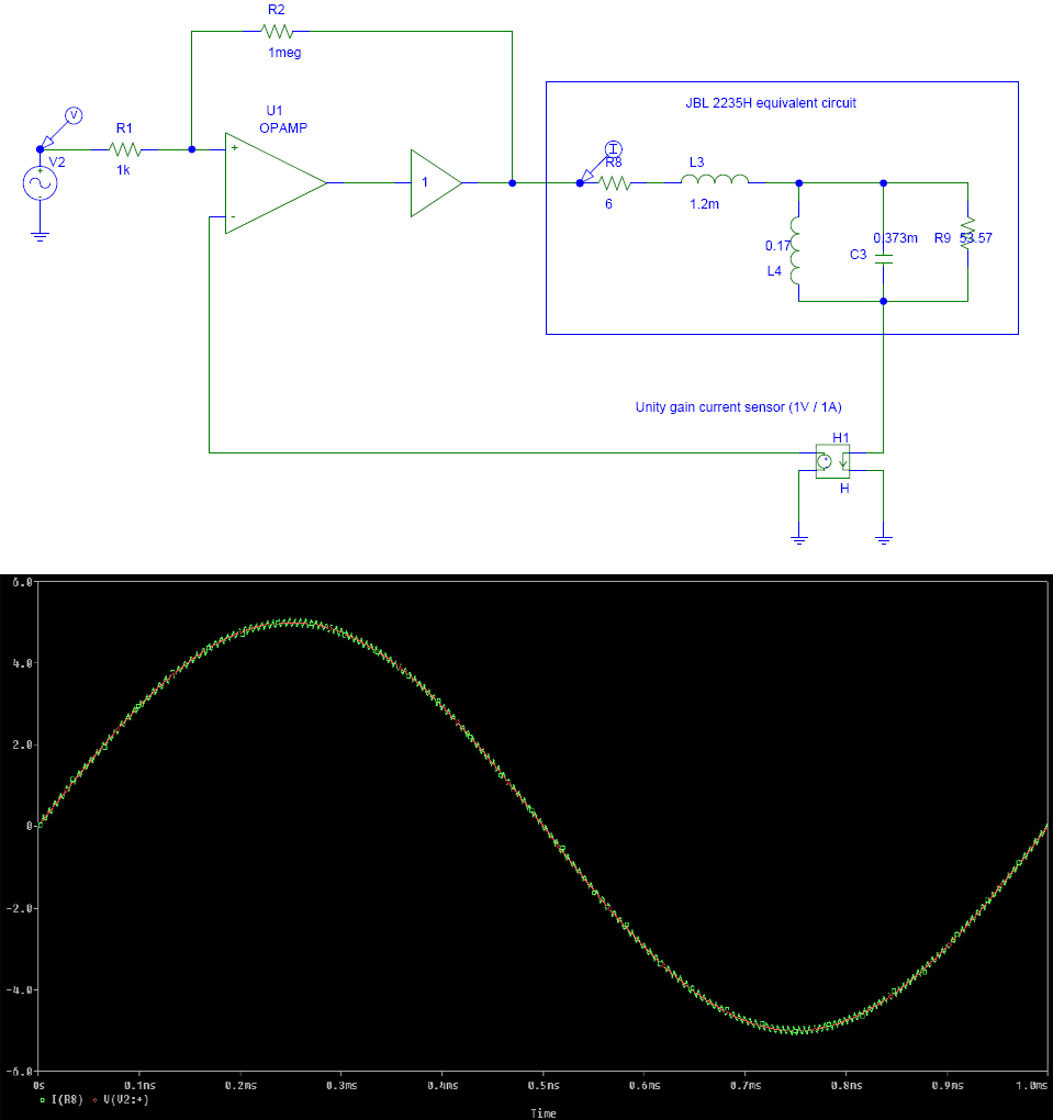

Well, here's some help. A simple simulation using hysteresis switching, unconditionally stable all the way. The opamp has a voltage swing capability of +/-100V. The current pushed is 5A peak. Simulation step time is 100ns. Enjoy !....I have to get off my beach bum *** to re-learn LTspice ....![]()

Have you built this beast?Well, here's some help. A simple simulation using hysteresis switching, unconditionally stable all the way. The opamp has a voltage swing capability of +/-100V. The current pushed is 5A peak. Simulation step time is 100ns. Enjoy !
If not, can you post the LTspice ASC file with all the device models please?
There's loadsa stuff which looks good in theory but getting something to work in real life is often (always?) a MUCH longer process.
I've been trying, on and off, for a Current Drive amp over at least 4 decades and not come up with anything that I consider good & easy to build.

I haven't built it but it should work, as the technique (called hysteretic current control in textbooks) is already being used in many SMPSes and motor drive systems. Although I don't use LTSpice, all my parts are generic and are therefore easily available within any of the SPICE(s) that exist.Have you built this beast?.... There's loadsa stuff which looks good in theory but getting something to work in real life is often (always?) a MUCH longer process. If not, can you post the LTspice ASC file with all the device models please?
Well, that makes you an old timer with very strong fundamentals and significant experience, which is usually a good advantage while trying something new.
