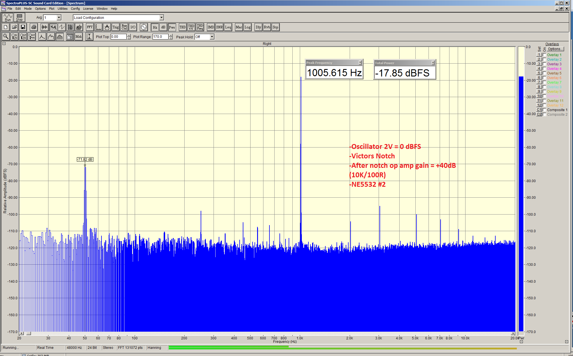

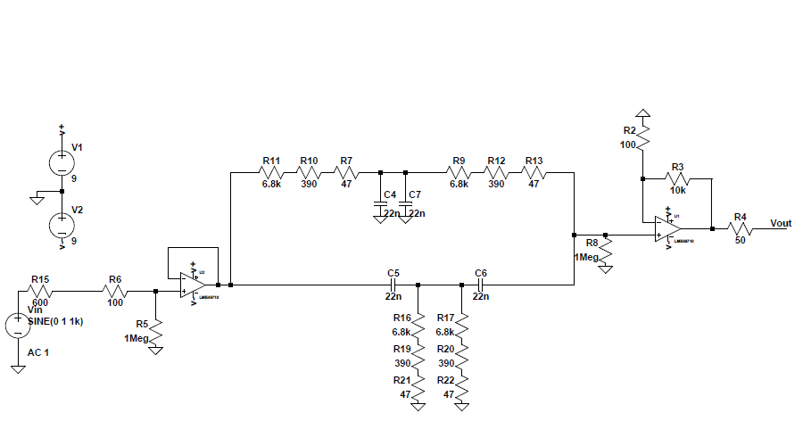

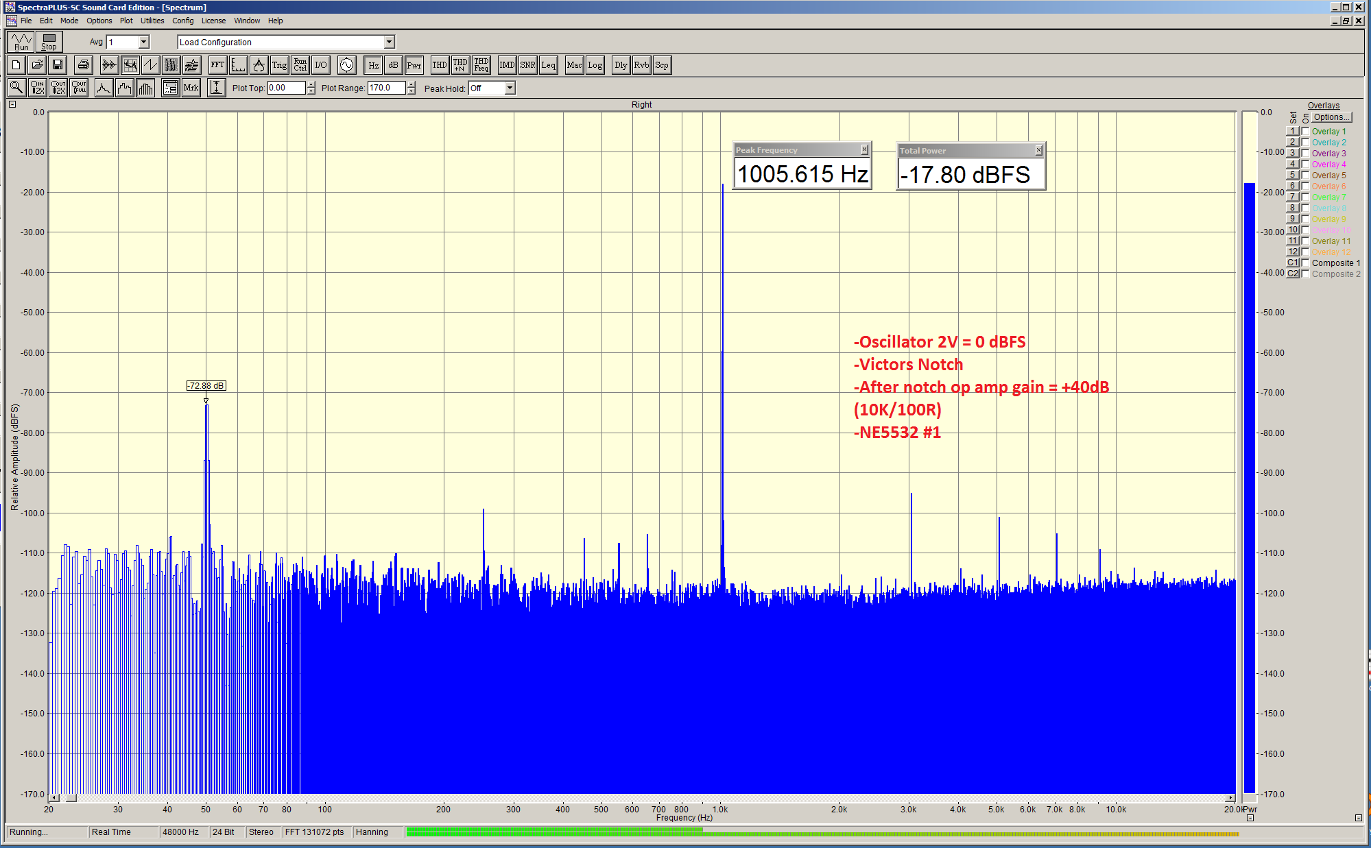

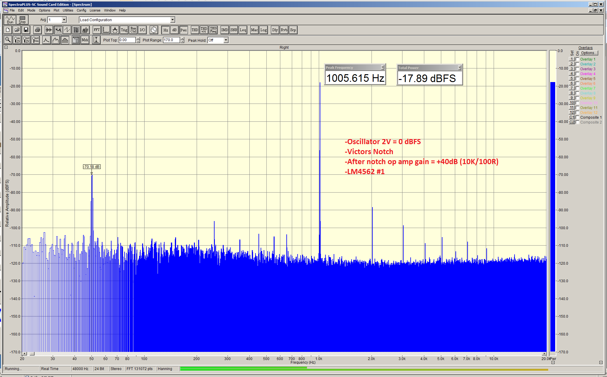

I replaced the op amp after the notch filter with other types and got unexpected results. The THD results with LM4562 are consistent but unexpectedly high. The NE5532 is not bad and has relatively little distortion. Probably because it copes well with a gain of + 40dB.

Ralf, the differences are relatively minor, and I agree with you that we should expect better, for both opamps.
That suggests that something else dominates the distortion.
What power supply did you use, and what type of resistors? Is your source better than the ~-120dB implied in your measurement?
Once you get below -100dB, every electron counts! ;-)
Interesting is that you get high only 2nd when LM4562 is used, but higher harmonics are lower than in the case of NE5532. Also the 2nd has different level in each example of NE5532 measurement. Needs to remember, that the second harmonic may be compensated when devices in the measurement chain have similar residual levels of them, but the phases are in opposite.
Probably if you can try the OPA1656, you may get the truth :)

The post notch opamp's input C modulation with level will dominate its distortion. There are opamps that are much better for this specific issue. TI has an app note discussing it. Still, a discrete cascoded FET input would be the best and that becomes a forest of parts.
Post notch signal is relatively low.
Passive twin T notch has capacitive and low output impedance at high frequencies (when the source has also low impedance).
