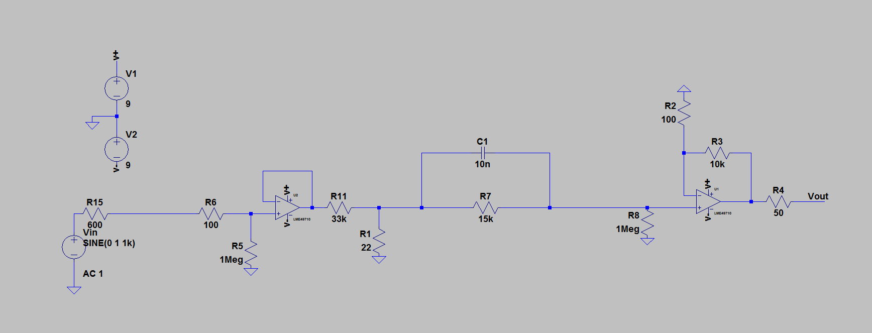

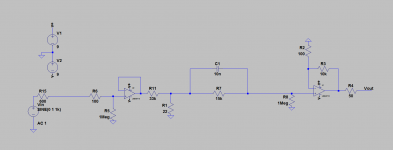

NE5532 is interesting in fact that it differs from others more "usual" OA that it doesn't like simmetrical impedances at it's inputs (in non-invert).
For others OA simmetrical impedances usually lower distortions (4562, 49860 etc).
Thats why 5532 is better as second OA (with non-simmetrical impedances) in last circuit.

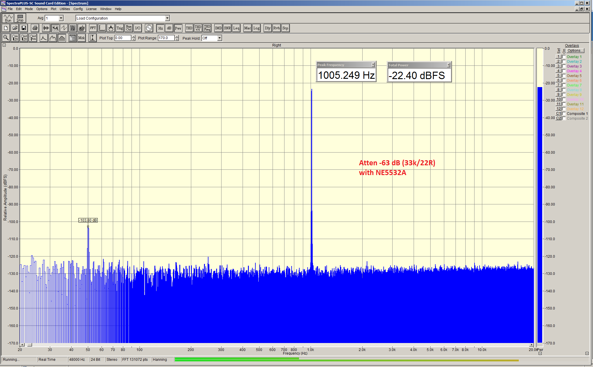

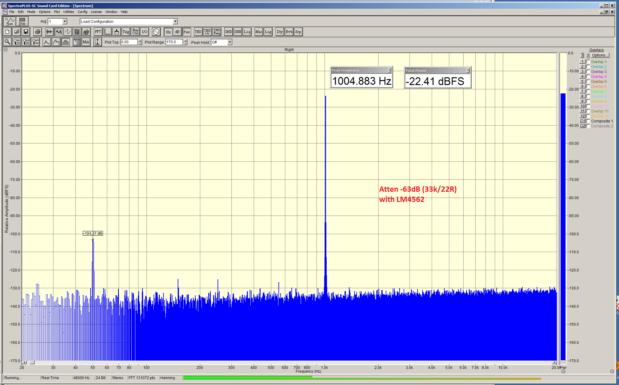

Ok. First you can test, how the opamp runs without the notch. You can use the metal film resistors divider at the input of the opamp. The signal level at the divider output must be the same as you have after the notch.
voilá!

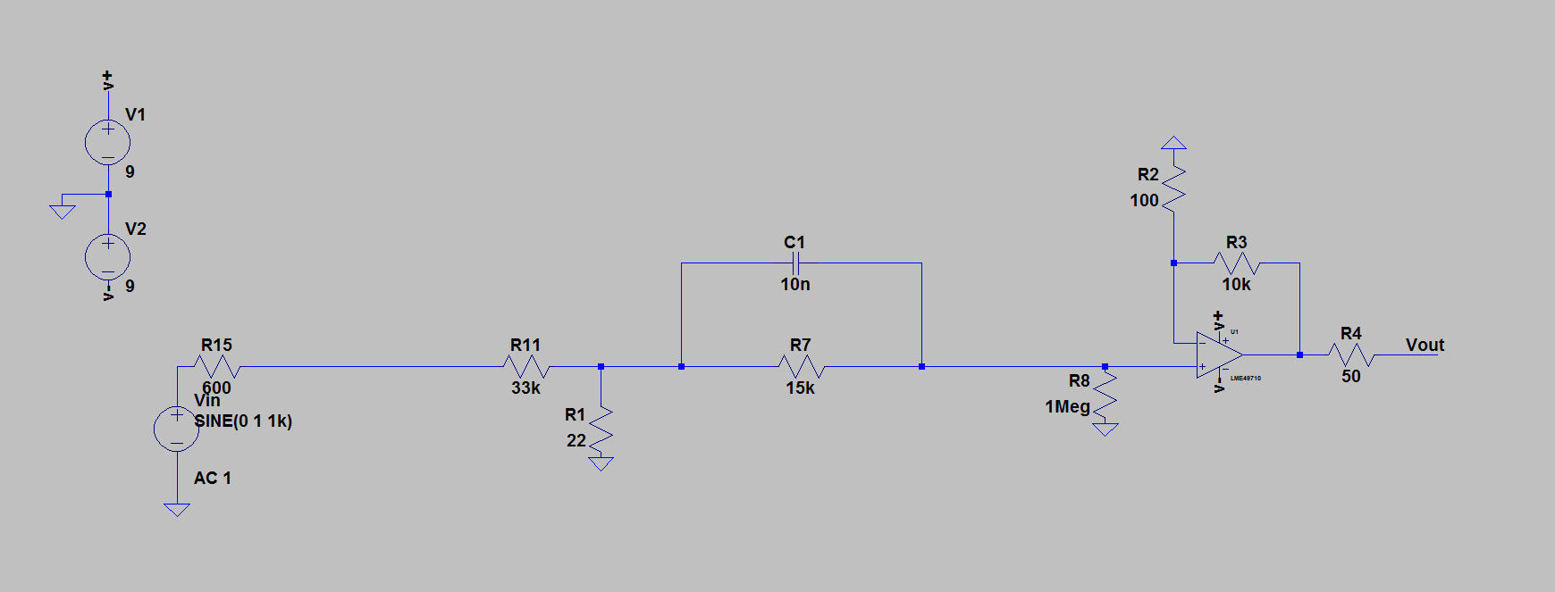

Post notch signal is relatively low.
Passive twin T notch has capacitive and low output impedance at high frequencies (when the source has also low impedance).
Here is where the problem arises- You need to figure the capacitance change vs level (say 1 pF for simple calculation) in ratio to the source impedance. If the source is 1K Ohms at 1 KHz 1 pF is 159154943 Ohms then the ratio is 159154 or -104 dB. .1 pF would be 124 dB. When you are at -160 dB it takes very little to compromise the performance. But with the 40 dB of gain it could still be significant. All semiconductor materials show a C/V modulation. You need to figure that into the design.
If I properly understand, we are talking about the opamp after the notch? The signal level after the notch is little higher than 2mV in this case (if the 40dB amplification gets app -18dB when the 0dBFS is 2V). So, the opamp input capacitance changes must be negligible.
