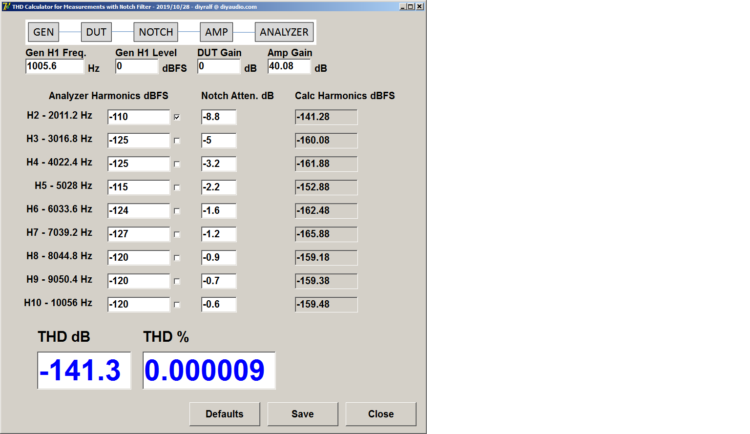

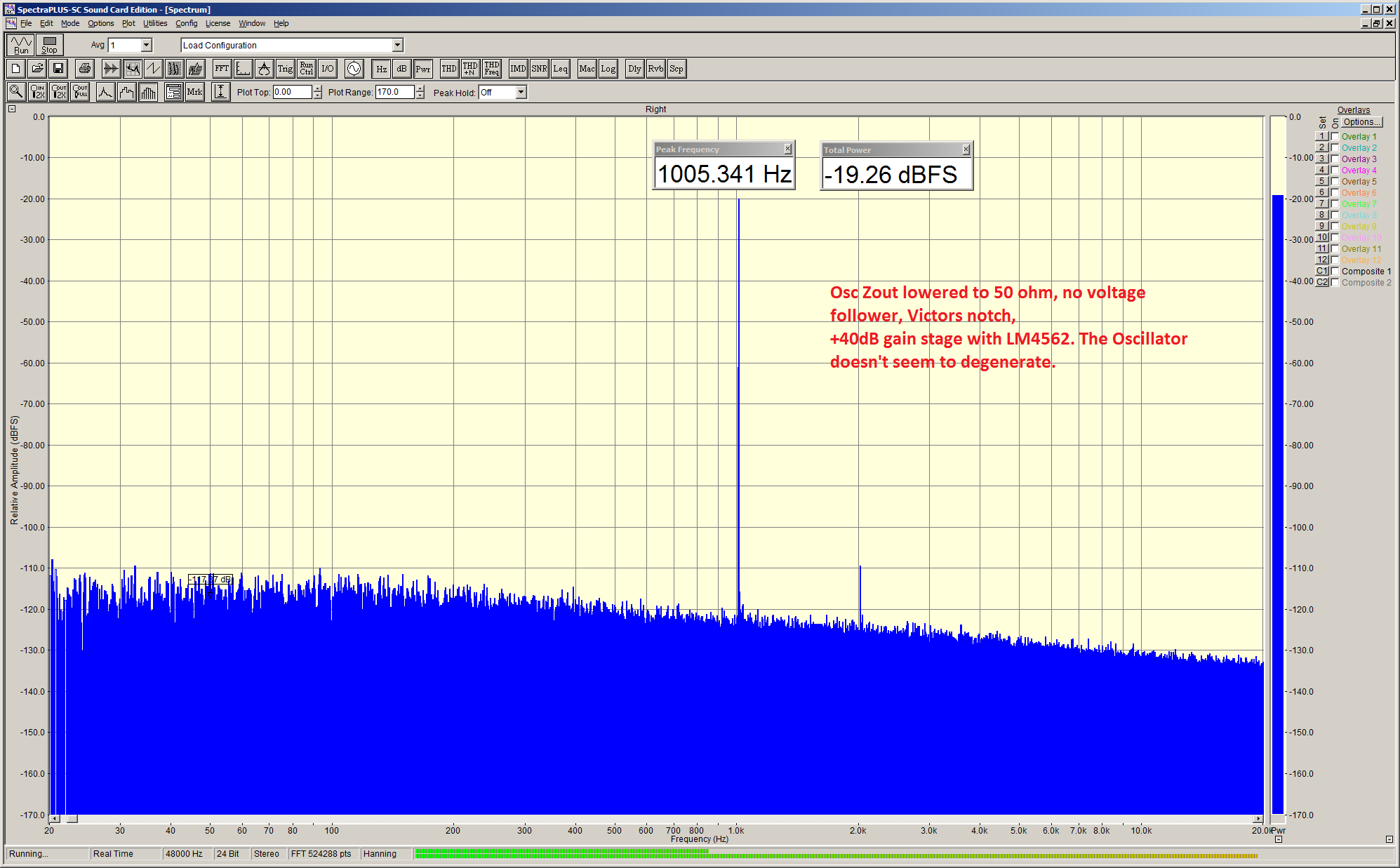

Since the line level follower problem is interesting, I made the same setup and got the results.
Also first about the post notch amplifier. Here are measurements without the input follower. 2V RMS at the passive notch input, and the same 40dB post notch amplification:
NE5532:
https://content23-foto.inbox.lv/albums/v/viccc/FollBuf/NE5532noB.jpg
LM4562:
https://content23-foto.inbox.lv/albums/v/viccc/FollBuf/LM4562noB.jpg
OPA2134:
https://content23-foto.inbox.lv/albums/v/viccc/FollBuf/OPA2134noB.jpg
So, the difference is negligible and no distortions are visible.
Now measurements with the follower before the notch.
NE5532:
https://content23-foto.inbox.lv/albums/v/viccc/FollBuf/NE5532.jpg
LM4562:
https://content23-foto.inbox.lv/albums/v/viccc/FollBuf/LM4562.jpg
OPA2134:
https://content23-foto.inbox.lv/albums/v/viccc/FollBuf/OPA2134.jpg
So, the LM4562 is not the best choice for high level signal non inverted follower, but the NE5532 is good in this place, but also is not good enough for ULD measurements.
Also I made the same measurements with the separate post notch buffer and got the similar results. Probably the crosstalk is not the problem.

The whole party is meant to measure other DUTs and not just the oscillator and a coax cable. Therfore Zin>>Zout.
You need to know what comes out of the DUT. For that you don't have to know its Zout. Zin>>Zout is not necessary for the measurement.
Distortion = fundamental out of the DUT/harmonics out of the DUT.
