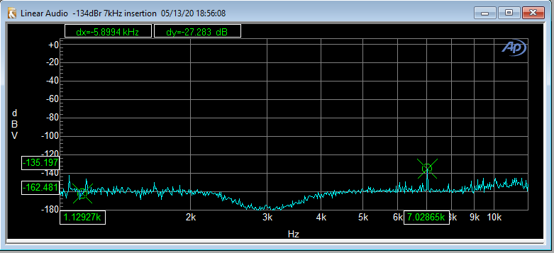

OK, I inserted a 7kHz signal from another oscillator into the 100R output of the Vic oscillator, as follows.
Vrms = 4V, output through the 40dB osc attenuator, then through an external 60dB attenuator, then attenuation from this attenuator (1k) to the osc 100R is another 20dB. Total attenuation 120dB.
Output voltage 4V and AP ref at -2dBV is another 14dB, total -134dBr.
What I see is slightly more, -135.2dBr. There is more noise and junk because now an external unit, mains powered, is connected.
But it seems close enough for government work.

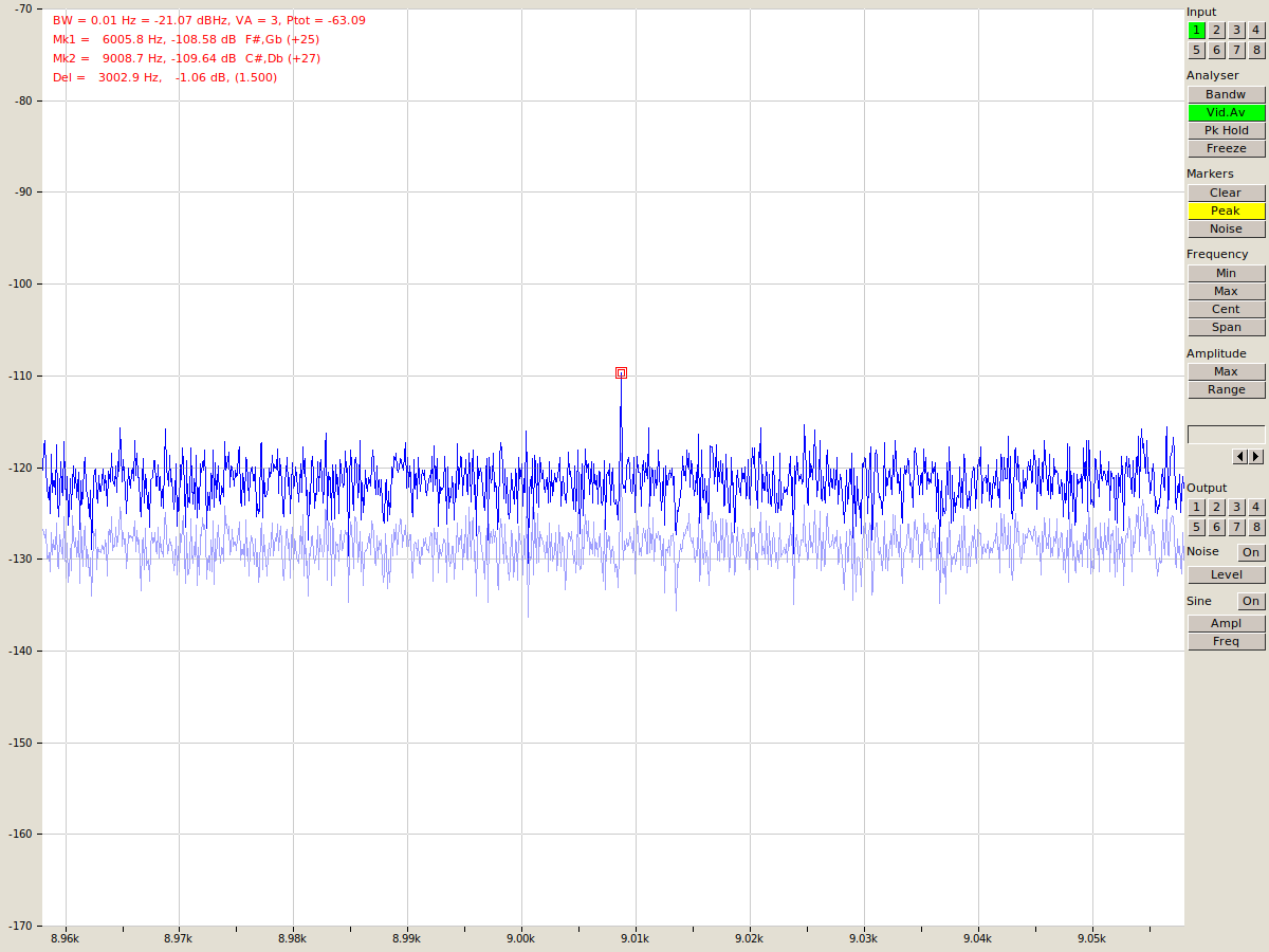

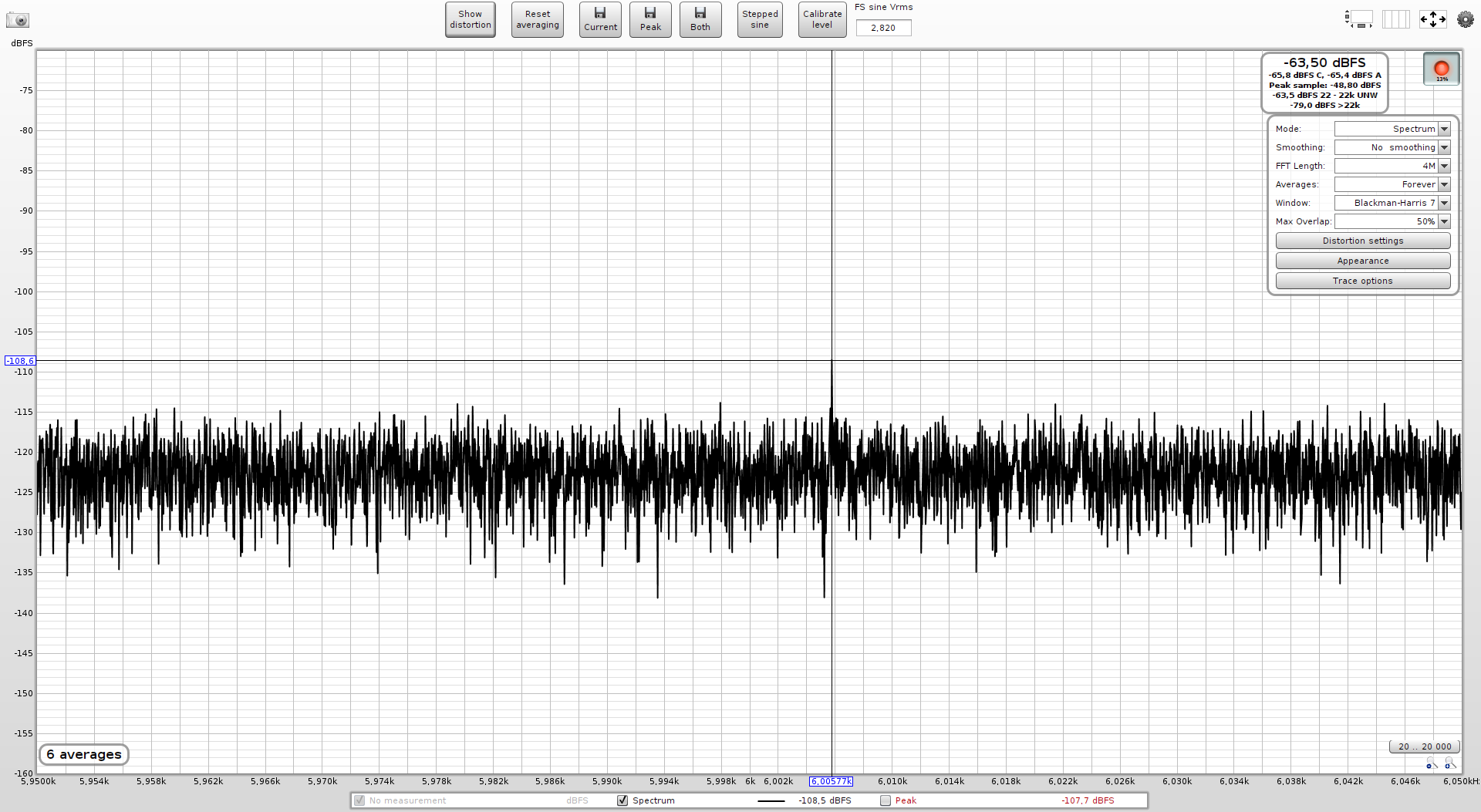

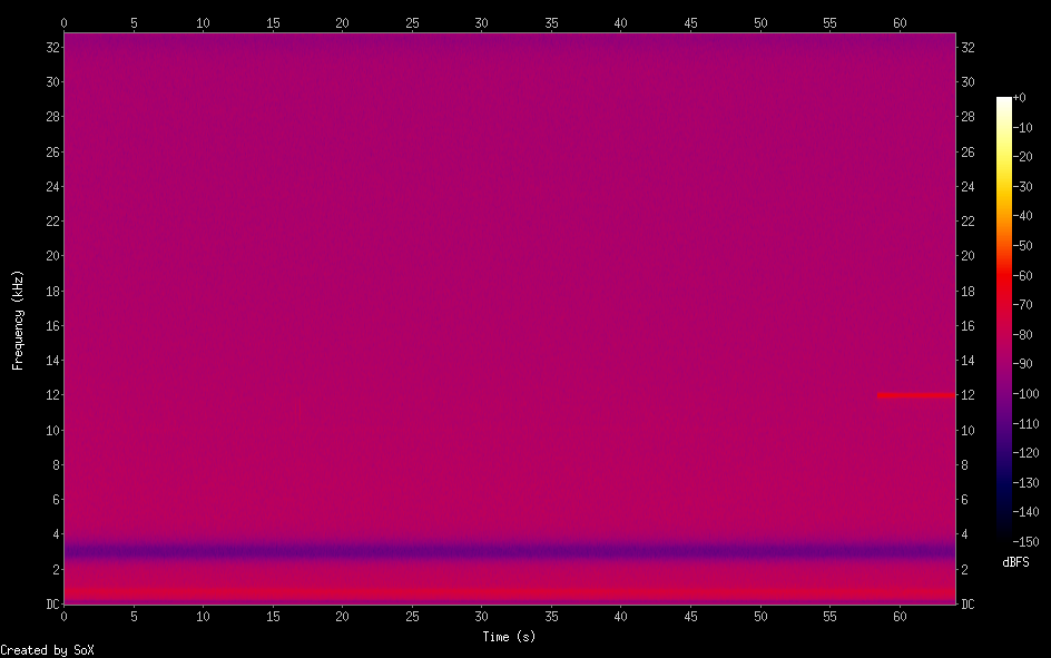

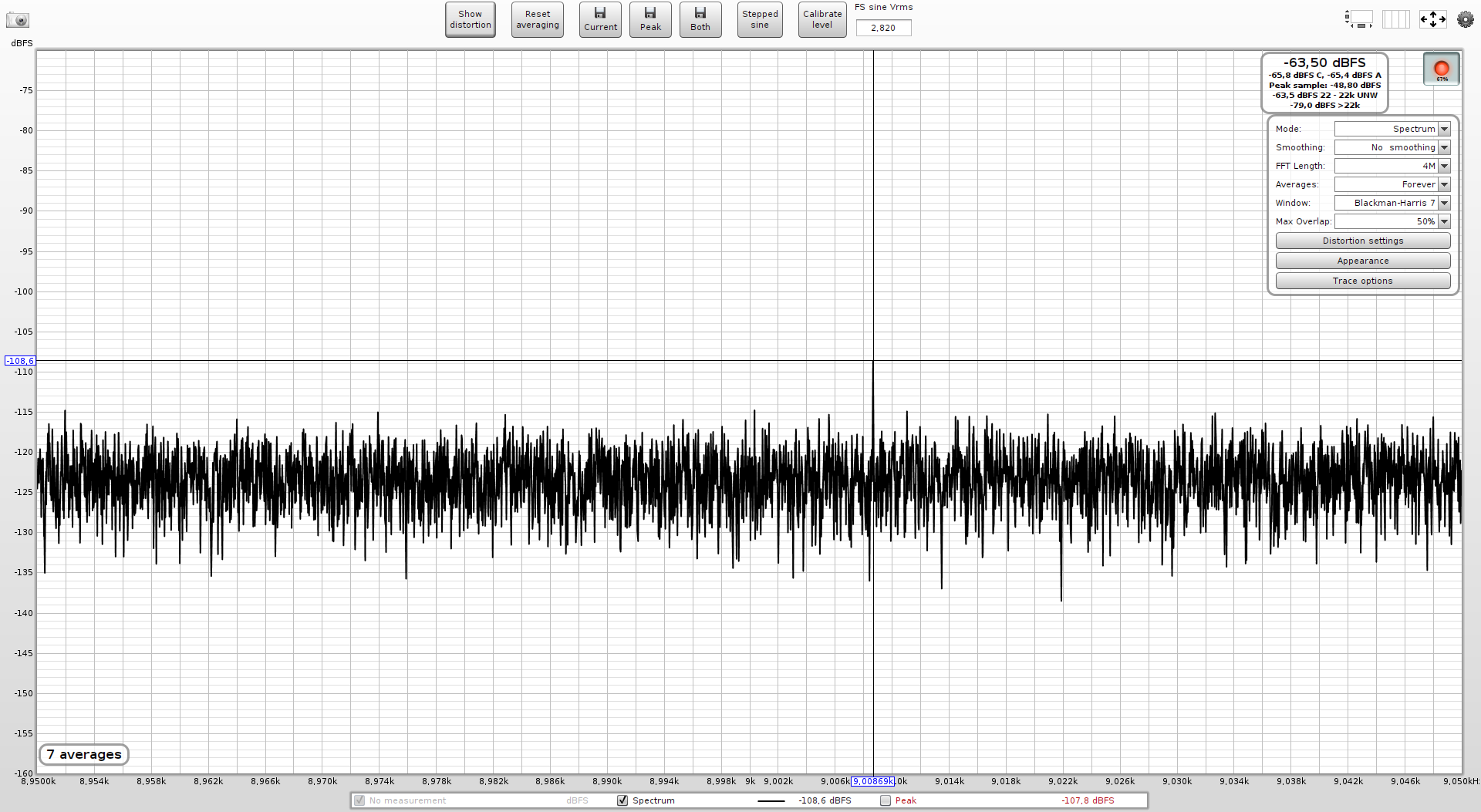

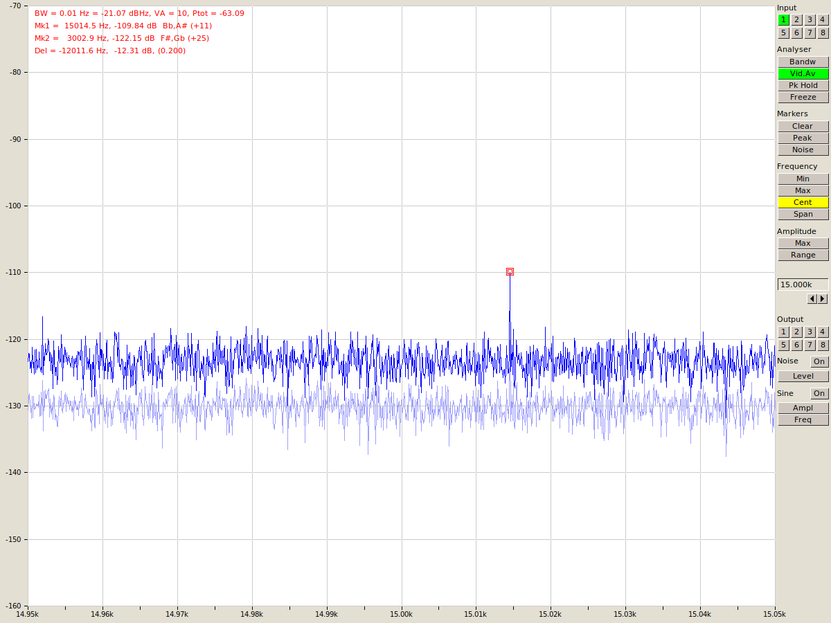

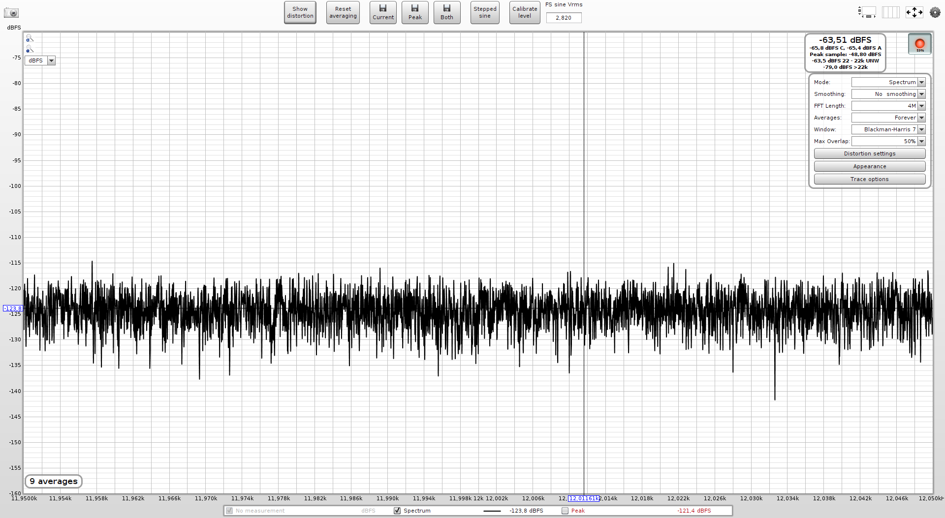

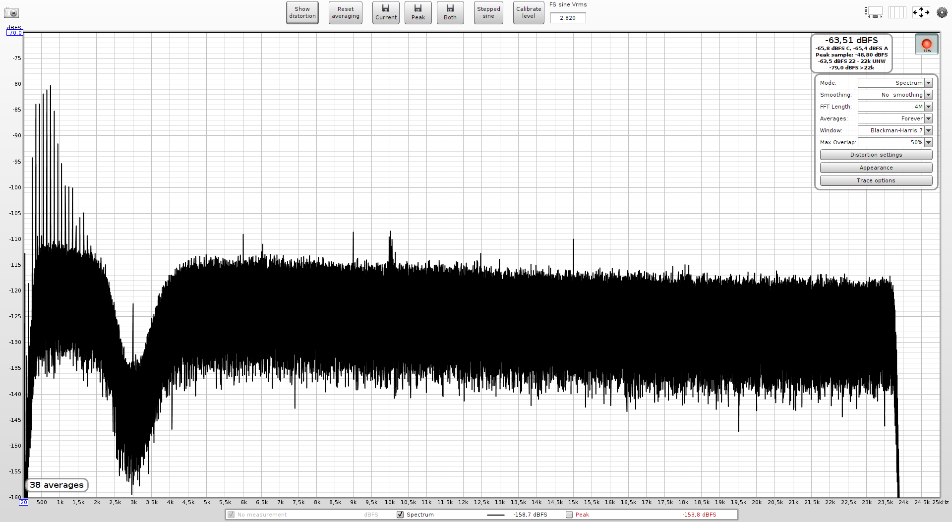

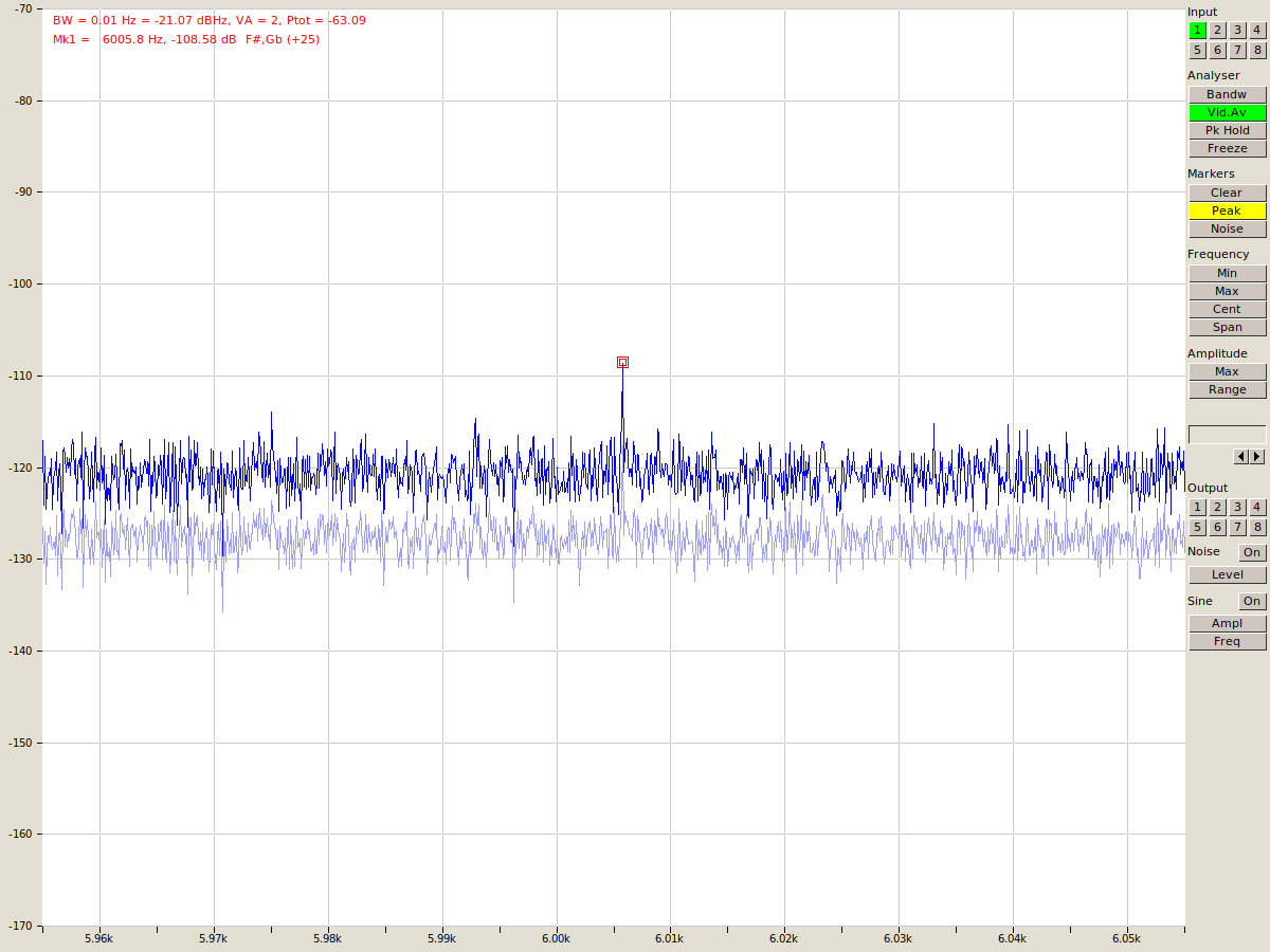

Jan sent me a recording from his AP. 4M samples - exactly:
The fundamental frequency was identified as 3002.9Hz (later on from the spectrum)
This is spectrogram of the recording
Some 12kHz noise made it to the end of the recording - will have to be removed.

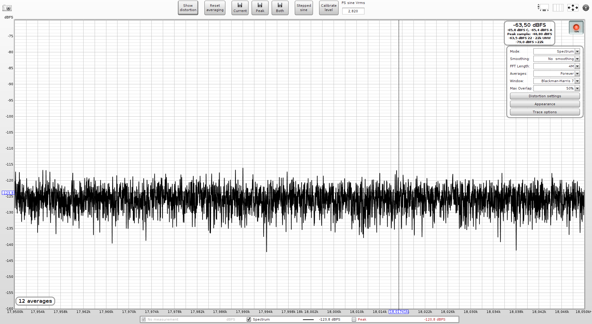

The linux analyzer jaaa supports any samplerate and a simple modification adds 4M, 8M FFT.
John Mulcahy has recently added 2M and 4M options to linux build of his REW https://www.diyaudio.com/forums/equ...t-samplerates-sw-analyzers-2.html#post6175436 . But REW by default does not support 65536Hz samplerate and java uses the plug plugin in linux - the stream would be resampled automatically to 48kHz. I resampled the wav in sox, using the best quality resampler (rate -v -s 48000). The spectrum in the waterfall visually did not change, but the harmonics were not visible in the spectrum anyway.
Now we have only about 55 secs of usable samples, but single 4M FFT takes 83 secs at 48kHz and 8M 128 secs at 65,536Hz. The wavs must be merged exactly at period boundary of analyzed signal, otherwise the signal will contain a discontinuity which ruins FFT.
A simple octave code found that
1966080 samples@65,536Hz samplerate contain exactly 90,087 periods of 3,002.9Hz
480000 samples@48000Hz samplerate contain exactly 30,029 periods of 3,002.9Hz
Thus the two wavs were truncated at multiples of this samples number which fell close to 55 secs to keep maximum of really measured samples
These wavs both contain exact number of periods of the signal and can be repeated any number of times without any signal discontinuity. Looping them to make 50 minutes of continuous signal was trivial with sox and a simple bash loop.

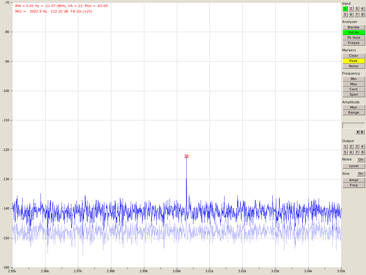

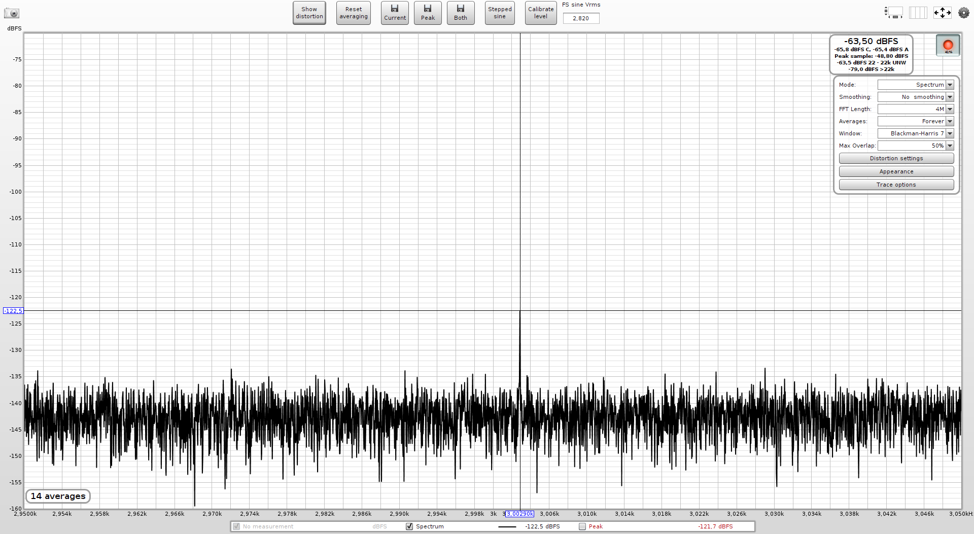

Spectrum in jaaa (65,536Hz, 8M FFT):
Spectrum in REW (resampled to 48kHz, 4M FFT):

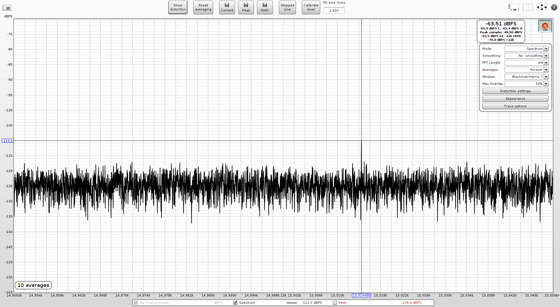

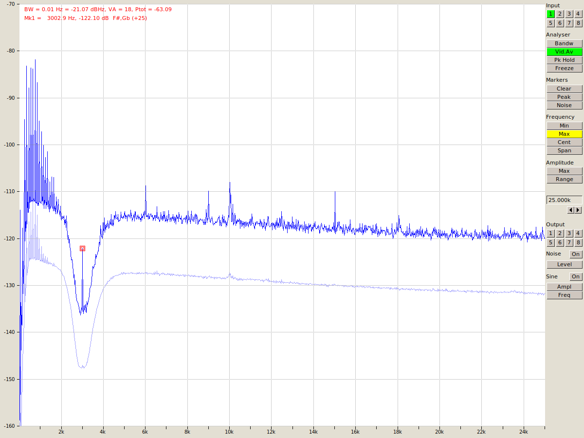

So Pavel, what does this tell us? Does this have to be corrected for the twin-tee attenuation?
Edit: BTW I sometimes see that 12kHz (I thought it was closer to 10kHz). It comes and goes, no idea what the source is.
Jan
Jan
The charts are spectra from the wav you recorded. Any changes made prior to the recording (notch filters effects on the harmonics, the gain stage) must be accounted for manually. This is what you would see on your AP if it did not subtract the gain stage (just a Y axis shift) and its FFT was long enough.
IMO the spectra clearly show :
1) the harmonics are where expected, the measurement technique has not eliminated them - good
2) The oscillator frequency is very stable and precise (the 8M FFT has resolution of 0.008Hz), at least for the 50/57 seconds of the recording I used (the 36minutes of 18 averages of 8M FFT were built from the single 57 secs sequence).

Pavel for some reason your images don't open (for me at least).
Jan
It's how many secs of samples at the given samplerate must be accumulated to reach the FFT length. The actual FFT calculation takes millisecs with libfftw.
Jan
I see them all (including in your quote 🙂 ) on a different machine, they are standard PNGs.
I linked the image attachments directly in the post, hoping the forum would scale them. They are too big for the post text, I will resend them as regular attachments which show just as thumbnails.
Unfortunately I cannot edit anymore, 30 mins have expired...
Sadly, I'm with Jan and cannot see the additional images.
