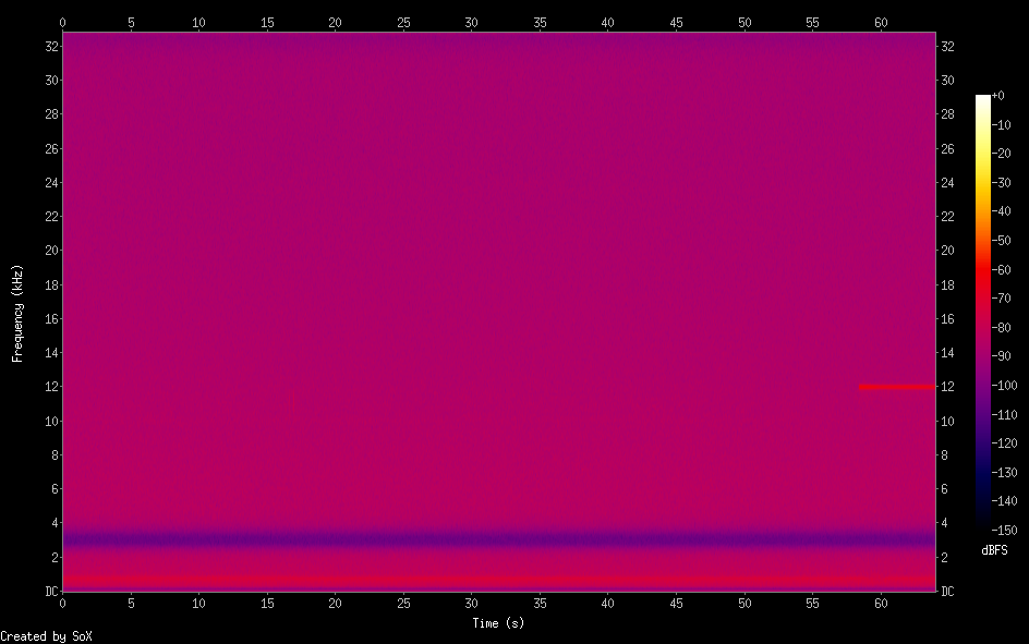

Pavel what I don't get is how you end up with 55secs of signal when I recorded 83.xx seconds (4M @ 48k).
Jan
Look at the orig.wav details at https://www.diyaudio.com/forums/equ...n-audio-range-oscillator-900.html#post6203741
Code:
soxi orig.wav
Input File     : 'orig.wav'
Channels       : 1
Sample Rate    : 65536
Precision      : 24-bit
Duration       : 00:01:04.00 = 4194301 samples ~ 4800 CDDA sectors
File Size      : 12.6M
Bit Rate       : 1.57M
Sample Encoding: 24-bit Signed Integer PCM
The wav contained incomplete 4M samples (4M = 2^22 = 4194304, the wav has only 4194301 samples) at samplerate 65,536Hz (not 48kHz). That is 64 seconds. The wav spectrum shows the 12kHz noise starts at about 58 secs which I had to trim.

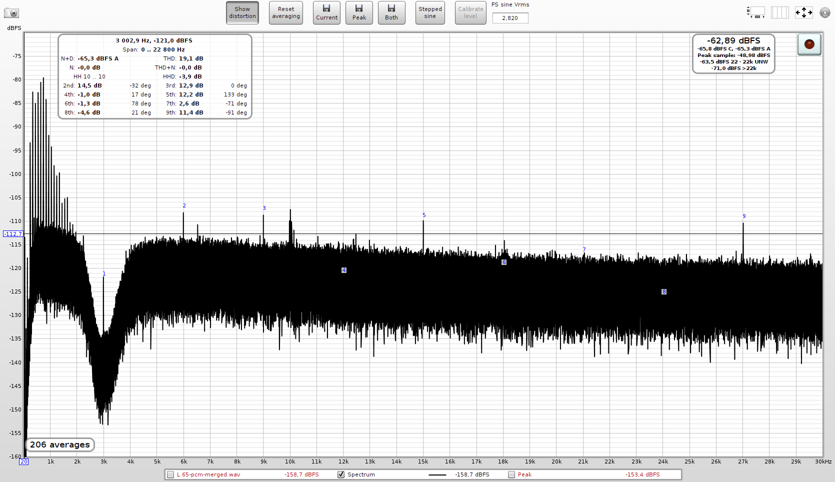

Here is spectrum for 4M FFT 206 averages of 110 minutes of the original 65,536Hz signal (no resampling to 48kHz), all the distortions properly marked and described (their level is dB against the fundamental, therefore positive numbers). Calculating took a few minutes with 2 full CPU cores running.
The significant 9th harmonic(27,026.1Hz) is interesting, my previous jaaa spectrum range was only to 25kHz and the 48kHz resampled signal in REW did not reach so high.

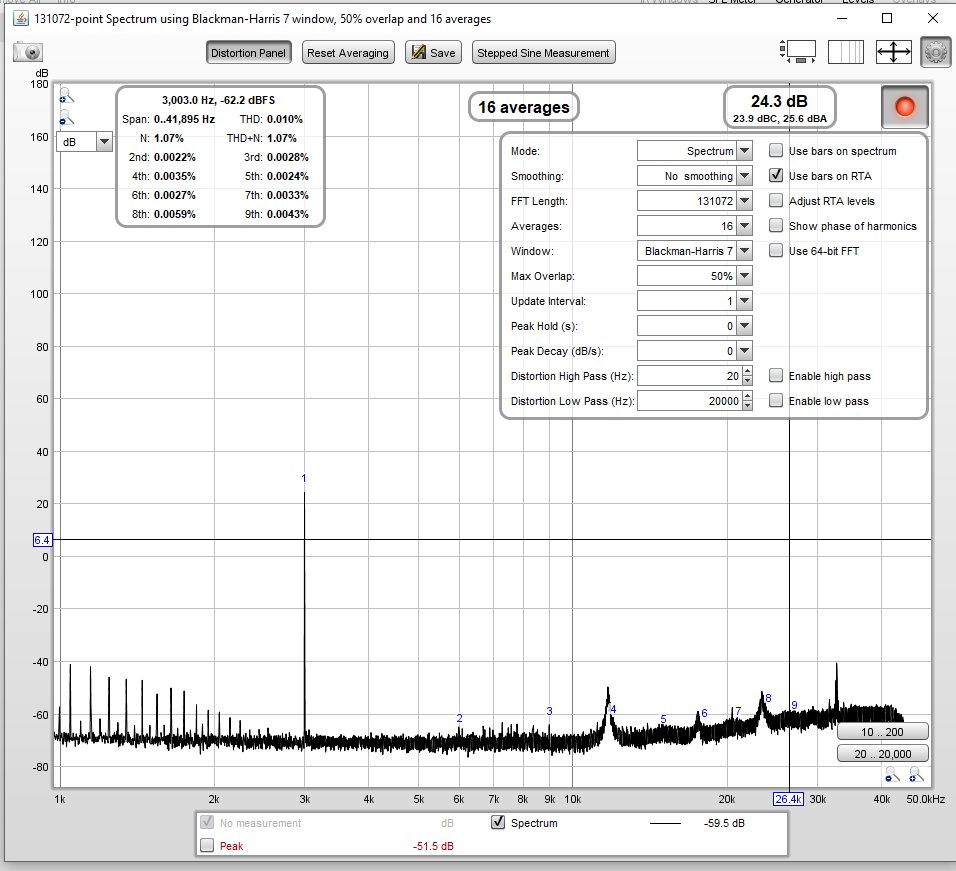

The attached is with 2.7V output, anything lower and all harmonics drown in the noise again.
But I have no idea how much it really is. The RTX generator is set at -10dBFS which I believe is the reference used to set the fundamental in the graph at 0dB. The signal level was 2.7V, the twin-tee attenuates the fund. by 60dB and the 3rd by 64dB.
The 3rd in the graph is around -88dB.
Anyone can do the sums? I wish I could set the reference for the display manually in REW. Although I start to like REW a lot.

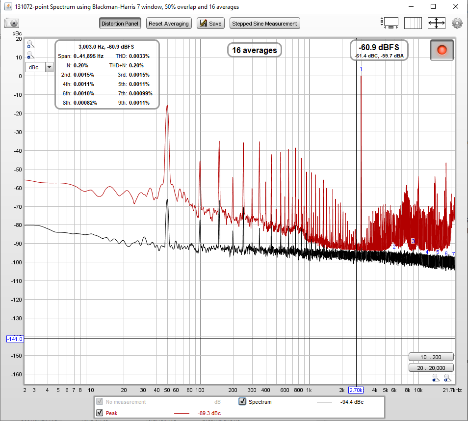

Or maybe this is the correct calculation.
If I enable the display of the fundamental (red stuff), the bottom legend has it as -89.3dBc, and that apparently is the 0dB ref (the red line is exactly at 0dB).
The 3rd I see is 88dB below that. Would it be correct that the 3rd is thus at 89.3 + 88 - 4 (t-t atten) = -173.3 dB below fundamental? We do know it is below -150 dB.
Jan
I would recommend to switch the distortion table to dB - in the RTA settings (top right corner icon)
The distortion levels are listed relative to the fundamental - look at the chart at https://www.diyaudio.com/forums/att...low-distortion-audio-range-oscillator-65k-png - the distortions are positive dBs because they are actually above the notch-filtered fundamental. Their dbFS value is fundamental value + distortion value: H2 = -121dBFs + 14.5dB = -106.5dBFs
REW does not know anything about real levels entering the ADC, it just processes the stream of numbers <-1, 1> produced by your ADC (after int -> float conversion, of course).

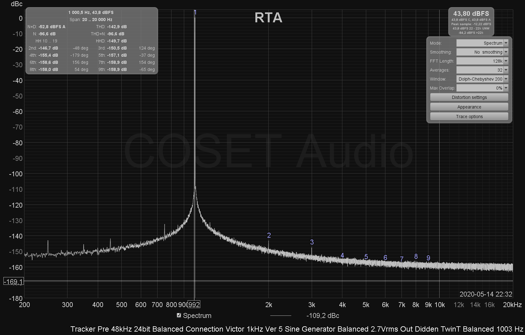

Ja, I think you should use the latest version, beta 50. I use that and it is stable. You might also want to use 64bit FFT.

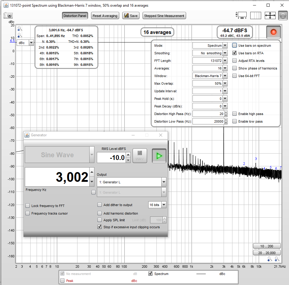

I did this VictorRev5-1kHz and your notch measurement in REW yesterday. You can see my settings in the image. 48kHz. 24bit. Tracker Pre.
Calibration file for notch used.
But how to interpret that?
Jan

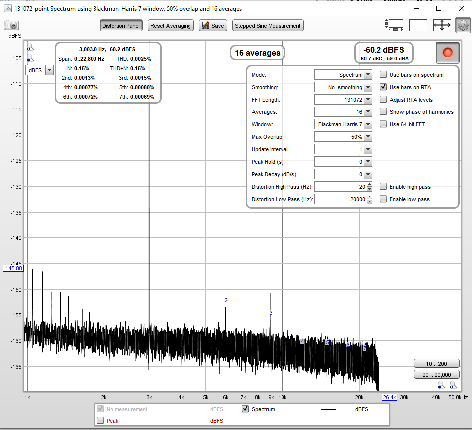

Anyway, remembered to set the sampling rate to lowest values for narrowest bins with lowest noise, set the scale to dBFS and got this, cleanest so far, and numbers that at least make sense.

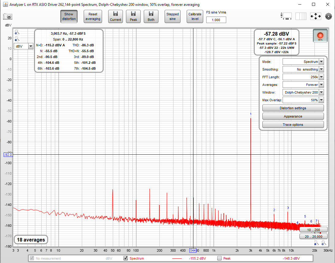

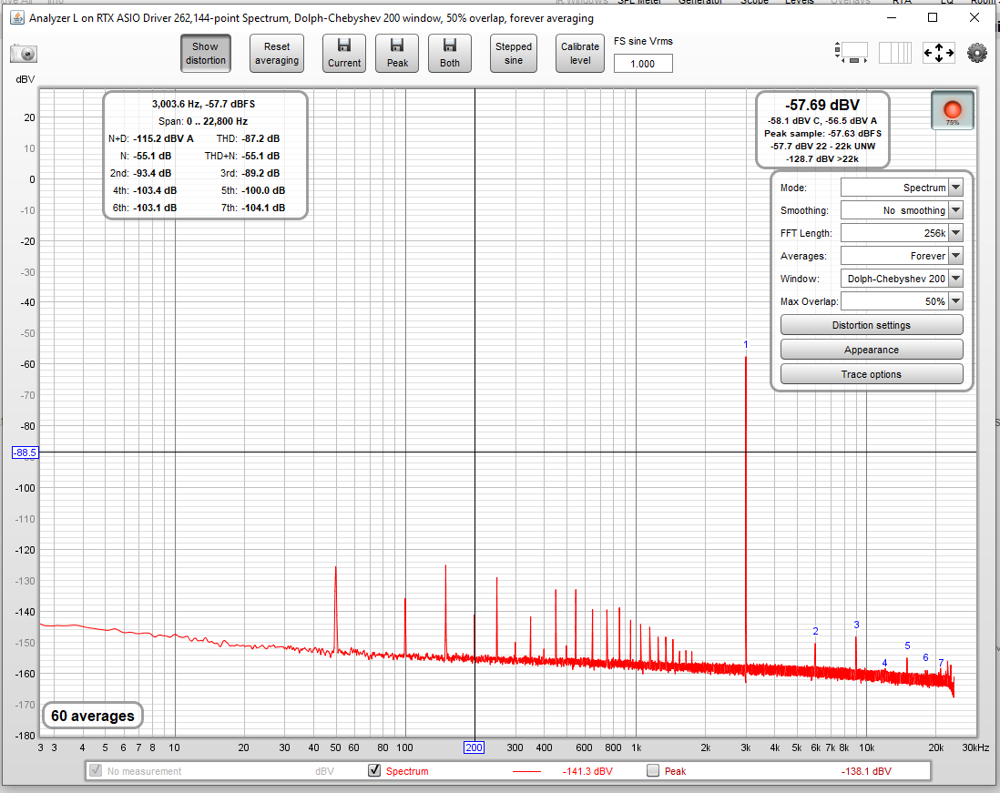

Last for today. Using the latest REW version with more windows and longer FFT (256k). Two plots, Vic @ 2V out and @ 2.7V out, which is close to the maximum.
Note that these graphs are referred to 0dBV so the graph with 2V is actually 6dB better, well below -156dB.
With the 2.7V higher output level it just starts to peak above -150dBV but needs a correction for the 2.7V output, which is about 8.5dB, so it is pretty much still the same as with 2V, better than -156dB.
I think the RTX just beat my AP ...
So, Viktor, this is where your harmonics are ;-)
