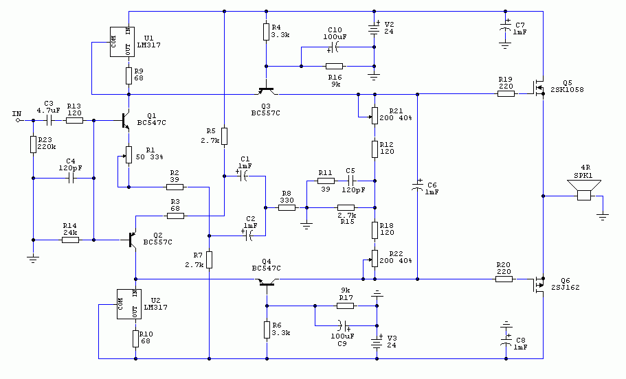

Today I tested Indra1's proposal (post #76) and finally there's an amp without feedback loop that satisfies me completely (no objections to sound at all). It drives the 4 Ohm, 3-way sealed boxes magnificently.
I set the bias (R21, R22) at about 1.2A (LatFET's Vgs of about 2V).
Of course, the input stage PSU voltage should be higher, to use the full power potential of output FETs, but this was enough for the scope of the test. I used small LM317L as CCS (they do a surprisingly good job at 19mA - most thermally stable one active component CCS that I know of). DC offset at speaker is OK (+/-2.5mV). Zout is acceptable - measured at 100Hz and 10kHz it's about 0.25R
After all the tests I've done with it, I think I'm in love with this gain stage - a pity that I can't use it with VFETs due to their small gm which results in high Zout without feedback loop.
Once again, thank you Mr. Pass for bringing this great topology back to life.

I'd like to try the schematic as per above as a headphone amp (load 50 Ohms), eventually with reduced supply (+/- 18v) and using 2SK2013/2SJ313 as output devices (driven at 100mA). Could you kindly elaborate the changes that are needed?
Are source resistors needed?
Guido
Guido, regarding the circuit in post #118 :
+/-18V for the gain stage is OK, just change R5 and R7 to 2k2. The max swing will be about 13V peak (A=9V/V) so there's no need to supply the output stage (k2013/j313) with more than +/-15V.
Before you turn it on, set the R21 and R22 to minimum resistance and short-circuit the input terminals. When you turn it on, first use the R1 to set the 0V across the R15 (R11 and C5 you can leave out if you experience no oscillations). After that, turn R21 and R22 to set the bias of the output stage and 0V at the output terminal. Do it incrementally and alternately, the same way as in F5. Let it heat up for an hour and readjust.
CCS (U1 and U2) should produce about 18mA - you can use small LM317L.
For use as a headphone amp put small source resistors on k2013/j313, about 1 Ohm.
If the gain is too high, make R15 = 1k5
Have fun !

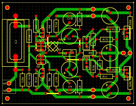

FYI: I have been working on a variant of the LSK-Pre. The initial version is described in the F4 thread: http://www.diyaudio.com/forums/pass-labs/97540-f4-power-amplifier-385.html#post3684975. I am now working on adapting the LSK-pre, initially without the output buffer, to provide 40V P-P output in order to drive an F4 to full output. This requires much higher rail voltages and power dissipation for some of the components. With luck, a PCB for the LSK-Pre will be usable for the result of my adaptation.
Juma, with reference to the schematic of your attached amp, would it be possible to (1) connect the Input Gnd and junction of R8, R11 & R15 to a "Clean Gnd" (10R//Antiparallel diodes) and (2) would it be sufficient to double the rail voltages and then use a series pass regulator for higher rails for the Input Stage? By Input Stage, am I correct in understanding that it includes the entire circuit barring the Output Mosfets and associated capacitors? Many thanks.

Since it's a push-pull design, you can bias it in accordance with your needs for power ie. PSU voltage and available heatsinking. LATFETs sound good from 0.5A bias upwards - the more the better but I wouldn't go over 35W of quiescent Pd per LATFET....It's Iq of 1.2Amps per device??
Dissipated power is a product of current and voltage applied to device....What is the dissipation per Latfet?
